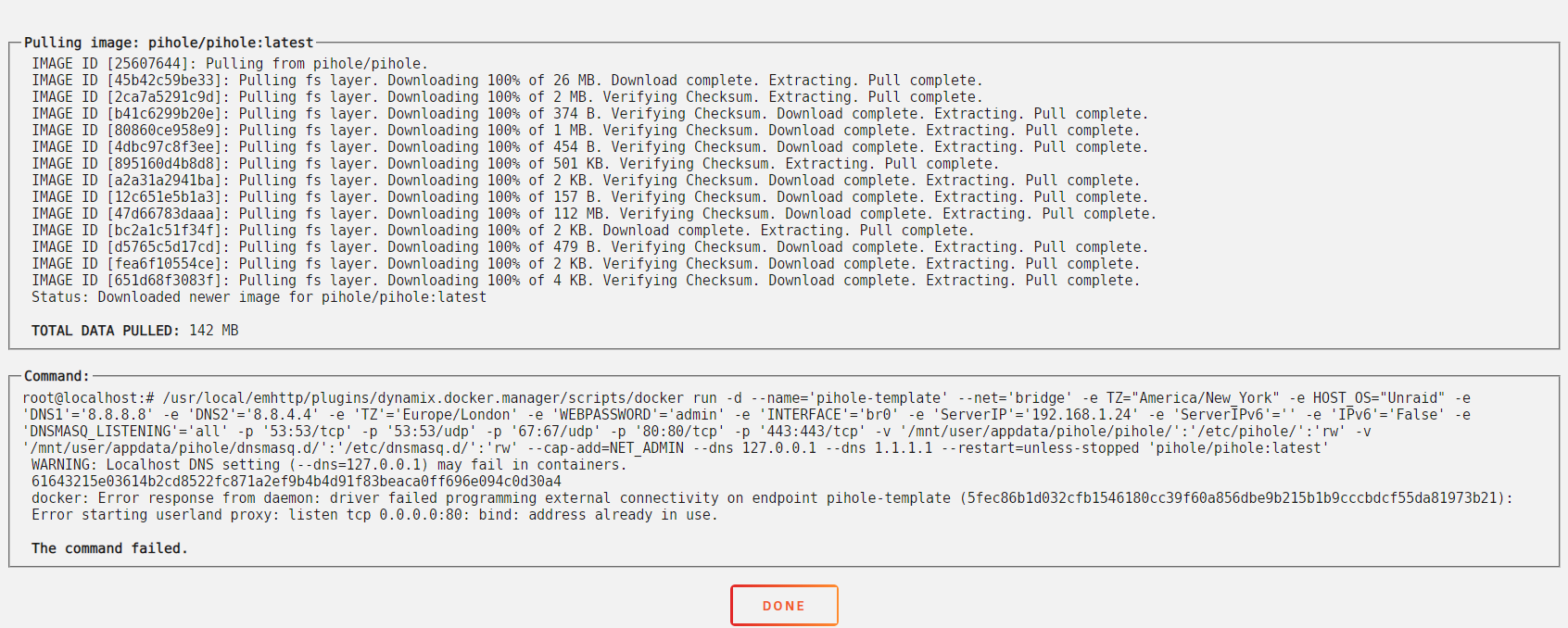

I had a quick question regarding network ports. I am in the process of setting up pihole and received an error message that the port 80 was already in use (error attached). None of my current dockers -all of which were OFF anyways contain that port assignment.

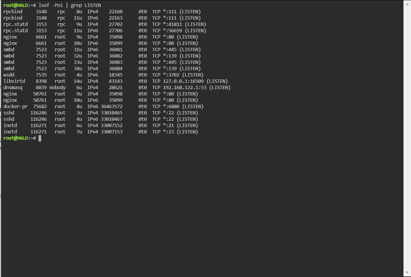

I did "lsof -Pni | grep LISTEN" in the terminal and it shows a "NGINX" "LISTEN" on port 80 (also attached).
Is this a standard UNRAID process? is there a way to remove "NGINX"? Is this Malicious process???

Unraid webgui will be on 80 and 443
Use a different port for pihole web access i.e. 8080
