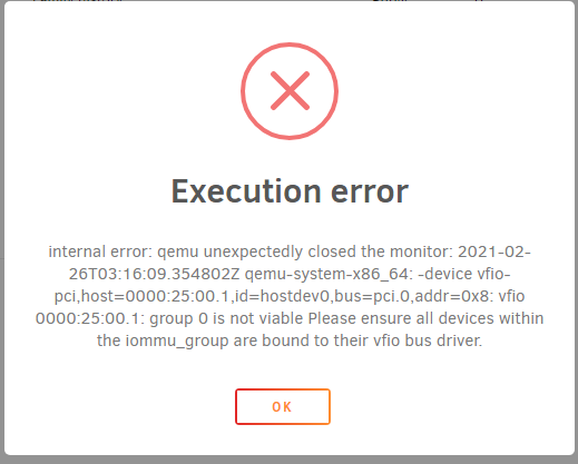

None of my Windows VMs work, I get the following pop-up.

After stubbing the network card and updating the VM config to use the new network card, this appear.
