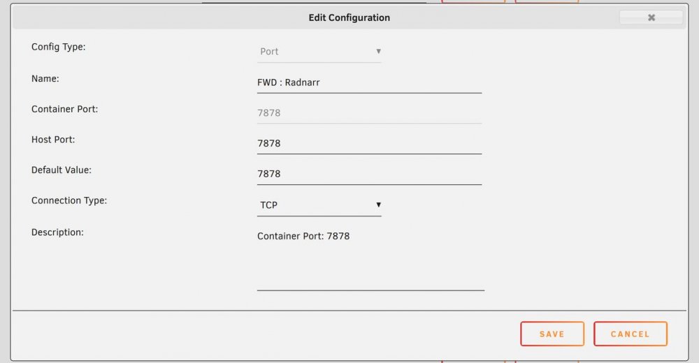

Here is a screen of Radarr's port forwarding on the qBitTorrent Docker....

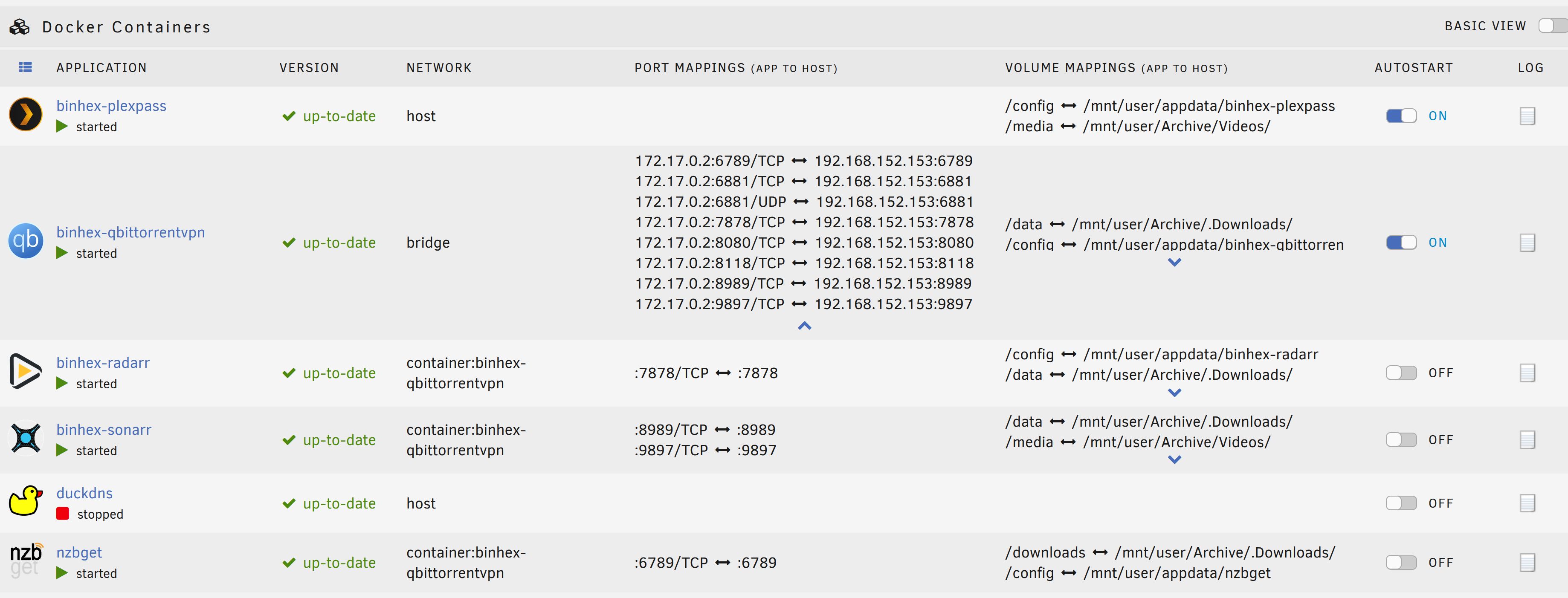

Here is a shot of the docks main page...
