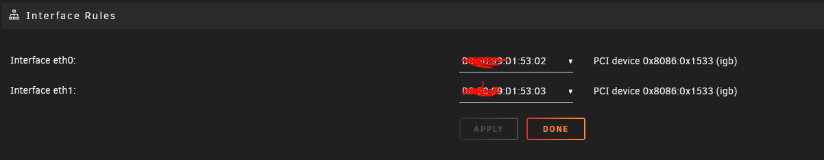

unRAID will always use eth0 (I assume that is your NIC 1).  If you want another interface assigned to eth0, change it in Network Settings by assigning desired MAC address to eth0.
And of course you have to stop Docker and VM Manager to make changes to interfaces such as DNS, IP addresses, etc.
Ok I'll take a look, but surely a bond of 4 nics is not one mac address?
Ok so I changed the bond to be eth0 and the server told me to reboot which I did. I booted in GUI mode and can see the interface from there. Dockers can now reach the internet.
But I cannot access the GUI from LAN :(
