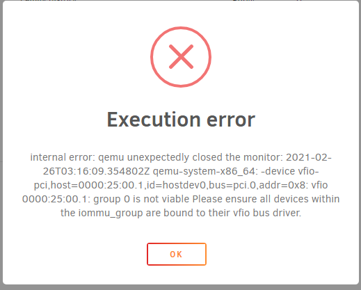

However, when I assign a network port to the VM, it does not start and gives me this issue.

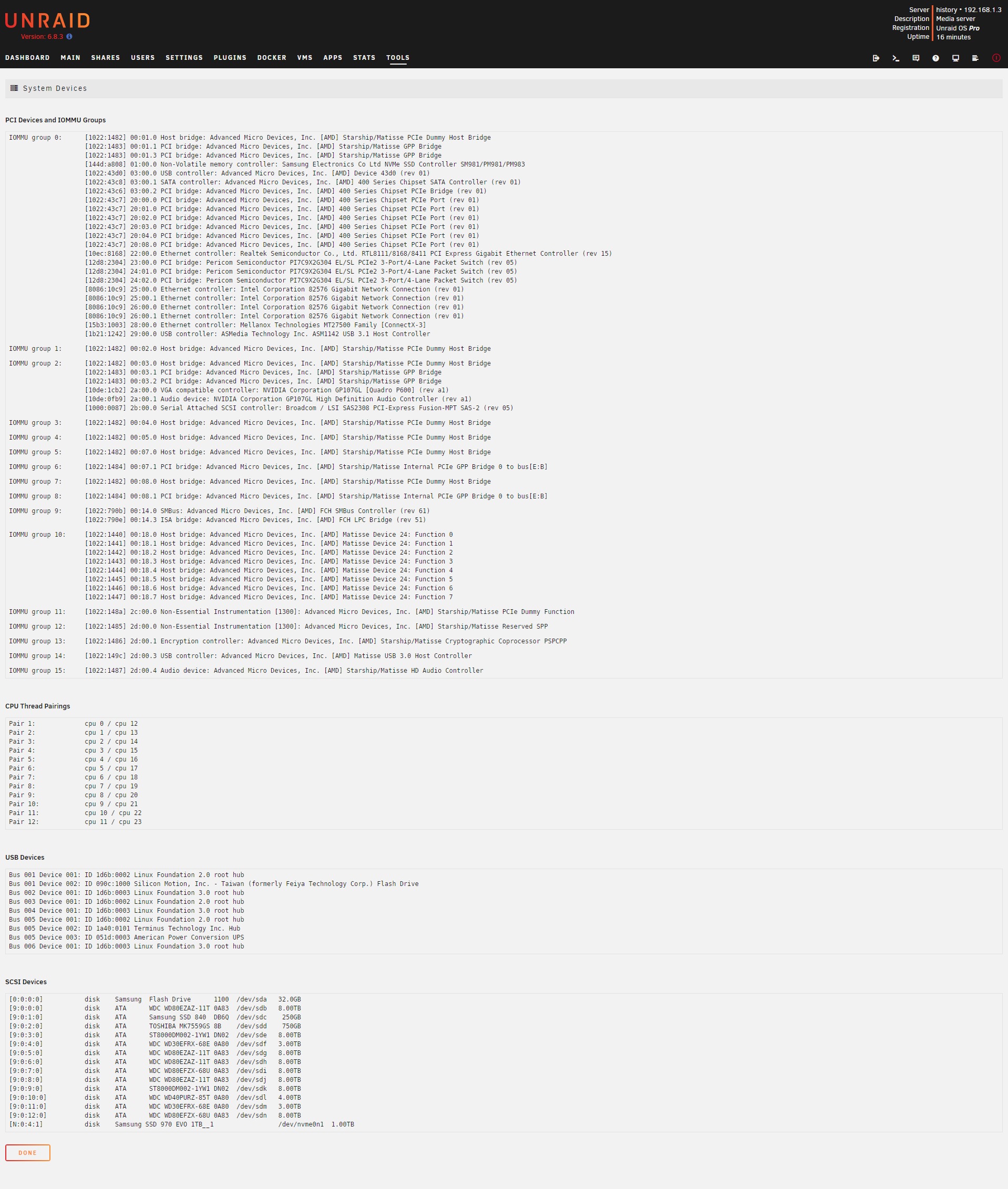

My assumption is you need to further split the IOMMU groups in regards to the quad network adapter, as shown in the picture, they are all responding with the same xxxx:xxxx pci identifier.

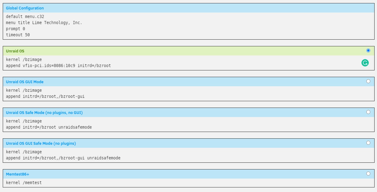

I see you tried to append the kernel, no luck im guessing?
I see one entry... shouldn't there be 4? One for each of the NICs on the card?

The cards is not in its own IOMMU Group so cannot be used.
You may need to look at the ACS Override in the VM settings or unsafe interrupts.

What both the thread or the video doesnt show is how to split a nic which has the same pcie ID across the 4 ports. In the devices, I can see 4 with their individual addresses
[8086:10c9] 25:00.0 Ethernet controller: Intel Corporation 82576 Gigabit Network Connection (rev 01)
[8086:10c9] 25:00.1 Ethernet controller: Intel Corporation 82576 Gigabit Network Connection (rev 01)
[8086:10c9] 26:00.0 Ethernet controller: Intel Corporation 82576 Gigabit Network Connection (rev 01)
[8086:10c9] 26:00.1 Ethernet controller: Intel Corporation 82576 Gigabit Network Connection (rev 01)
These 4 ports are what I want to see available in "other devices". I want to assign 1 port to each VM I am going to run.
I dont know what to put in the kernel to make these 4 ports isolated from unraid and available only to VMs.

I was finally able to do split out all the iommu groups and then isolate each port by doing what this post said:
This allowed me to then assign a port to a VM. Nothing else worked for me. I tried about 20 suggestions but this one was the one for me
