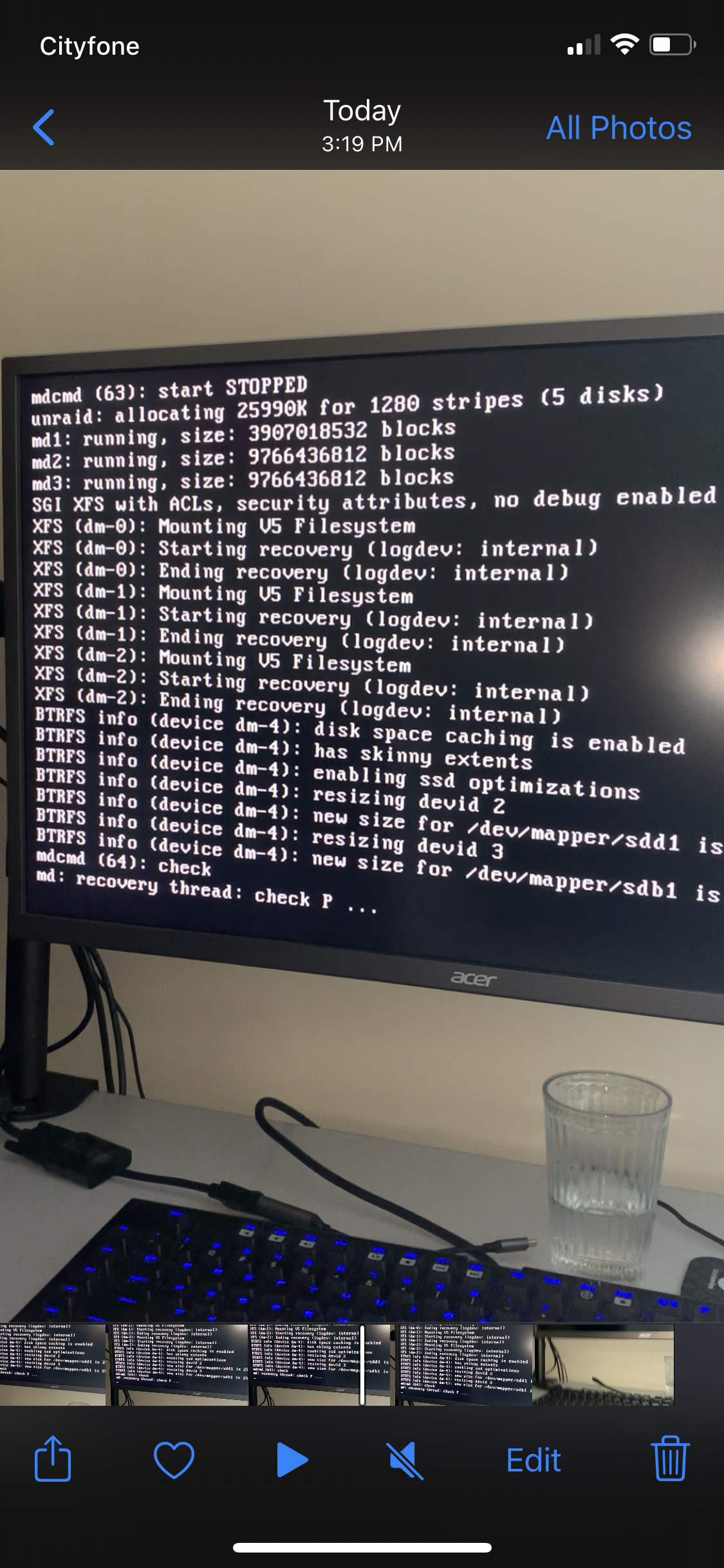

So I am experiencing an intermittent issue where my unraid server randomly shuts down. Usually it shuts down right after the array is started and mounted, though once it ran for a few hours before shutting down.

When my server comes up it automatically mounts the disks, and after mounting it nearly always instantly hard crashes and shuts down.
I am able to boot into the dashboard, and it will run no issue with the array not started. Additionally, I can also get it in maintenance mode no problem. But if the array starts it goes right down.
I have disabled docker as well as VMs in an effort to rule these out.
Additionally, booting in safe mode yields the same results.
The last thing I see before it dies is attached as an image.
I’m at my wits end. I really don’t think it is a hardware issue but rather software that I can't pinpoint. What really bothers me is I really wasn't doing much before this started happening. Normal use with no config changes.

If it server shuts down it's likely a hardware probable, like a overheating CPU or a PSU problem.
