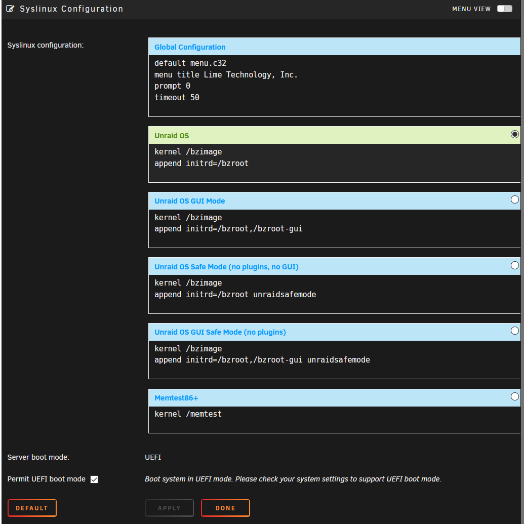

I'm told the UnRaid OS default boot mode can be changed by going to: Main->Boot Device->Click on Flash->then SYSLINUX Configuration. Shown in the screen capture below is the SYSLINUX Configuration GUI.  What specific change to the parameters shown below do I have to make so I can change my UnRaid OS default boot mode to a boot mode that changes it to a standalone PC?

Any help to the specific changes I need to make to the parameters shown in the screen capture below to change the boot mode will be greatly appreciated.

From what you are describing, you just want to select Unraid OS GUI Mode as the default by clicking that radio button.  This will start unRAID with a GUI on the monitor attached to the server and you can run MakeMKV docker container (or whatever app you are using on unRAID) to rip disks directly to the server from the server.

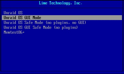

However, what I was asking was how I could change it so the "GUI Mode" becomes the new default so I could skip the BLUE Boot selection window shown below.  But as Hoopster helped me see there is an "UnRaid OS GUI Mode" Radio button which I totally did not see. I think this radio button will make my UnRaid PC automatically boot into GUI mode without the need to manually make the "GUI MODE" selection shown in the BLUE screen below.
Yes, that is what it does.
