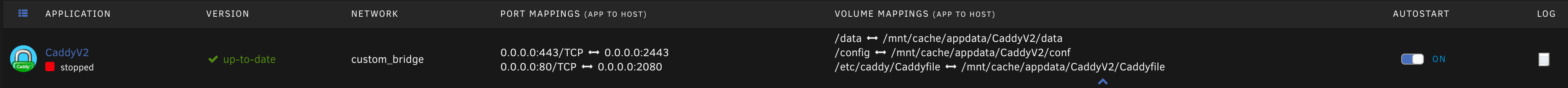

this weekend I set up my first unraid. Now I'm at the point where I would expect my hdd drives to spin up only when doing certain things. Having set up a spin down time of 15 minutes I don't see them spinning down at all. After some investigation I realized docker to be responsible. When stopping all docker containers the disks spin down and stay that way. Now to make it easier to troubleshoot I limited my further testing to only a single docker container: CaddyV2. It's a reverse proxy not doing much file wise and I have all volume mappings pointed to the cache drive:

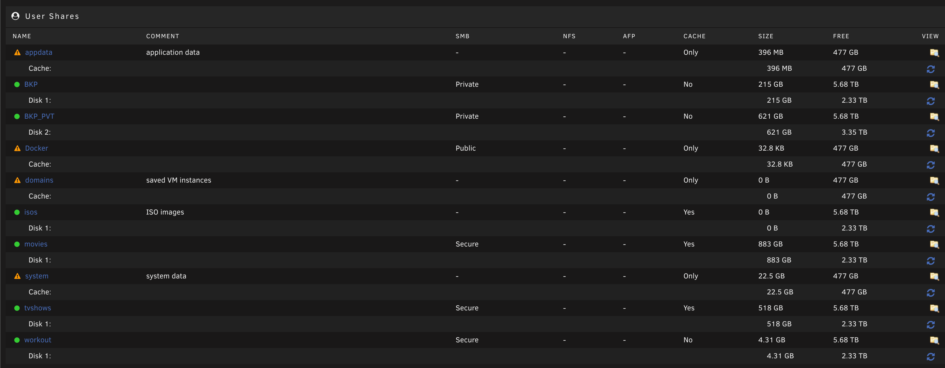

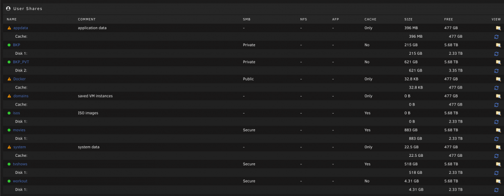

Here are my user shares, as you can see only custom shares are on disk 1 and everything system related is on cache only:

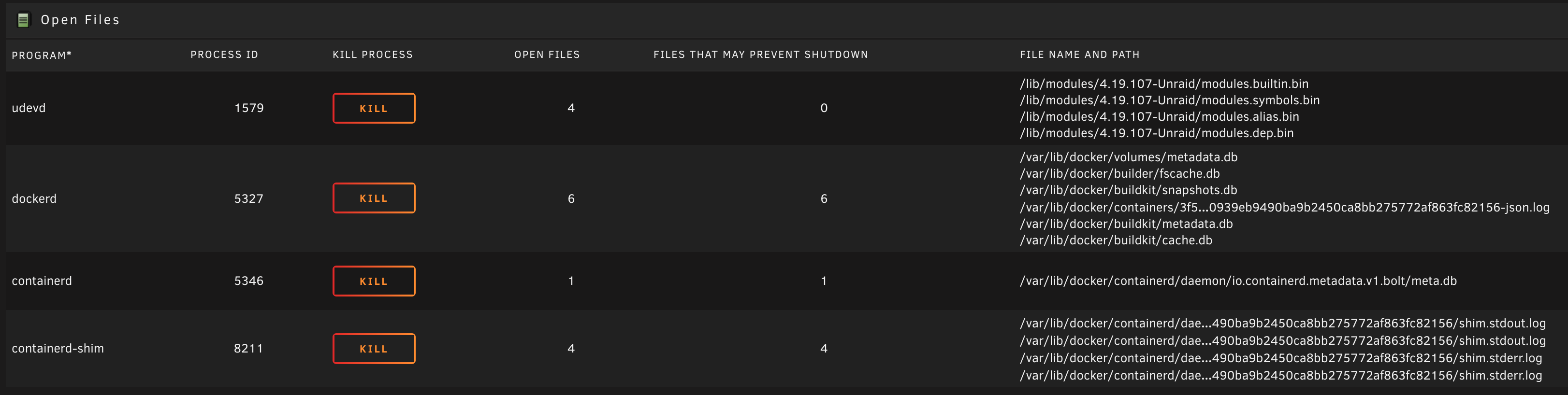

I've installed the open files plugin to see what's being accessed, here's a screenshot from when my drives just spun up after starting CaddyV2:

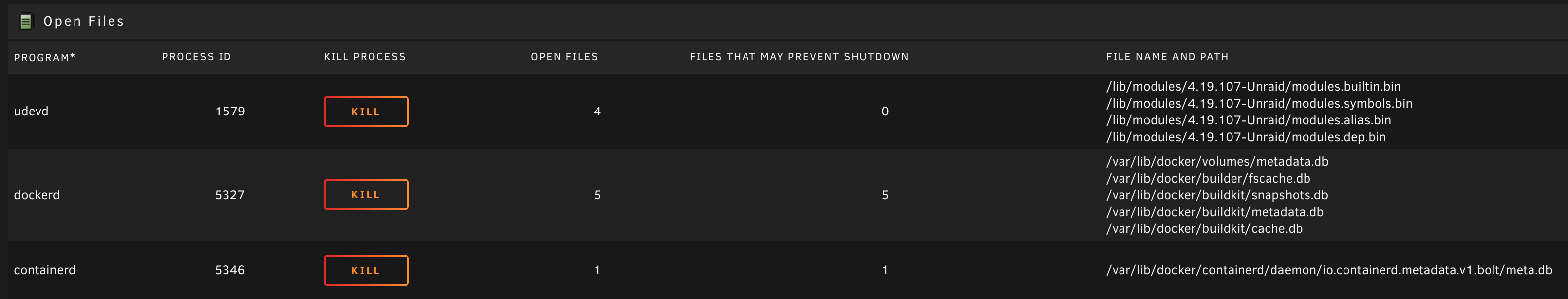

And here how it looks like while no dockers are running and the drives are spun down:
So containers-shim seems to the the only difference. Any idea on how those files in /var/lib/docker are making the drive spin up and others are not?

Click the View button (folder icon) on the Shares screen for shares you think should only be on the cache drive.  This will show what locations contain files for those shares.  It is possible that something remains on disk1  from appdata or another active system share.
