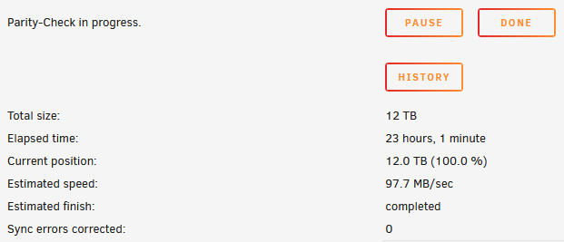

So my hard drives (including disk2) were plugged into a Molex to Sata power cable. I took that cable out and have them plugged into a Sata extension power cable. After doing so I ran another parity check and it just finished with no sync errors and no read errors on any of my drives.
Sounds like you could be right and disk2 was a power issue. It could even be that disk1 from my past threads was also a power issue. Regardless, my higher quality replacement PSU should arrive tomorrow with it's 10x Sata power slots and I'll be omitting all extension cables to my rig; all my drives will be plugged directly into the PSU. Even if it's fixed now I'm sure that PSU will be a worthwhile upgrade.
