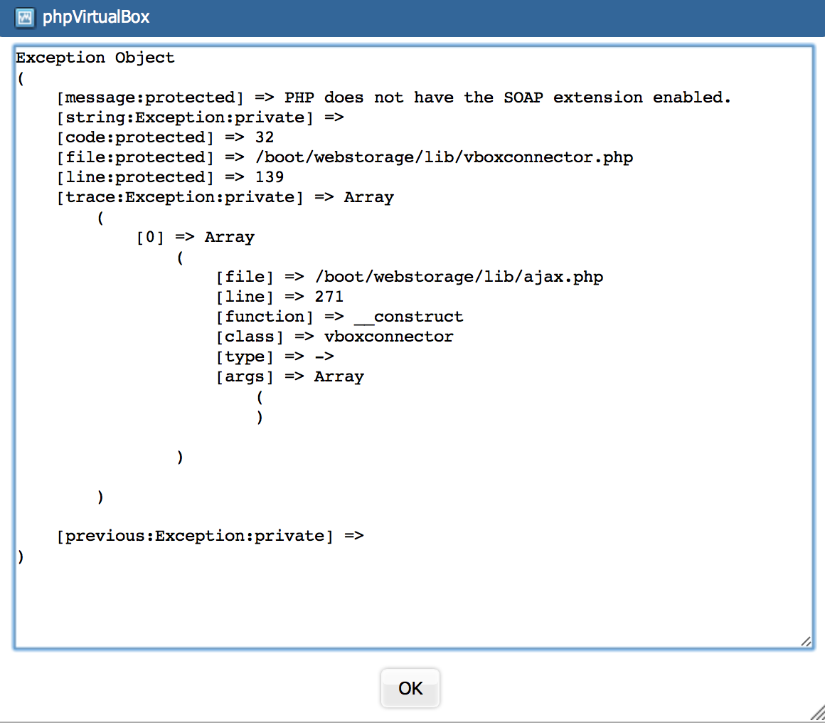

Hi Guys
I am getting the attached error, does anyone know what I am supposed to do with this please?
Seems related to your php... you will need to provide more details about how you got php, webserver, ... on your system.

I am on 5.0 rc12, used the virtual box plugin which seemed to install successfully.
used the simpleFeatures web plugin.
I receive the "PHP does not have the SOAP extension enabled." error and then the attached error I posted earlier.
Pretty new to this stuff so any additional information that you need I am happy to search for and provide.
the php sttings from the webplugin have soap disabled standard
search through this post the solution is in here
maybe do a search for SOAP on the forum
it is just changing the soap setting in the PHP.cfg file
I'm getting the same thing with the SOAP error. I'll update this when I figure it out. To be clear I fought thru the stupid simple features bullshit to get that installed. So if you're at that point... well let's continue.
At line 980 of /boot/config/simpleFeatures/php.ini
Uncomment that line.

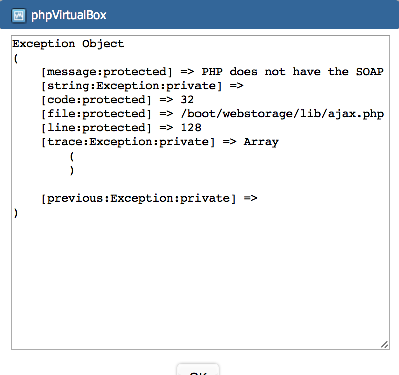

Still seem to be getting the "PHP does not have the SOAP extension enabled." error
but now expanding the details shows the attached.
Anyone provide any further help please?
Lee
I think you have to restart php.
Best to just do a complete reboot, if you can.
