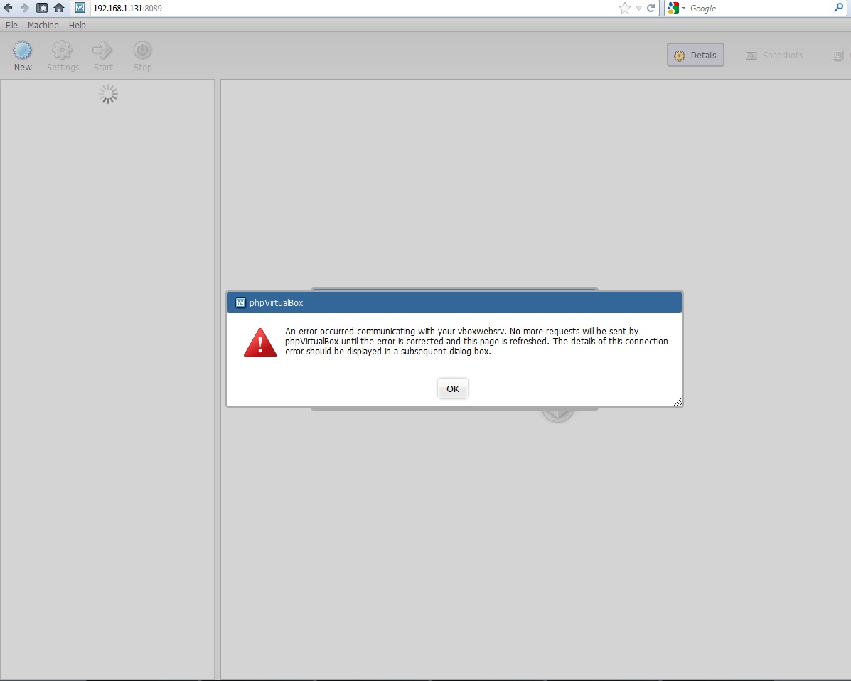

So I got it running without any (apparent) issues however when i try to log in through phpVirtualBox I got an error message (see screenshot attached)
That message I think is caused by not telling the vboxmanage process to accept unsecured connections.
VBoxManage setproperty websrvauthlibrary null
This is what I get:
root@Tower:/etc/rc.d/unraid.d# vboxwebsrv -H 192.168.1.131 1>/dev/null 2>&1 &
[1] 9314
root@Tower:/etc/rc.d/unraid.d# VBoxManage setproperty websrvauthlibrary null
/opt/VirtualBox/VBoxManage: error: Failed to initialize COM!
[1]+  Exit 3                  vboxwebsrv -H 192.168.1.131 >/dev/null 2>&1
I just realized that once I ran the vboxwebsvr command, the proccess doesn't run for long.
I run vboxwebsrv -H 192.168.1.131 1>/dev/null 2>&1 &
and next ps aux and the last entry is
[1]+  Exit 3                  vboxwebsrv -H 127.0.0.0 >/dev/null 2>&1
I guess this means the process stops almost inmediately, right? Where can I check the logs?
The tail of that command redirects output to the trash, so try running just
and see what it says.
root@Tower:/# vboxwebsrv -H 192.168.1.131
fatal error: RTR3Init: VERR_NO_TRANSLATION
