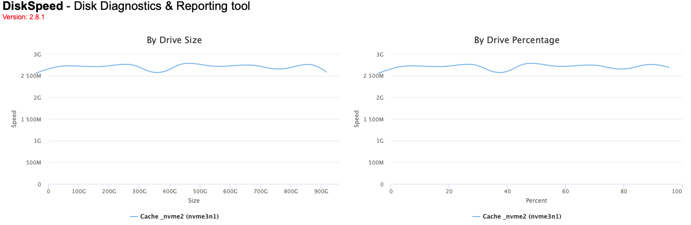

6.9 working fine, except cache performance. Current performance:
Raid 1:
500-600 MB/s in user path, about 2000 MB/s outside user path. No difference Raid 1 to Raid 10.
The performance outside user path is fine enough, strange with no performance gain with Raid 10.
Should the "user path" reduce performance by 3/4?
After upgraded to 6.9 yje cache has be formatted/rebuild/permissions/restarted.
