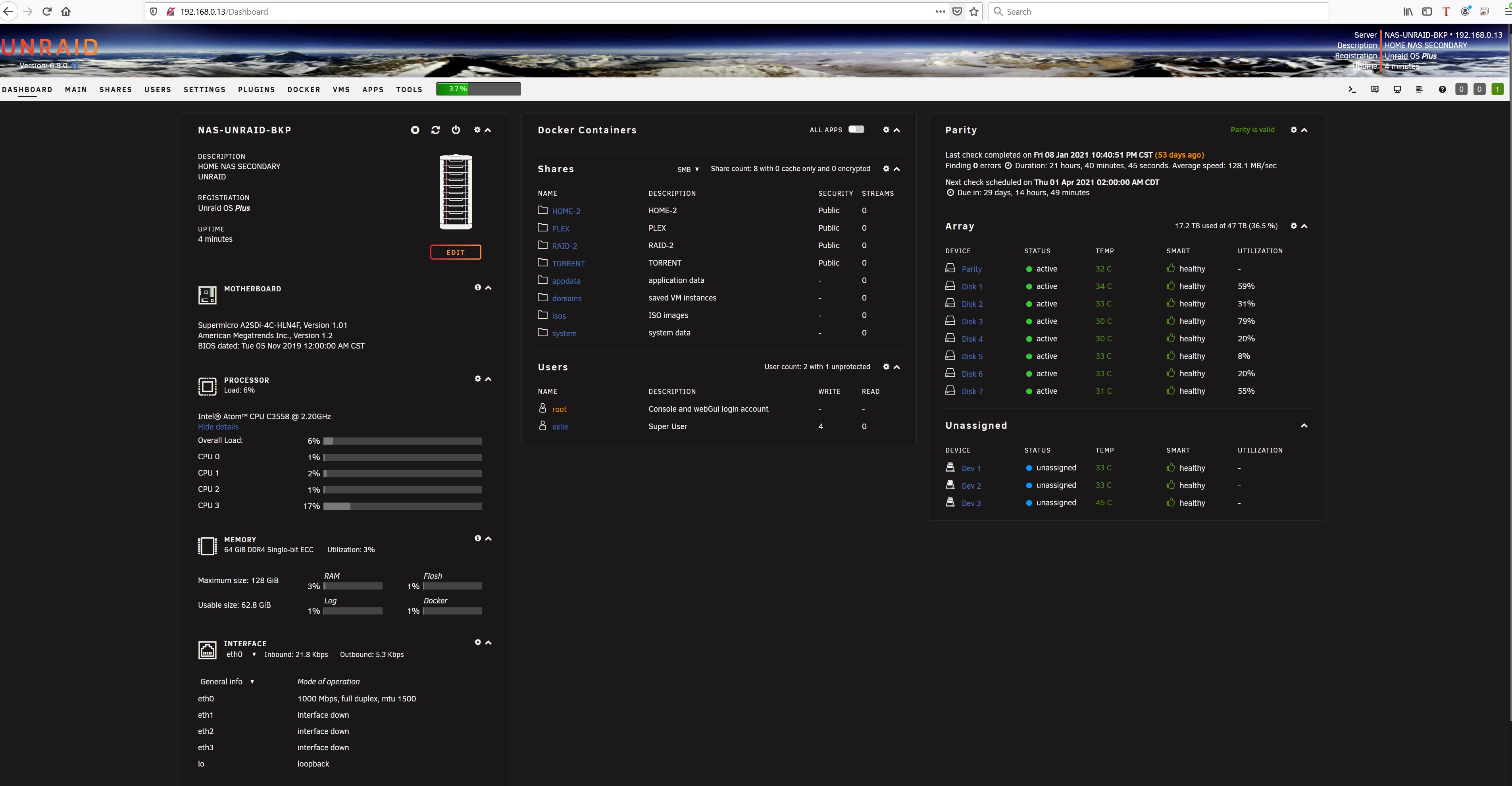

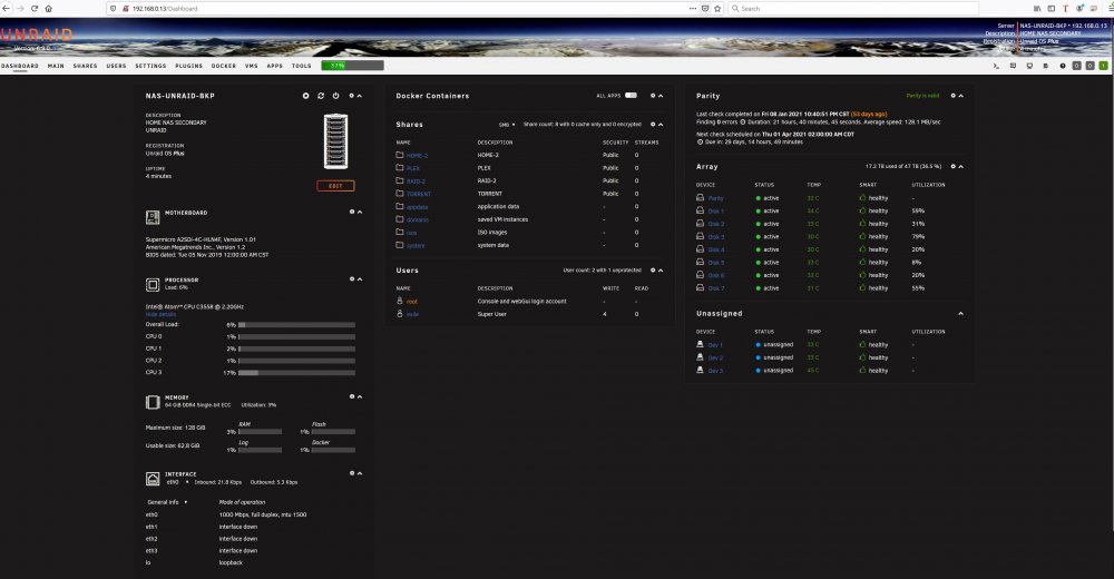

Upgraded to 6.9 and lost all my Docker Containers as others experienced. I think is related to loosing the cache drives assignment. Attached see the diagnostic file.
I will re-assign the cache manually see if it does fix the issues.

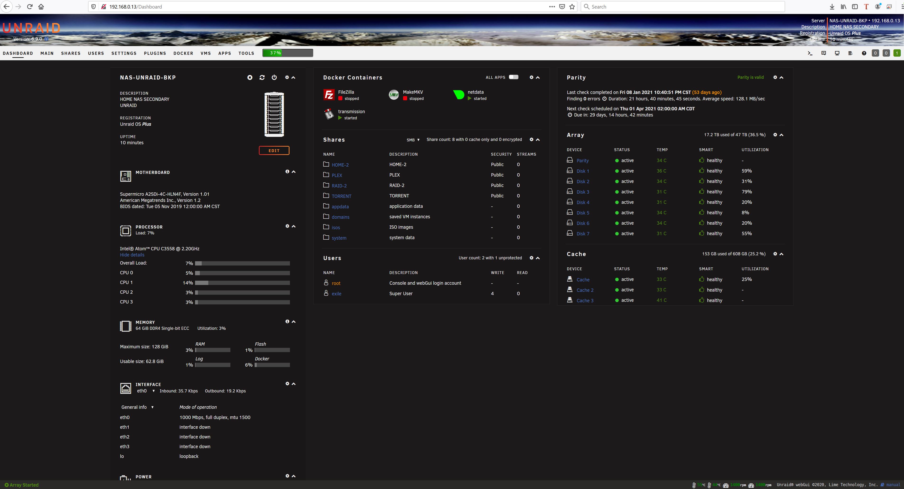

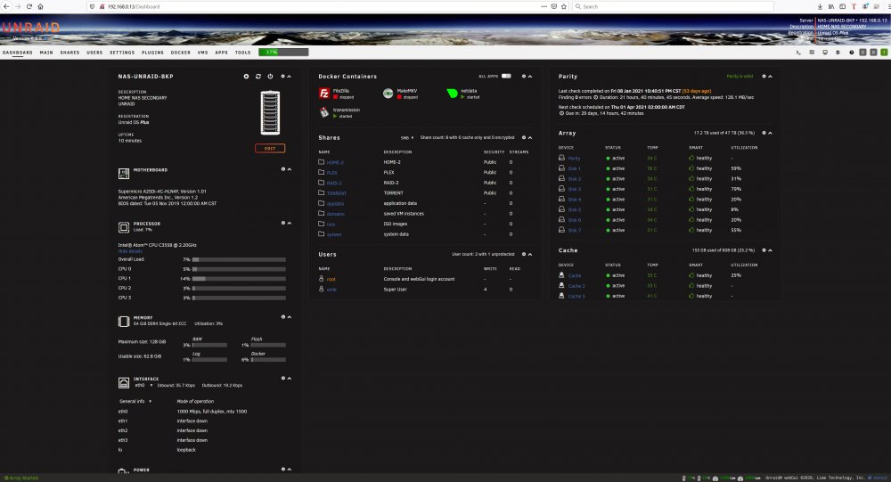

So I added the cache drives manually and created a pool so now is all back to normal. Got my Docker Containers back as well.
Why can't the upgrade process do all that?  Luckily this is my backup unraid but I have a production one with very important data so I am really really afraid to touch and upgrade that one as I have very important data.
Can the Unraid team advise please?

Is because I manually re-assigned the cache drives and I added the nvme as well.  But the point is the 6.9 upgrade doesn't migrate /retain the cache configuration to where it needs to be.  Could it be a bug?
In 6.8.3 I had 2 500Gb SSD forming the cache pool and the NVMe was unassigned
After 6.9.X the cache was gone which caused my dockers to disappear as I had my docker.img on the cache.  I ended up manually re-assigning all3 and it works fine now.
