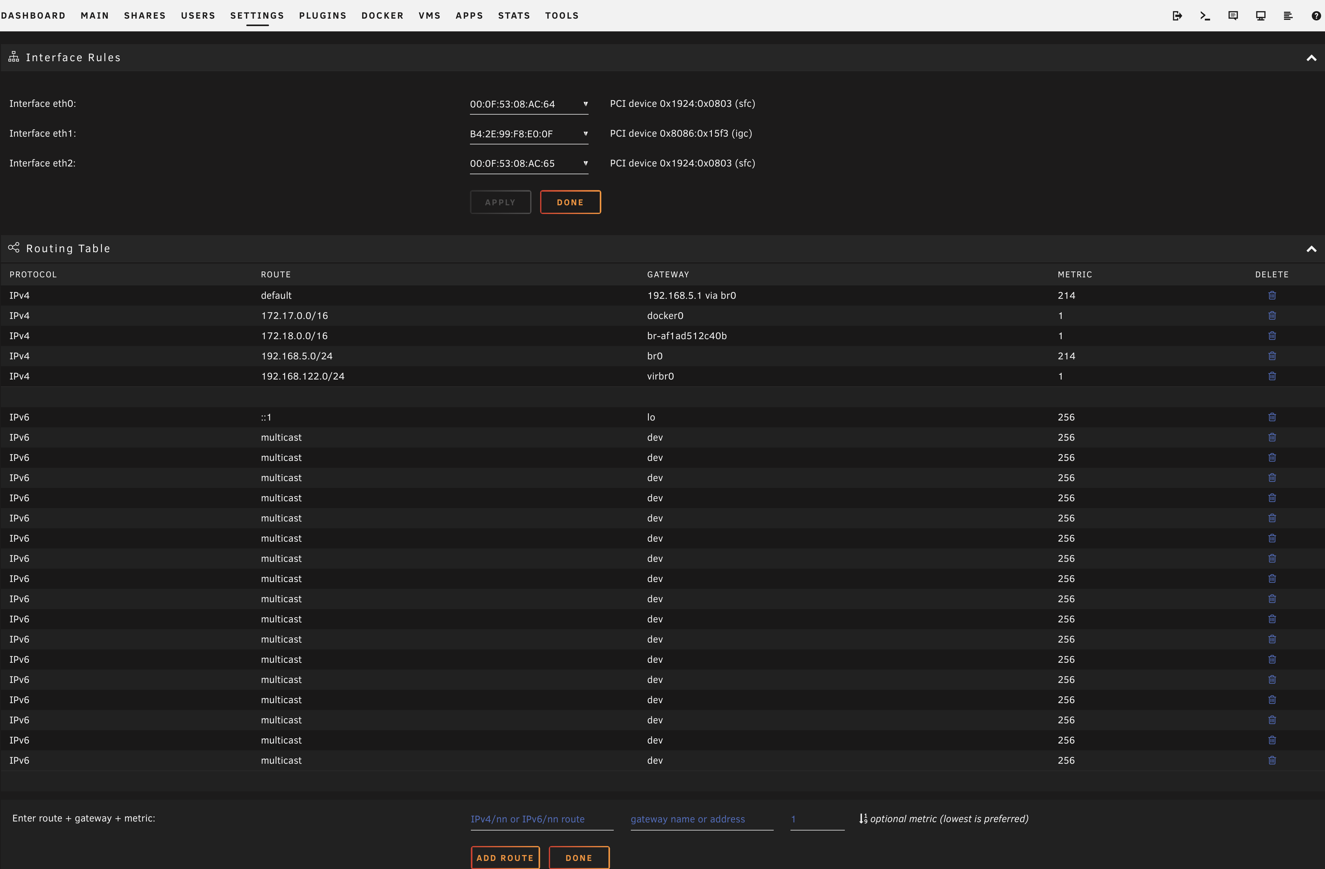

I have all these IPV6 "Multicast" entries after the upgrade to 6.9. I have IPV6 turned off. Am I safe to delete them all? I have been unable to find anything that explains what they are. Thanks! (Perfectly smooth upgrade from Beta30 BTW).
1326413653_ScreenShot2021-03-01at11_40_32PM.thumb.png.a90cb328b01684e854cbb35152b857a1.png
I also have these ipv6 multicast records after the update. Can I delete them?
Otherwise I have been able to update from RC2 to 6.9 without any problems.
