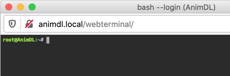

EDIT: SOLVED - I don't understand why, but it took 2 reboots and 3 x changing/refreshing the root password before I could again use ssh from my Mac. Regardless, it's working for now.
Original Message Starts:
I'm having this issue as well, but only on my backup unRAID system. Refreshing the root password hasn't worked. I'm using MacOS Terminal like I always have and under the 'New Remote Connection' dialog it shows I'm issuing the command:
ssh -p 22 [email protected]
After refreshing the password I also tried using the built-in shell access from the unRAID GUI and it works:
Looking at the syslog shows that it's using the right user (uid=0 which is root), but it's not accepting the password. This worked fine before the upgrade to 6.9.0. Note that the backup system was upgraded from 6.8.3 whereas my media server (which I can ssh into) was upgraded from 6.9.0 RC2.
Suggestions? Thanks!
