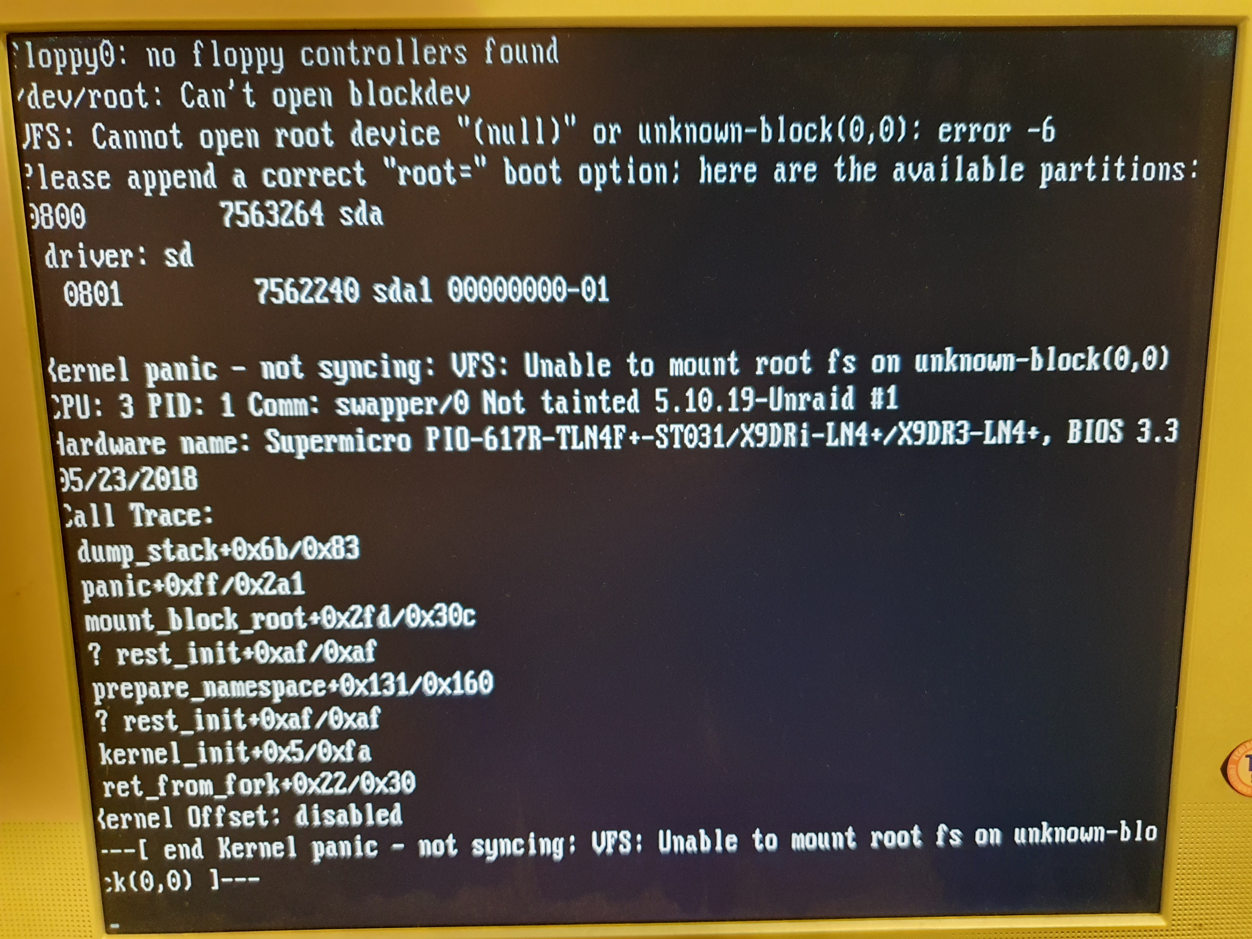

So I then decided to reboot to go into GUI mode on the server directly.
And then, after selecting Unraid OS GUI mode, while loading it freezes. See attached image.

That is usually a flash drive problem, backup and recreate it.

I have no idea how I solved it but here is what happened:
I created a new usb stick with 6.9.1 on it. Copied all the config files from a backup of 6.8 on it.
Restarted my server, selected the new boot drive and restarted.
Then the server booted from the old (non functioning one) and... wel it suddely worked.
Then proceded to upgrade it to 6.9.1 and everything is fine since.
