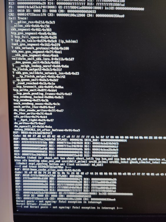

I created the new array and put my drives back in, started it up and it began parity syncing, all good, left it overnight to finish and came back to the web UI showing 90.1% done and unraid had crashed with the following on screen:
Reset machine and it has started parity sync again, data is all there by the looks of it, but need to make sure this doesn't happen again...

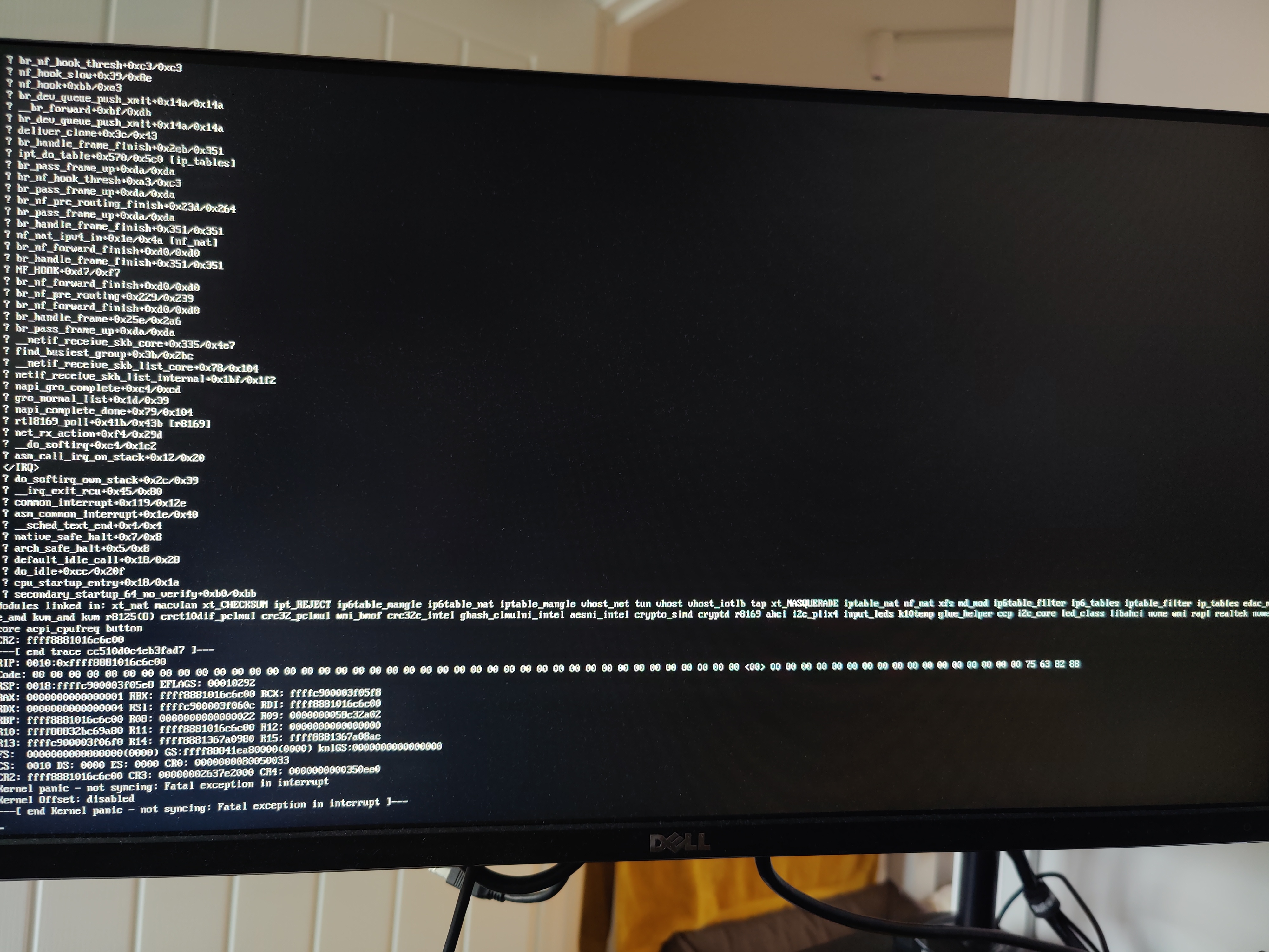

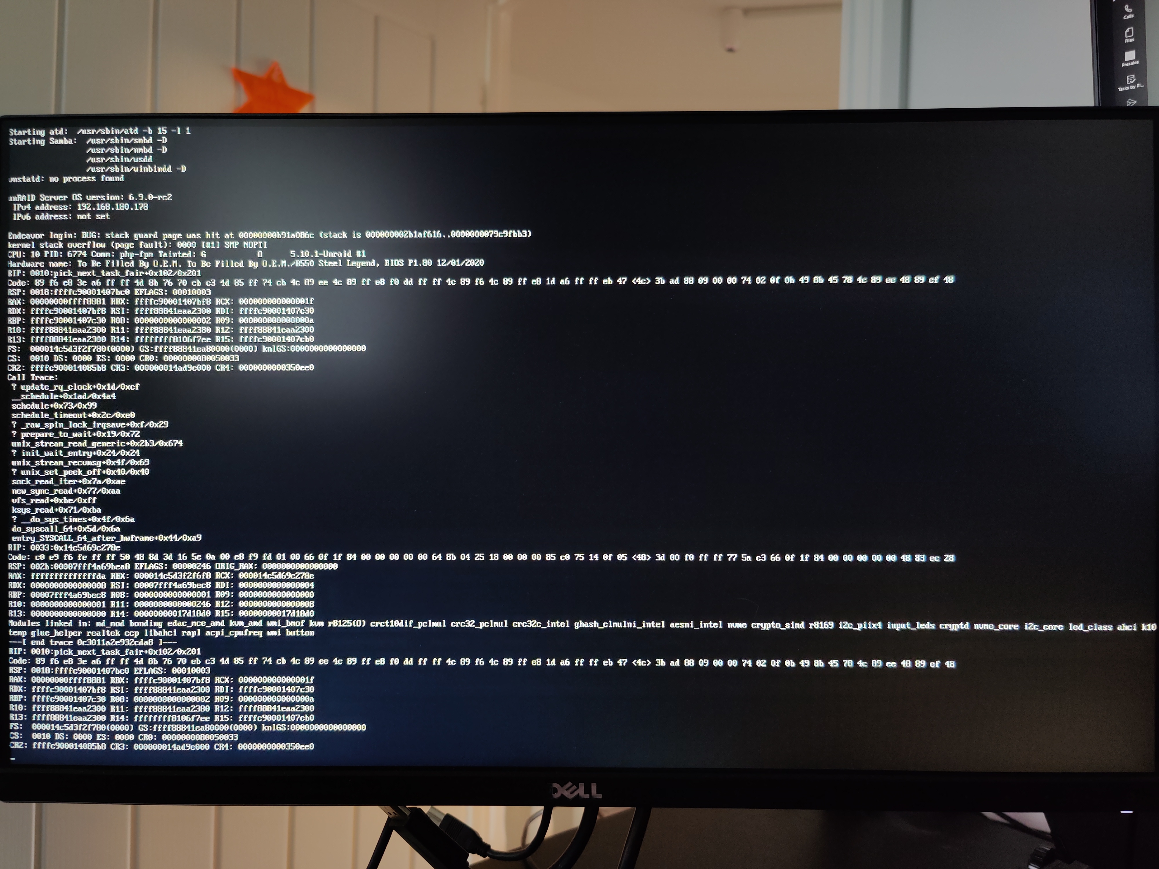

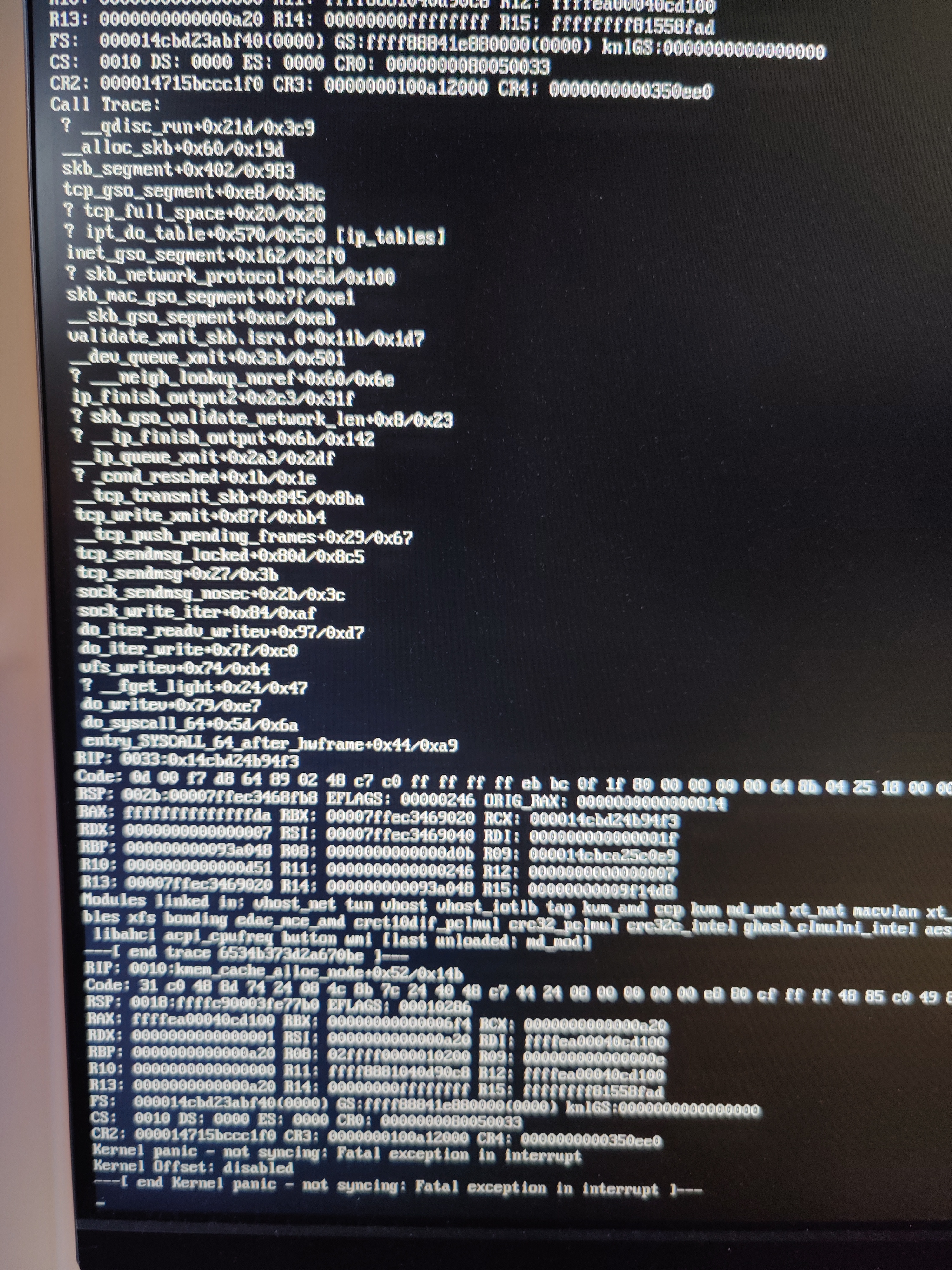

Lock up occurs as soon as 10mins after boot or longest it has been up is ~12 hours
I've attached the last two lock ups and diagnostics dumps
