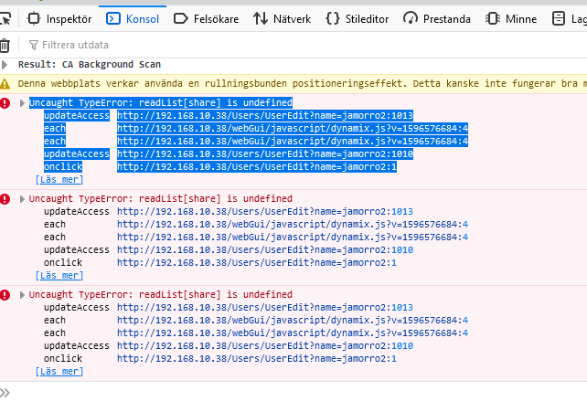

When editing permissions for users under the user tab i get the following error.

So the only issue i have is that i cannot change the readwrite permissions from under the users tab and that my first account somehow isnt able to access the drives through network share. The network share is a minor problem since new accounts work but the readwrite part is a bit annoying.
