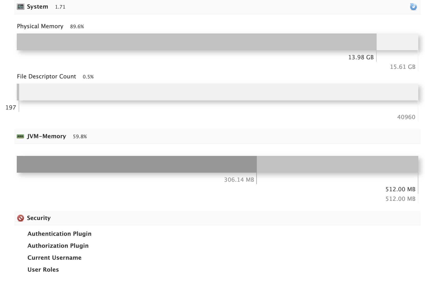

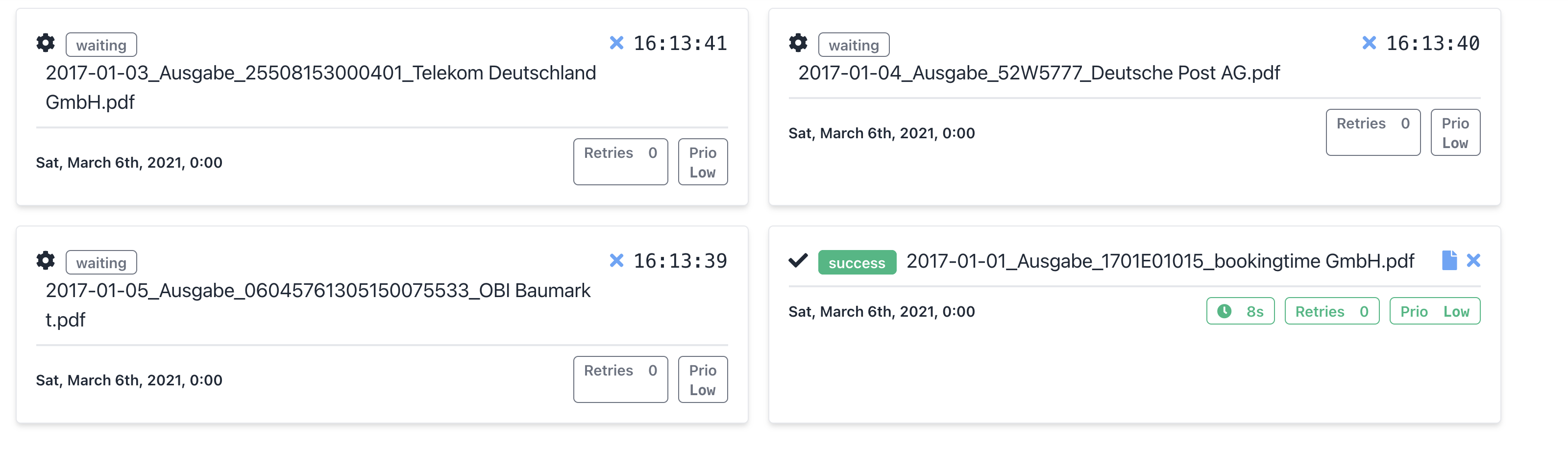

Hab mal fasst 300 Belege hochgeladen...
jetzt stoppt docspell-joex immer... 😞
was sagen die Joex Logs?

java.lang.OutOfMemoryError: Java heap space
at java.desktop/java.awt.image.DataBufferByte.<init>(DataBufferByte.java:76)
at java.desktop/java.awt.image.Raster.createInterleavedRaster(Raster.java:266)
at java.desktop/com.sun.imageio.plugins.jpeg.JPEGImageReader.readInternal(JPEGImageReader.java:1228)
at java.desktop/com.sun.imageio.plugins.jpeg.JPEGImageReader.readRaster(JPEGImageReader.java:1541)
at com.twelvemonkeys.imageio.plugins.jpeg.JPEGImageReader.readImageAsRasterAndReplaceColorProfile(JPEGImageReader.java:502)
at com.twelvemonkeys.imageio.plugins.jpeg.JPEGImageReader.read(JPEGImageReader.java:395)
at org.apache.pdfbox.filter.DCTFilter.decode(DCTFilter.java:91)
at org.apache.pdfbox.cos.COSInputStream.create(COSInputStream.java:80)
at org.apache.pdfbox.cos.COSStream.createInputStream(COSStream.java:179)
at org.apache.pdfbox.pdmodel.common.PDStream.createInputStream(PDStream.java:241)
at org.apache.pdfbox.pdmodel.graphics.image.PDImageXObject.createInputStream(PDImageXObject.java:793)
at org.apache.pdfbox.pdmodel.graphics.image.SampledImageReader.from8bit(SampledImageReader.java:517)
at org.apache.pdfbox.pdmodel.graphics.image.SampledImageReader.getRGBImage(SampledImageReader.java:226)
at org.apache.pdfbox.pdmodel.graphics.image.PDImageXObject.getImage(PDImageXObject.java:479)
at org.apache.pdfbox.pdmodel.graphics.image.PDImageXObject.getImage(PDImageXObject.java:460)
at org.apache.pdfbox.rendering.PageDrawer.drawImage(PageDrawer.java:1059)
at org.apache.pdfbox.contentstream.operator.graphics.DrawObject.process(DrawObject.java:67)
at org.apache.pdfbox.contentstream.PDFStreamEngine.processOperator(PDFStreamEngine.java:933)
at org.apache.pdfbox.contentstream.PDFStreamEngine.processStreamOperators(PDFStreamEngine.java:515)
at org.apache.pdfbox.contentstream.PDFStreamEngine.processStream(PDFStreamEngine.java:489)
at org.apache.pdfbox.contentstream.PDFStreamEngine.processPage(PDFStreamEngine.java:156)
at org.apache.pdfbox.rendering.PageDrawer.drawPage(PageDrawer.java:275)
at org.apache.pdfbox.rendering.PDFRenderer.renderImage(PDFRenderer.java:347)
at org.apache.pdfbox.rendering.PDFRenderer.renderImage(PDFRenderer.java:268)
at org.apache.pdfbox.rendering.PDFRenderer.renderImageWithDPI(PDFRenderer.java:240)
at docspell.extract.pdfbox.PdfboxPreview$.docspell$extract$pdfbox$PdfboxPreview$$getPageImage(PdfboxPreview.scala:46)
at docspell.extract.pdfbox.PdfboxPreview$$anon$1.$anonfun$previewImage$2(PdfboxPreview.scala:29)
at docspell.extract.pdfbox.PdfboxPreview$$anon$1$$Lambda$1970/0x000000010099f840.apply(Unknown Source)
at cats.effect.internals.IORunLoop$.cats$effect$internals$IORunLoop$$loop(IORunLoop.scala:104)
at cats.effect.internals.IORunLoop$.restartCancelable(IORunLoop.scala:51)
at cats.effect.internals.IOBracket$BracketStart.run(IOBracket.scala:100)
at cats.effect.internals.Trampoline.cats$effect$internals$Trampoline$$immediateLoop(Trampoline.scala:67)

so sieht die Warteschlange aus:
und der joex steht wieder 😞

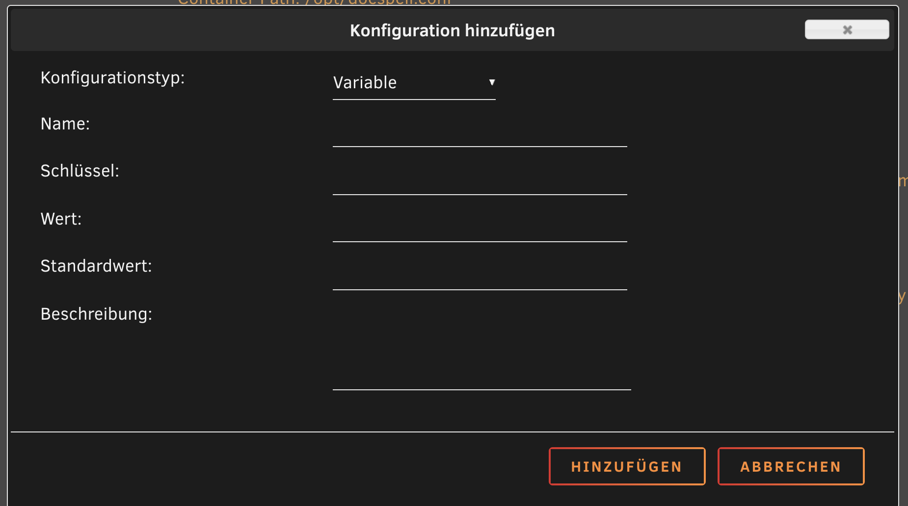

(...) <Variable> <Value>-Xms256m -Xmx2500m</Value> <Name>JAVA_OPTS</Name> <Mode/> </Variable> </Environment> (...) <Config Name="JAVA_OPTS" Target="JAVA_OPTS" Default="-Xms256m -Xmx2500m" Mode="" Description="Container Variable: JAVA_OPTS" Type="Variable" Display="always" Required="false" Mask="false">-Xms256m -Xmx2500m</Config> (...)
wo soll den die Variable eingetragen werden 🙂
Name ist der von dir vergebene Name
Schlüssel ist der Variablen Namen
Wert ist der Variablenwert
Brauchst du aber nicht, denn ob über extra parameters oder so bleibt sich gleich.

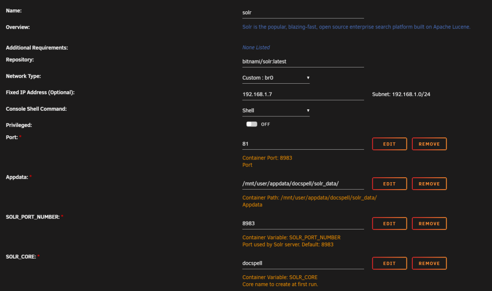

Das ist ein Fehler bei der Erstellung des Volltextindexes. Schaut so aus als würde Solr nicht (ordentlich) laufen...?
Du kannst mal auf http://deine.solr.ip.adresse/solr/#/ gehen und schauen ob du da was findest, allerdings kenne ich mich da auch nicht aus....
Hast du Solr zwischenzeitlich aktualisiert? Ich habe nämlich eine Aktualisierung mitgemacht, da hatte der Entwickler (bitnami) etwas grundlegendes geändert, da musste ich den Index neu aufbauen. Schau mal in Docspell ob deine Volltextsuche noch funktioniert.

Ich hab dann in solr reingeschaut und ich denke das das RAM nicht reicht:
