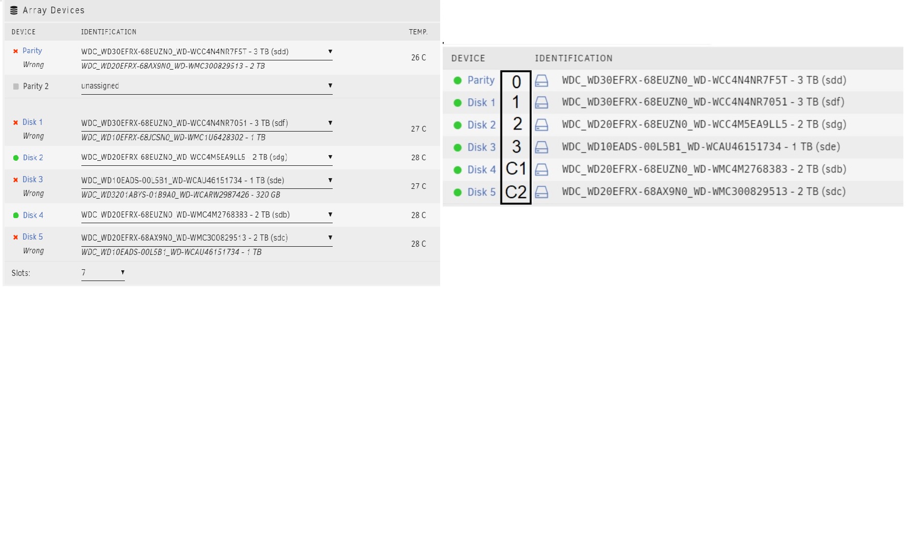

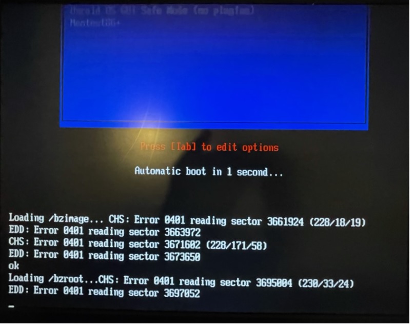

I tried to upgrade to version 6.9.0 - the upgrade seemed to be going fine and after completion it read "REBOOT SERVER" which I did.  When the unraid did not start in 3-4 minutes I went to see the server monitor and I noticed that it's in an endless boot loop - I took a snapshot of the screen (see below) and thought that there was something wrong with the boot usb.  I replaced it with a backup that I had and it booted fine but the backup disk configuration changed from the time the backup was taken.  I have a record of the new configuration and I updated the configuration to reflect what I know the disks are (see below) - and that's when I stopped afraid to do damage the server irreparably.

Go to Tools -> New config
Then re-assign all the disks as they should be, check "parity is already valid" before array start, start array.

Correct, make sure you double check the assignments, most importantly don't assign any data disk to a parity slot.
