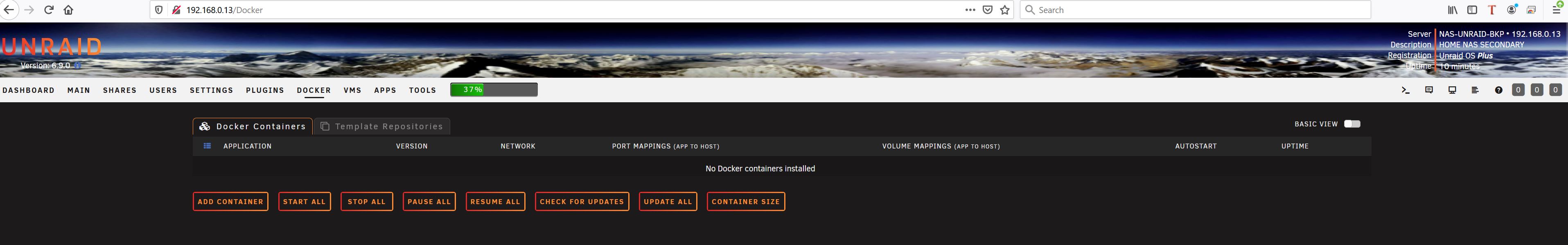

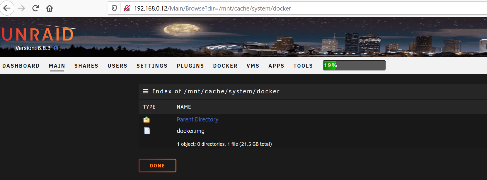

OK looks like my Docker.img is on my cache pool and during the upgrade I lost my cache assignment so all Docker Containers stoped working.
The reason I lost my cache is probably due to an unassigned NVMe drive that was not part of the 2 X SSD 500GB drives cache pool. --> This may be a bug.

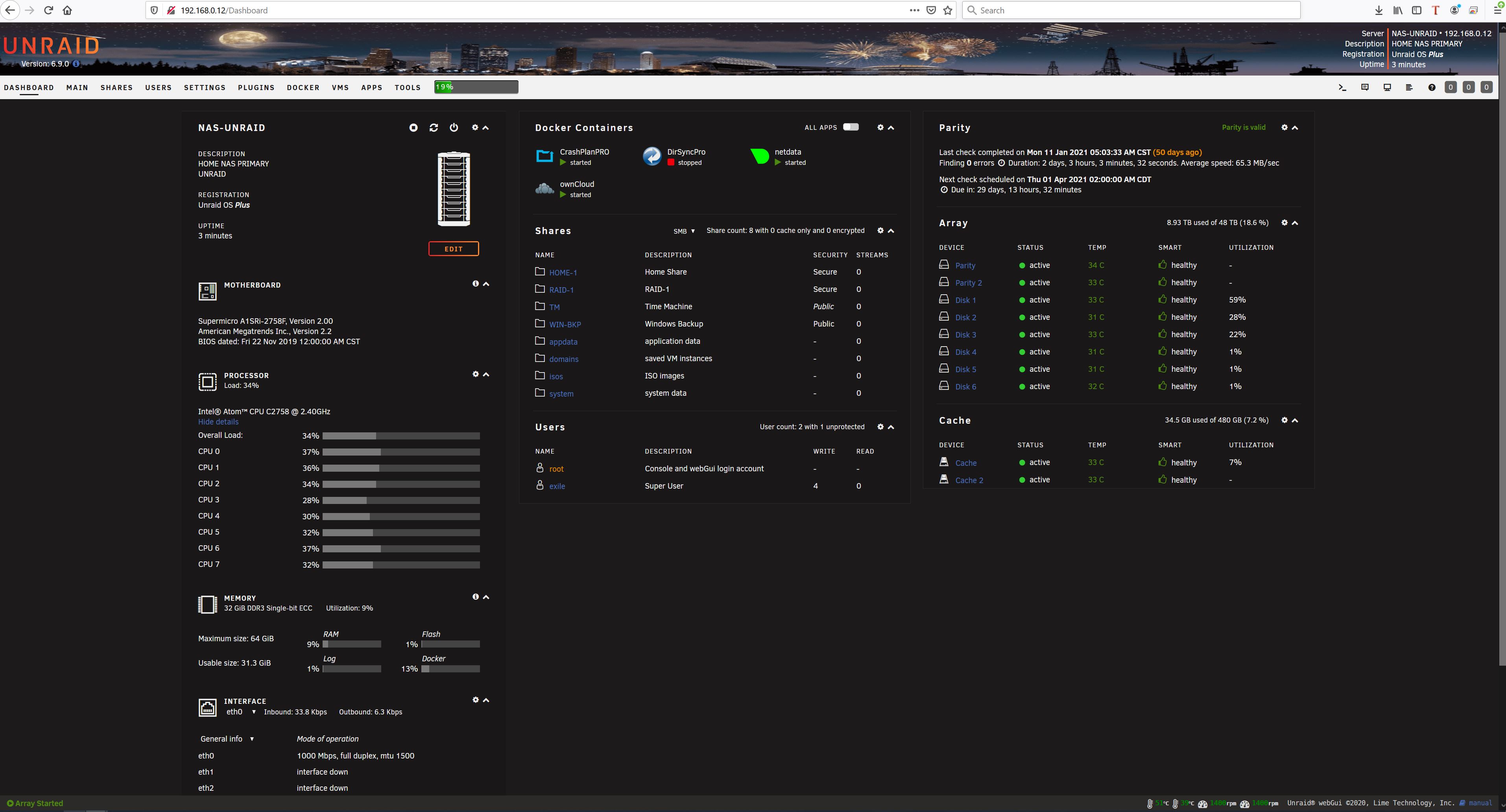

I am backup and running on this Unraid as well as my primary which upgrade went just fine (I only had 2 SSD drives on that cache)
Well excited about upgrading to 6.9 but disappointing that all my docker containers are gone?
I am reverting back to 6.8.X and I hope my stuff shows back up :(

Well I restored back to 6.8.3 and docker contained still gone.  Now that's so disappointing :(   Any ideas how I get these back?

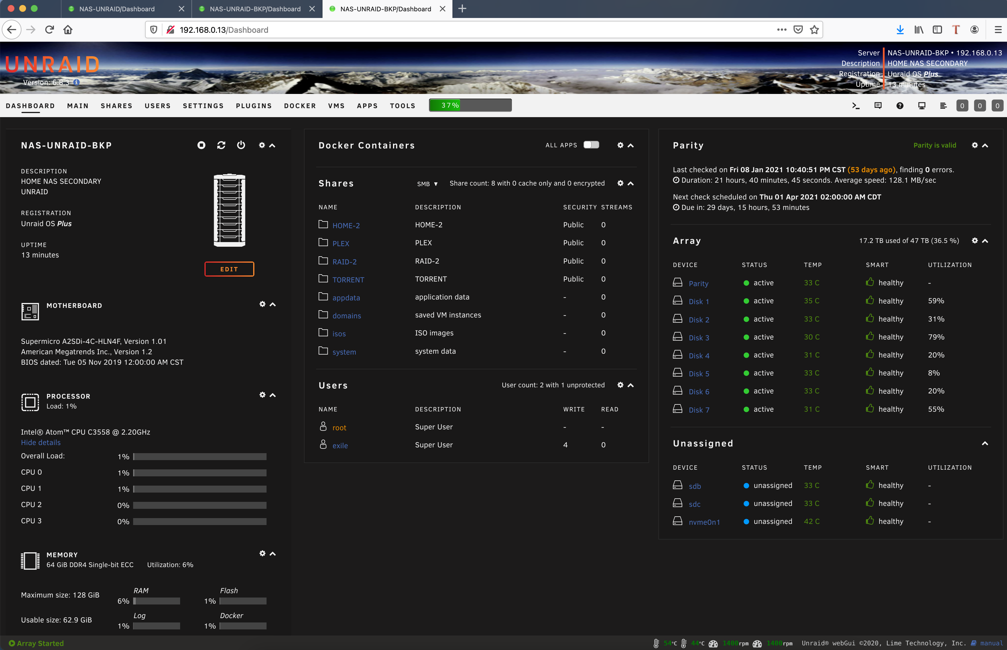

Man what a MESS.  And just now noticed that all my cache drives are unsigned. SERIOUSLY?  How can an upgrade be so unreliable?  What else should I look for missing?  My level of confidence in this upgrade is tanked, sorry :(

You shouldn't need to do anything when going to 6.9 re containers. But sounds like your mapping to the image file was affected some how.  Does it reside on your cache?
31 minutes ago, SimonF said:
When upgrading the Cache just gets made in to a multipool config with the name of cache, this is why you have to do a manual action if you revert as multipools don't exist on 6.8.3.
You're onto something.  So yes the docker.img is on the cache drive.  The question is why I am loosing my cache drives assignment after the upgrade to 6.9 ?  It looks that's the reason for all Dockers not working.  How do I fix this?

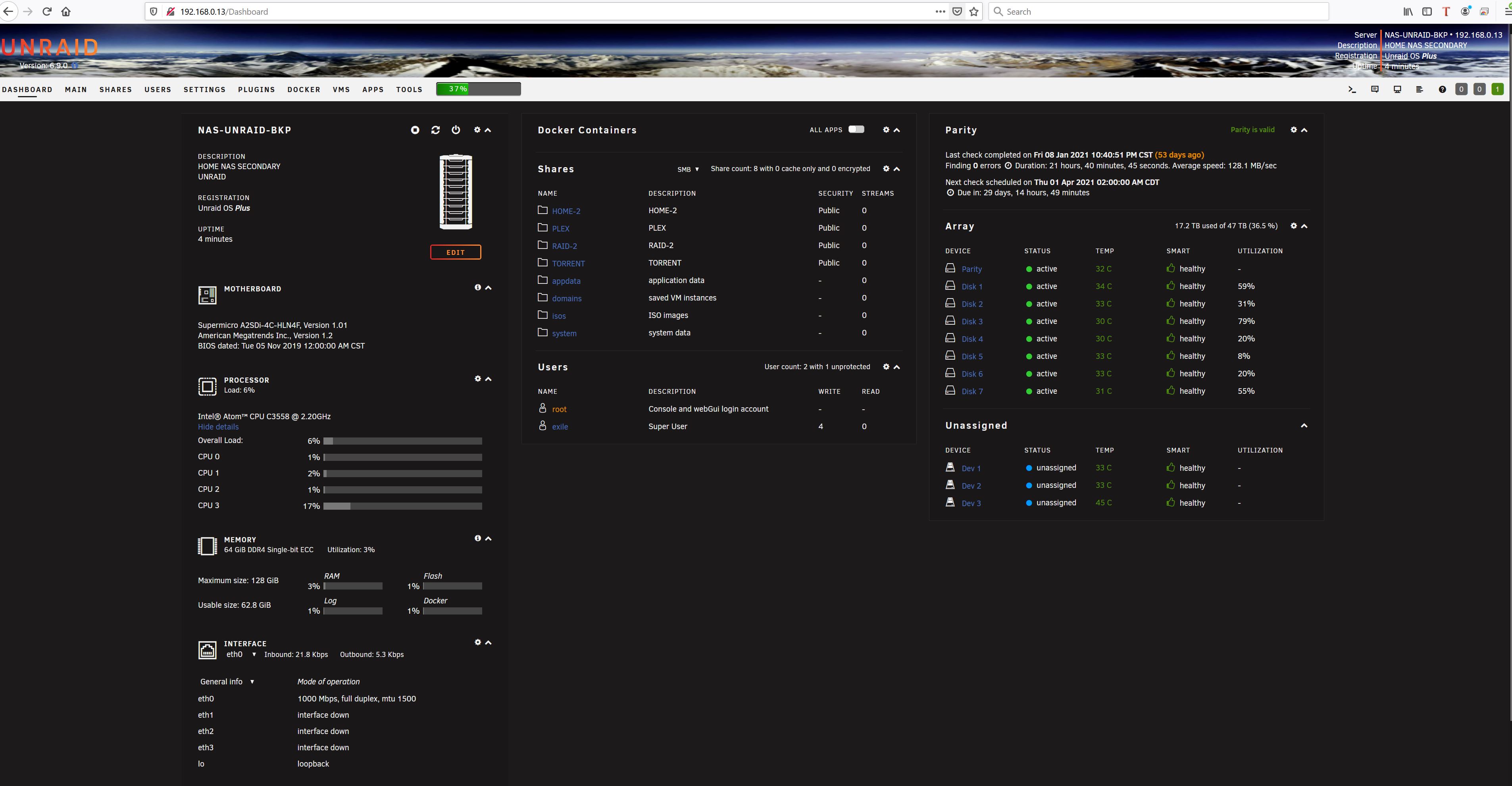

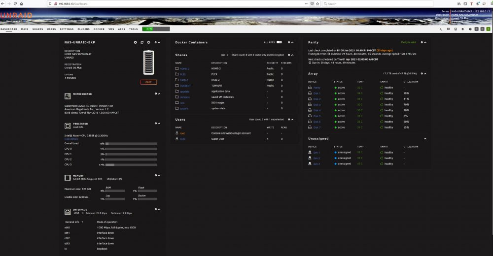

You don't lose the cache upgrading, or at least you shouldn't, you lose going back to v6.8, if after the upgrade there's no cache pool post new diags.
According to those 6.8.3 Diagnostics in OP, you seem to have 3 SSDs, one an NVMe different in size than the other 2. Were these all in cache pool or was one of them Unassigned?
Here it goes Sir.

The NVMe was unassigned as I plan to take it out when I access this box.  Would the unassigned nvme cause this issue?

Is because I manually re-assigned the cache drives and I added the nvme as well.  But the point is the 6.9 upgrade doesn't migrate /retain the cache configuration to where it needs to be.  Could it be a bug?
In 6.8.3 I had 2 500Gb SSD forming the cache pool and the NVMe was unassigned
After 6.9.X the cache was gone which caused my dockers to disappear as I had my docker.img on the cache.  I ended up manually re-assigning all3 and it works fine now.

I think the unassigned NVMe was the problem. I just upgraded my primary UNRAID and the upgrade went fine.  I only have 2 SSD drives for the cache on this one.
