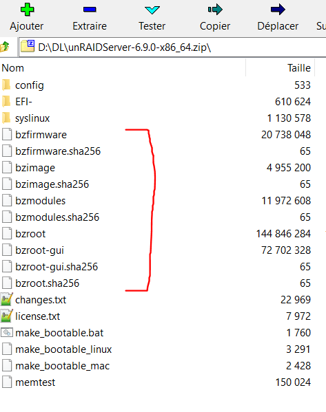

I think that trurl means really to do it manually :
  • Stop the server
  • put your flash in a computer
  • download the zip from : https://unraid.net/download
  • copy the bz* files from the zip to your flash
  • put the flash back on the server and start
I am wondering if a 2 GB system is OK for 6.9.0 though. Anyone tried ?
PS: the files in question

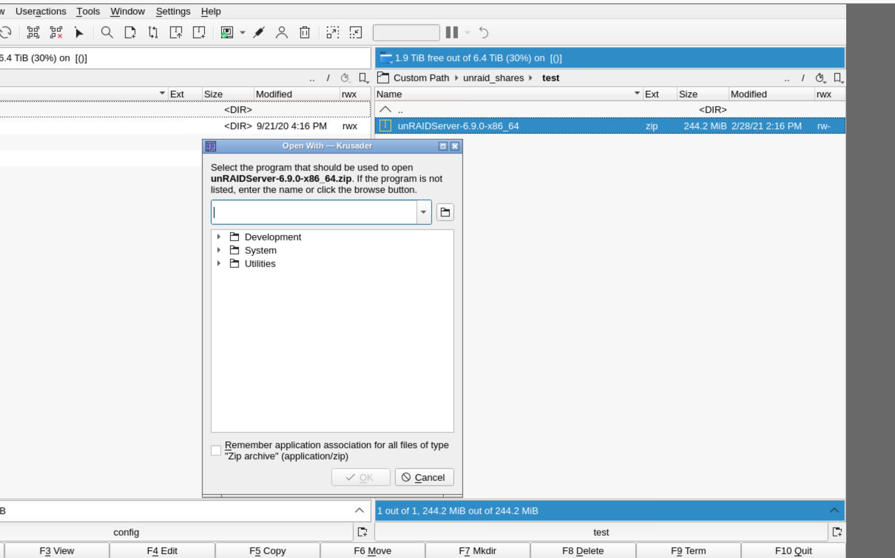

18 minutes ago, comet424 said:
but ya  is there any unraid unziper?
You can browse a zip file from Krusader.
I guess you could use it to update the files on the flash.
i double clicked the Zip file in krusader  i thought maybe it had a built in winrar  or pkzip
but it just tells me what program to open the zip file with..  some program KAT or Kate  if i remember seeing  and some others  not at the computer..
other then that i cant view or extract files in krusader  unless there is a plugin to install?
i check the bottom i search for zip or pkzip  or 7zip  nothing

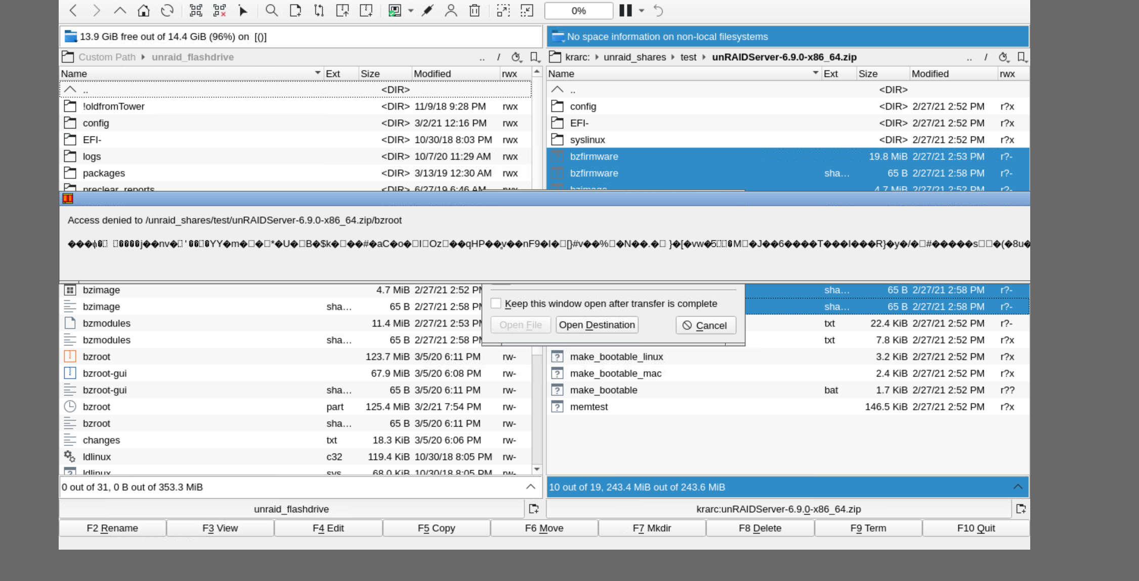

figure it out  i had to restart krusader  and i right clicked  the file for browse  but i cant seem to access the flash drive share    basiclly access denied
so i got to view flash drive i seit UID GPID   both to 0
so i could see it.. but i tried copying the bz files  but i got and error
got it up and running what i did in the end was that error up there  crashed krusader and it actually restarted itself
so i copied to the same folder  TEST
and then i copied the files  in TEST  to the flash drive that worked  and i rebooted..
