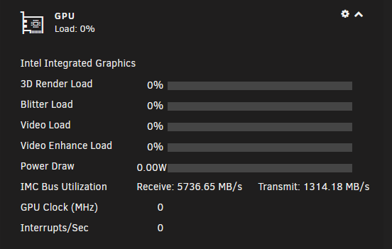

Im the same if i try cd /dev/dri then ls nothing comes up. before in 6.8.3 with the modprobe in go file the igpu would be listed if i typed this. But since Ive installed intel top plugin when upgraded to 6.9.1 its not listed when i type cd dev/dri . While transcoding in plex it definitely using the igpu as can be seen in the gpu statistics and (hw) is listed on the plex dashboard.
Edited by coblck

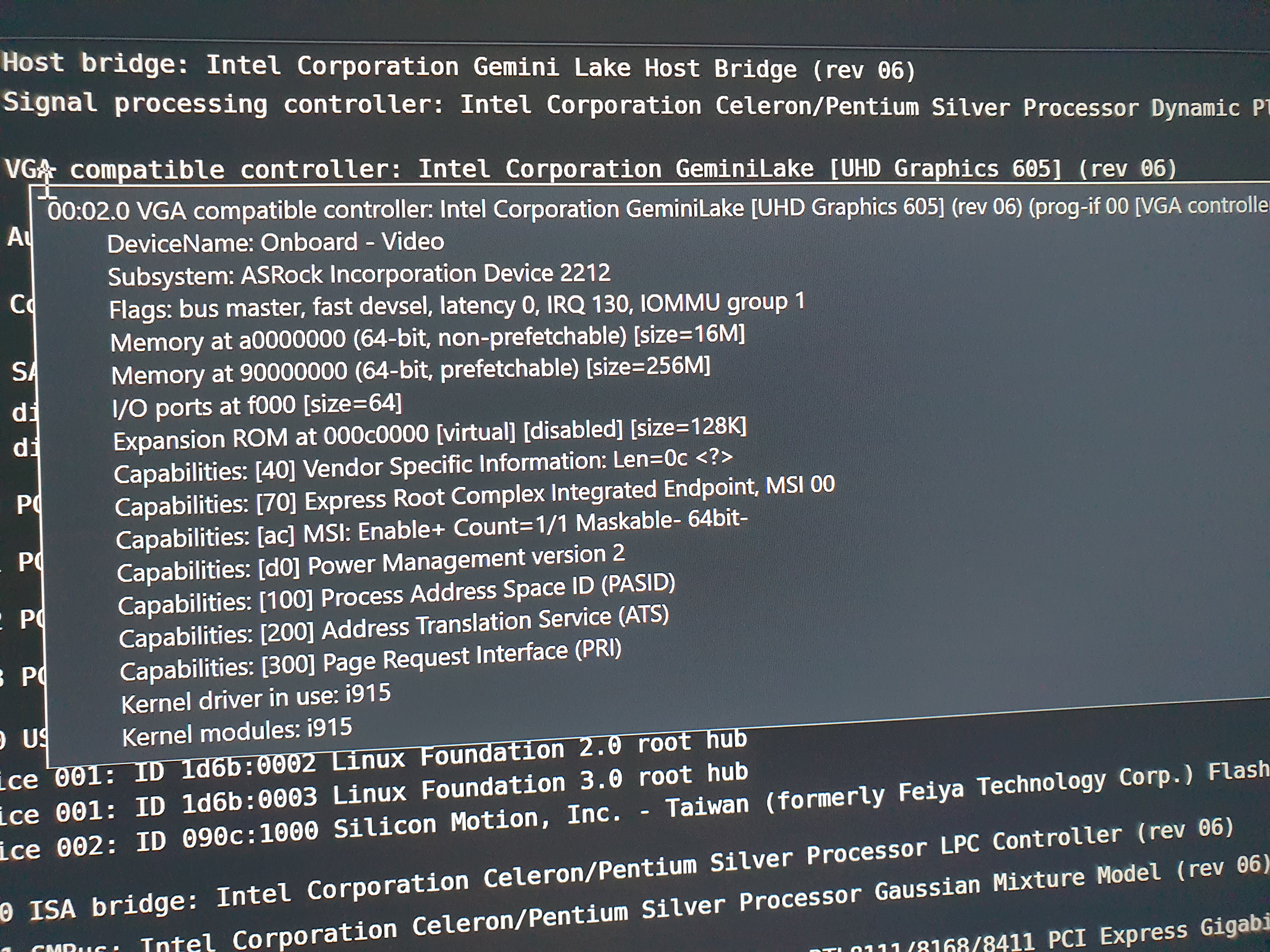

in the SysDevs tab my igpu is available and has it's own iommu group and in the description it lists i915 as the driver.
Well, that is interesting.  You see no /dev/dri with these contents?
and even though you have no /dev/dri, it is referenced in the Plex container in either Extra Parameters or as a configured Device (either will work)?
If you are seeing (hw) in the Plex dashboard/Tautulli then it is obviously using the iGPU for hardware transcoding.
Personally, I have never seen Plex or HandBrake use the iGPU without the presence of /dev/dri as seen above. but who knows, maybe something has changed with the way it is being called in 6.9.1 with the way drivers are being loaded?  I still see the /dev/dri folder and am curious how it could work without it.

No. not necessary to get things running.  It is just for seeing iGPU stats when in use.  I installed the GPU Statistics plugin (which uses Intel Top), but it is just window dressing.
Nothing going on with iGPU at the moment.
