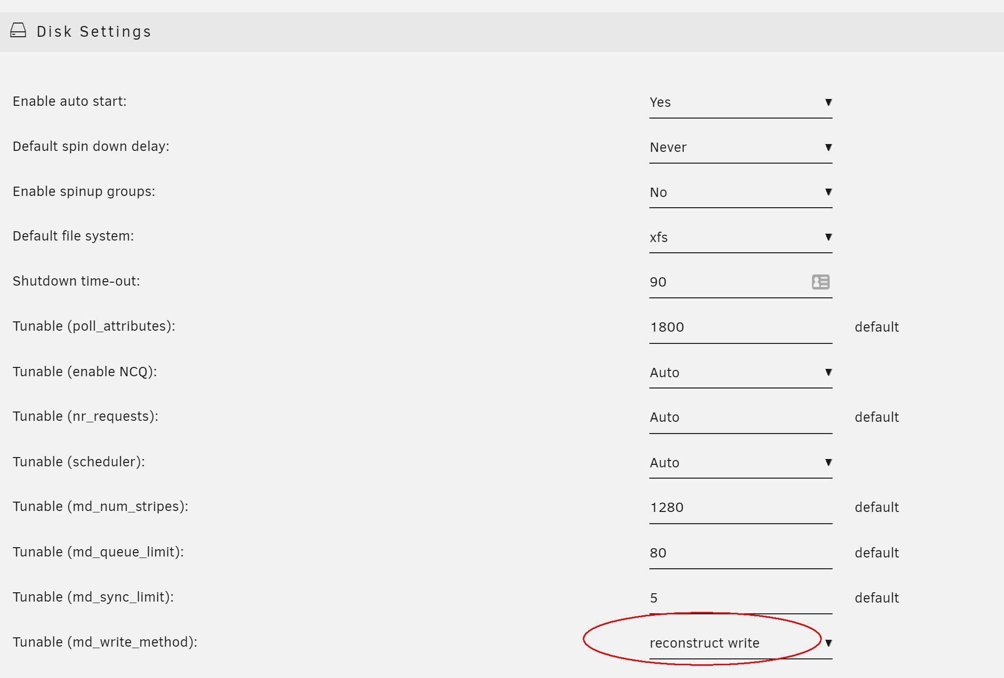

P.S: In the meantime I found out about Turbo Write a.k.a Reconstruct Write. So I enabled it. I suppose I should switch it back to Auto after I finish with copying at risk of having my whole array spinning all the time, right?

5 minutes ago, JorgeB said:
Did you enable turbo write?
If you meant this then yes. If not I would appreciate that you show me how.
Edited by xtrips
Realtime parity is the reason Unraid can't write array disks at the full speed of the disk being written. If you study that link about Turbo Write you will get a better idea of what is involved.
