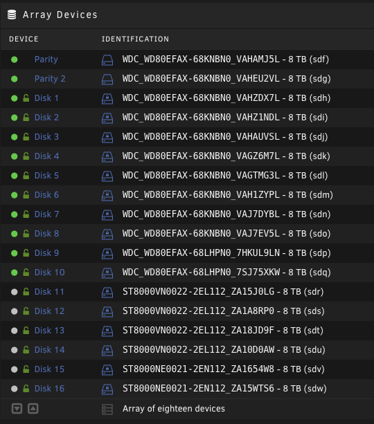

Hi guys,
I've been having issues on RC and now 6.9.
The issue seems to be that drives are not spinning up and this is causing them to go into disabled state if I reboot.
As a work around I was asked to spin up before I restart.
I just tried to spin up now and this is what I see:
WD drives are spinning up just fine.
If I click on a Seagate drive I see:
Mar 2 11:42:49 Odin kernel: mdcmd (15): import 14 sdu 64 7814026532 0 ST8000VN0022-2EL112_ZA10D0AW
Mar 2 11:42:49 Odin kernel: md: import disk14: (sdu) ST8000VN0022-2EL112_ZA10D0AW size: 7814026532
Mar 2 11:42:50 Odin emhttpd: read SMART /dev/sdu
Mar 3 06:04:55 Odin emhttpd: spinning down /dev/sdu
Mar 3 10:01:15 Odin emhttpd: spinning up /dev/sdu
Mar 3 10:01:33 Odin kernel: sd 1:0:19:0: [sdu] tag#3713 CDB: opcode=0x85 85 06 20 00 00 00 00 00 00 00 00 00 00 40 e3 00
If I click on the white dots to spin up I get this:
Disk 15 will not spin up at all.

There appear to be some issues since v6.9-rc with the LSI driver and 8TB Ironwolfs, possible different capacities also, not sure if it's any different with v6.9 final, but likely not.
Groovy!
Thanks for the update that would make sense.
Is this likely to be fixed via software/kernel in the future?
For now I'm just leaving my drives to stay spun up and not sleep, hopefully this should be a workable workaround?
Should be.
If you only have issues after spin up it should work.

Could I have you try the following the next time you see this happen, prior to reseating?
First find the host # for your scsi bus host # for the device:
root@sisyphus:~# ls -d /sys/class/scsi_host/host*
lrwxrwxrwx 1 root root 0 Mar  8 06:04 /sys/class/scsi_host/host6 -> ../../devices/pci0000:00/0000:00:11.5/ata6/host6/scsi_host/host6/
lrwxrwxrwx 1 root root 0 Mar  8 06:04 /sys/class/scsi_host/host5 -> ../../devices/pci0000:00/0000:00:11.5/ata5/host5/scsi_host/host5/
Then rescan, specifying the host number for the device per the output of the earlier command:
echo "- - -" > /sys/class/scsi_host/host5/scan
To limit the scan to only a single disk, specify it in place of the '-' marks
The above is kind of generic, but specific to UnRAID, you'd replace the '- - -' with the ID you find for the drive in tools->system devices if I'm remembering properly. Technically, there shouldn't be an issue running it directly as:
echo "- - -" > /sys/class/ (etc)
With any relatively modern hardware... But as a precaution, I'd recommend first stopping the array just in case. There used to be some issues with scanning an already active device, and while they were sorted out ages ago in code/fw, a little caution never hurt anyone.
The 'why' of trying the above - ironwolf drives seem to take an eternity (well, in computer terms anyway lol) to wake up from sleep/standby, especially as they age. The host is basically saying 'I give up, been waiting on you to get out of the bathroom for hours' and walking away, but doesn't go back to re-check down the line to see if the command ever actually did complete (unless you tell it to do so, which we're doing here).
If that give bupkis, try manually waking up the drive:
hddtemp -w /dev/sdu
Maybe an issue with the version of smartctl, or newer command instruction sets used which older drives don't recognize?
I'll be curious to hear the outcome!

Just happened again, when I needed to restart.
I forgot to do the steps above as this time it showed it as spun up but drive had no temp.
I assumed it was just missing one this one drive and then I restarted and boom it is disabled.
This is very annoying and I could really do with getting a fix.
Next week I'll try replicating with the step above.
