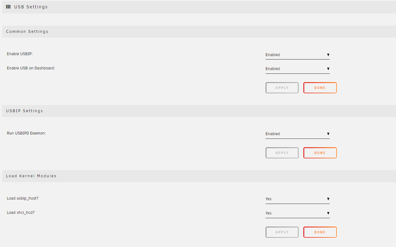

March 18, 20215 yr Author Hi, I just wanted to follow up again. I installed the usbip-gui plugin which said it needed usbip to run, but i did not see that as an installable community plugin. I found and then added the text to the /etc/libvirt/hooks/qemu configuration file and enabled USBIP, but even after doing that I get at the top "Following are missing or not loaded: usbip_host module vhci_hcd module" and then below on USB page under USBIP setting and load kernel modules it also says "The usbipd command missing or usbip_host module not loaded..", "The usbip_host module does not exist..", and "The vhci_hcd module does not exist.." I clearly am missing a step and something is not installed. I saw something mentioned in the comments about "The module is the kernel module usbip_host, I think initially limetech only included vhci_hcd and usbip_core. I guess it could be sideloaded with the new process but ideally it should be baked into standard modules if the other two are there already." which implied Limetech might have left something out? Just wanted to know how do I go about installing what needs to be installed. Is there some reference or page you could point me to? Thanks for your help
March 18, 20215 yr Community Expert 32 minutes ago, WorldTraveller said: which implied Limetech might have left something out? The plugin installs the USBIP components if required, but is only supported on 6.9. But I dont think you need the USBIP parts for your requirements, You can turn them off in the USB settings page. You may need to change Enable USBIP to see the other parts, but the load kernel modules should be No and Run Daemon should be disabled. Then change Enable USBIP back to disabled and those messages should be hidden.

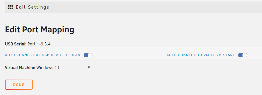

December 26, 20214 yr Community Expert 1 hour ago, PicPoc said: I use USBIP, nice program. Me too, with my KVM hardware, I wanted to automatic plug USB & Mouse whenb I switch between different VMs. Any solution to automoatic assign 1 USB Keyboard & Mouse ? Thanks Do you have a separate usb connection for K&M for each VM. You can create a port mapping to allocate the port to each VM on my plugin. Port will be auto connected when a device is connected.

January 3, 20224 yr Community Expert 6 minutes ago, M2Pilot said: KBD and Mouse are dead. The reason is when usb devices get unplugged and replugged the dev number will change. My plugin detect the device being commected and will map the ports to the VM. You need to remove the mappings in the vm template.

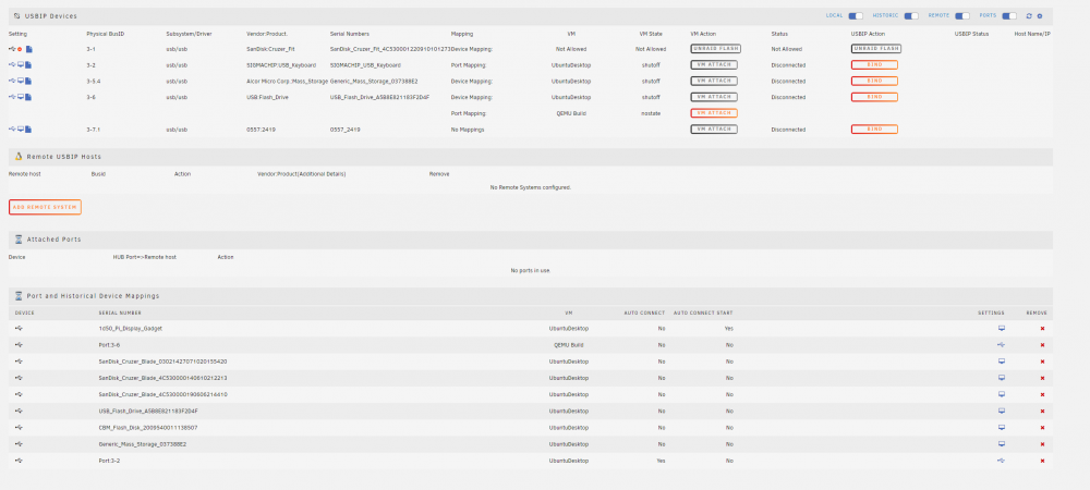

January 3, 20224 yr Alas, using the USBIP plugin does not immediately solve the problem. But does seem to give a hint what the problem is. See the attached screen shot. Note the error reported for both the keyboard and mouse. Who might I report this to??
January 3, 20224 yr Community Expert If you hover over the triangle it will tell you the error. I suspect it already in use and was mapped outside the USB Manager plugin. Edited January 3, 20224 yr by SimonF
