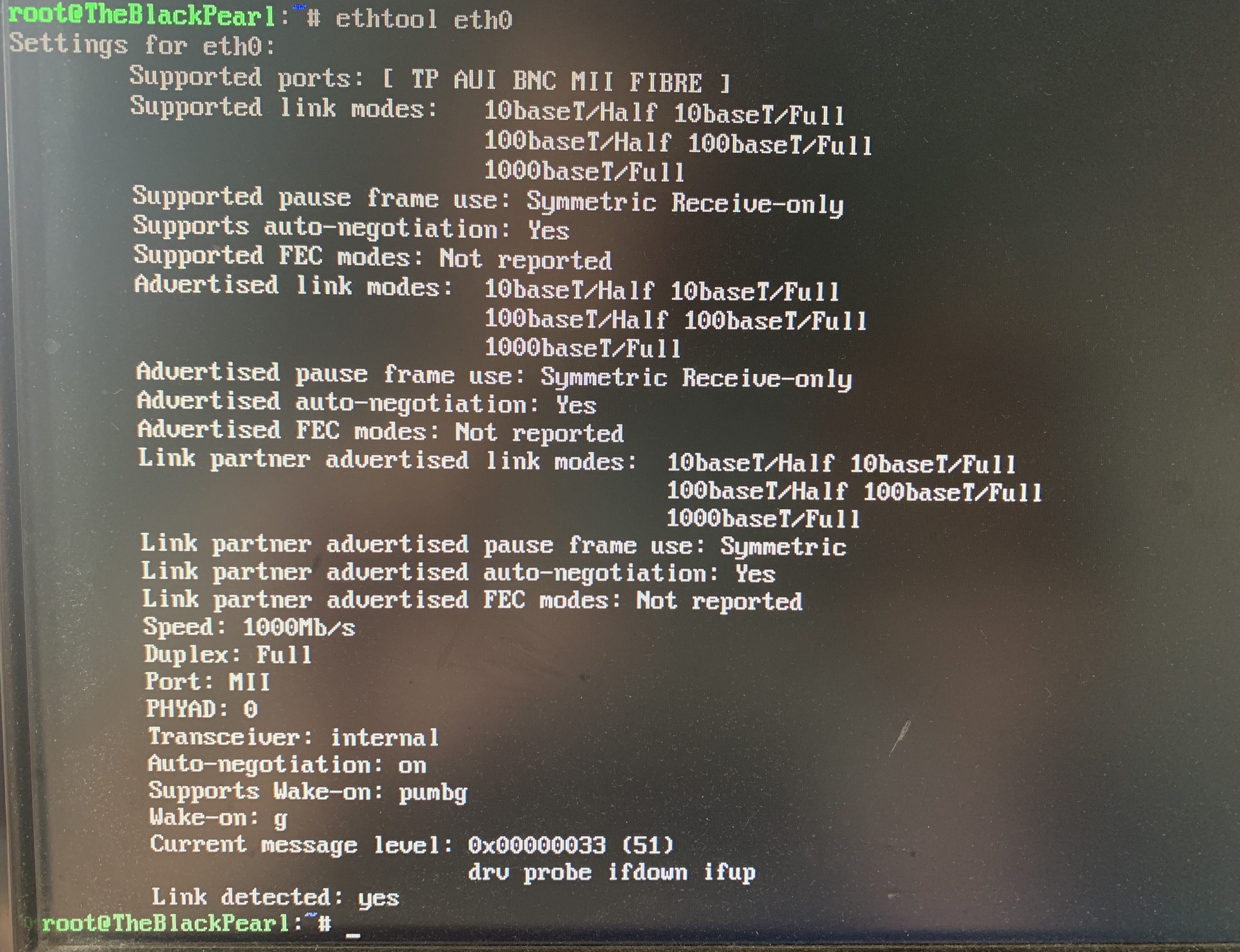

What do you get with this when the problem occurs?
ethtool eth0
Thank you.
Had to reboot twice to get it to not work. This picture was taken when the network was NOT working.
