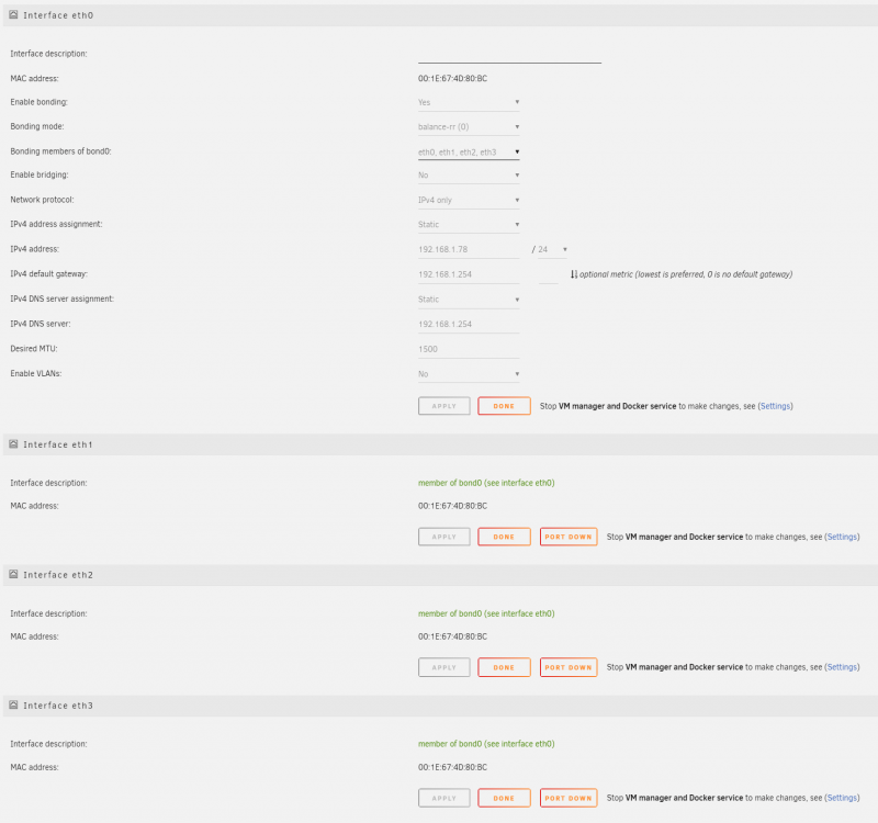

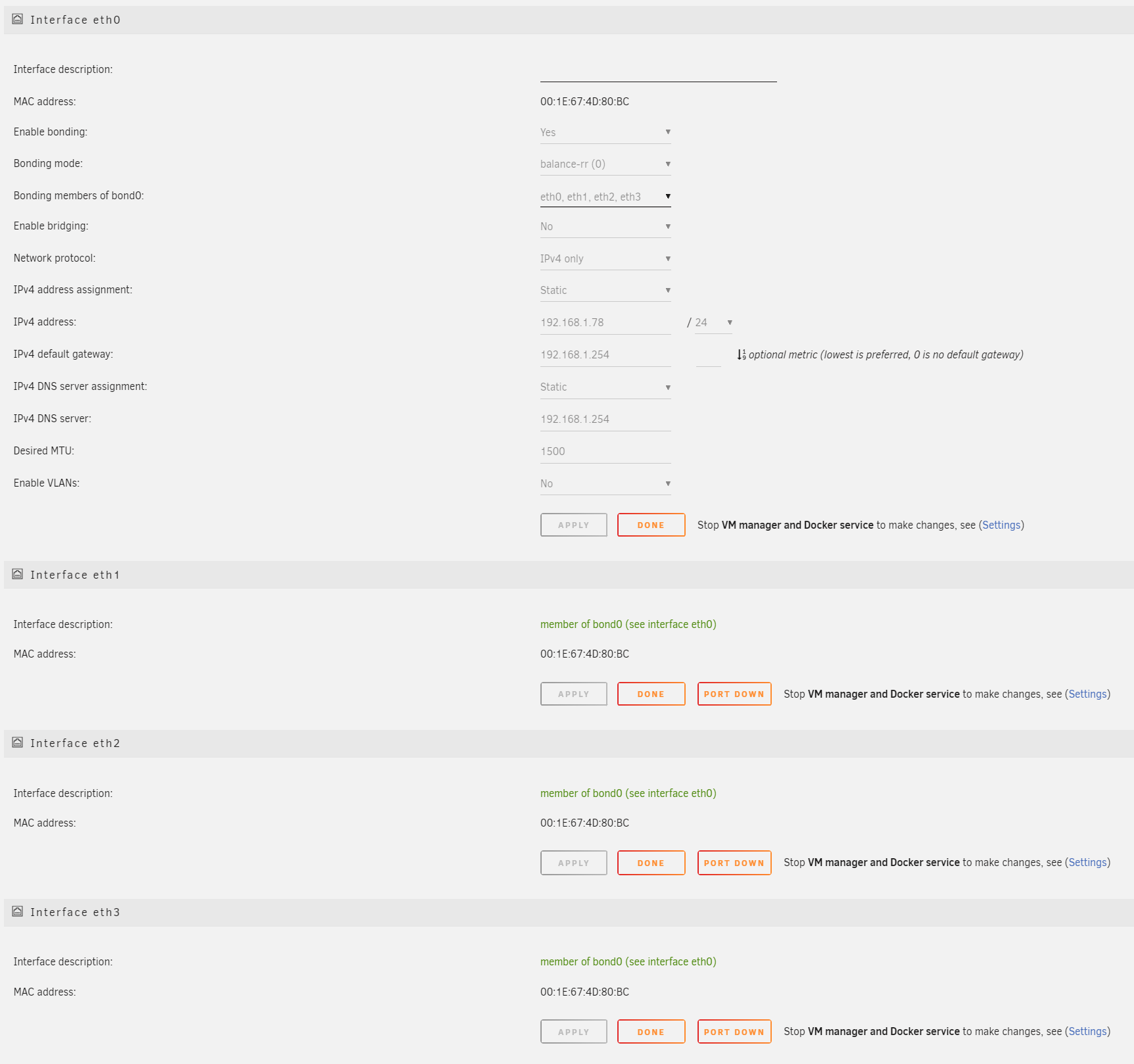

- Server has quad-gigabit NICs onboard, these are set to balance-rr in network settings.

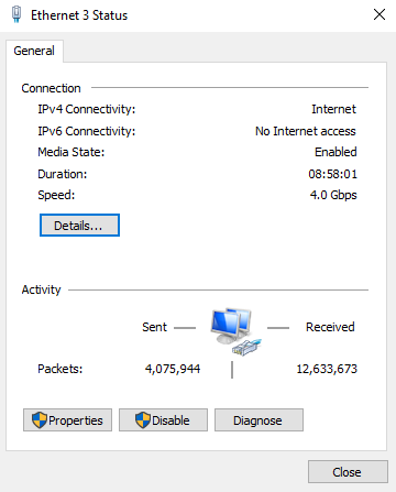

- PC has an Intel I350 based quad-gigabit NIC installed, with link aggregation setup through the Intel PROSet Adapter Configuration Utility. I can verify through Windows Network and Sharing Centre that the link speed is 4Gbps.
