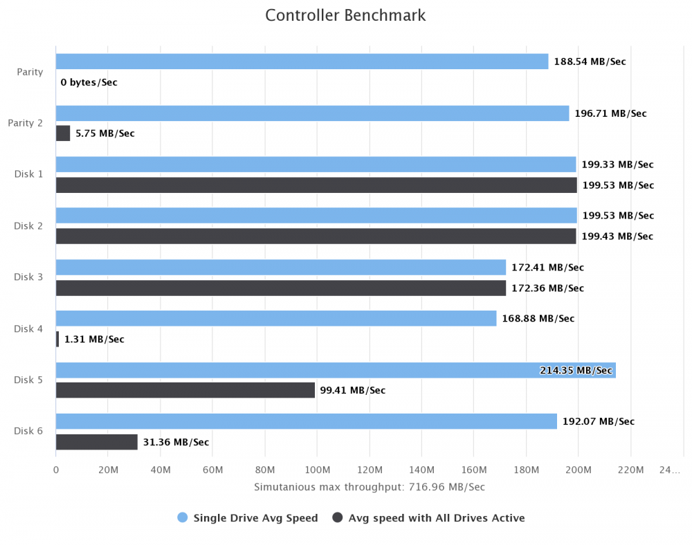

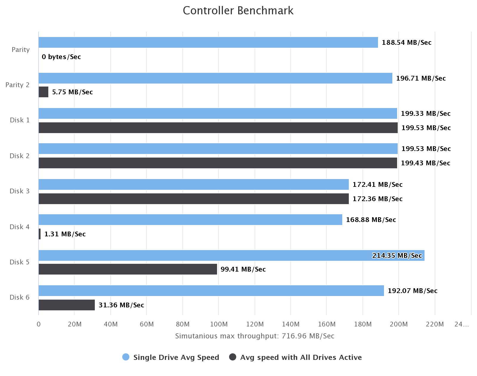

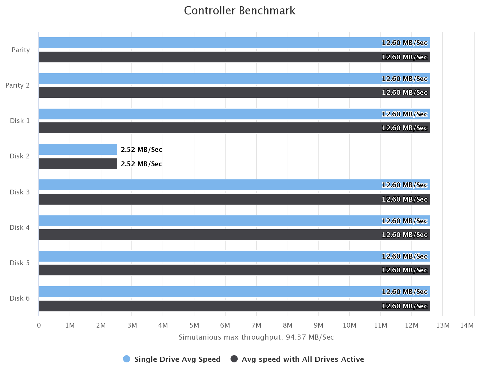

Since then I have had very poor disk speeds, sometimes fixxed by rebooting the server, hanging when starting/stopping the array, and unclean shutdowns when using the reboot button. I ran a benchmark of my controller with diskspeed with just the 1 docker running in safe mode.
It looks like all the disks are being throttled, except disk 2 which is doing its own thing.....

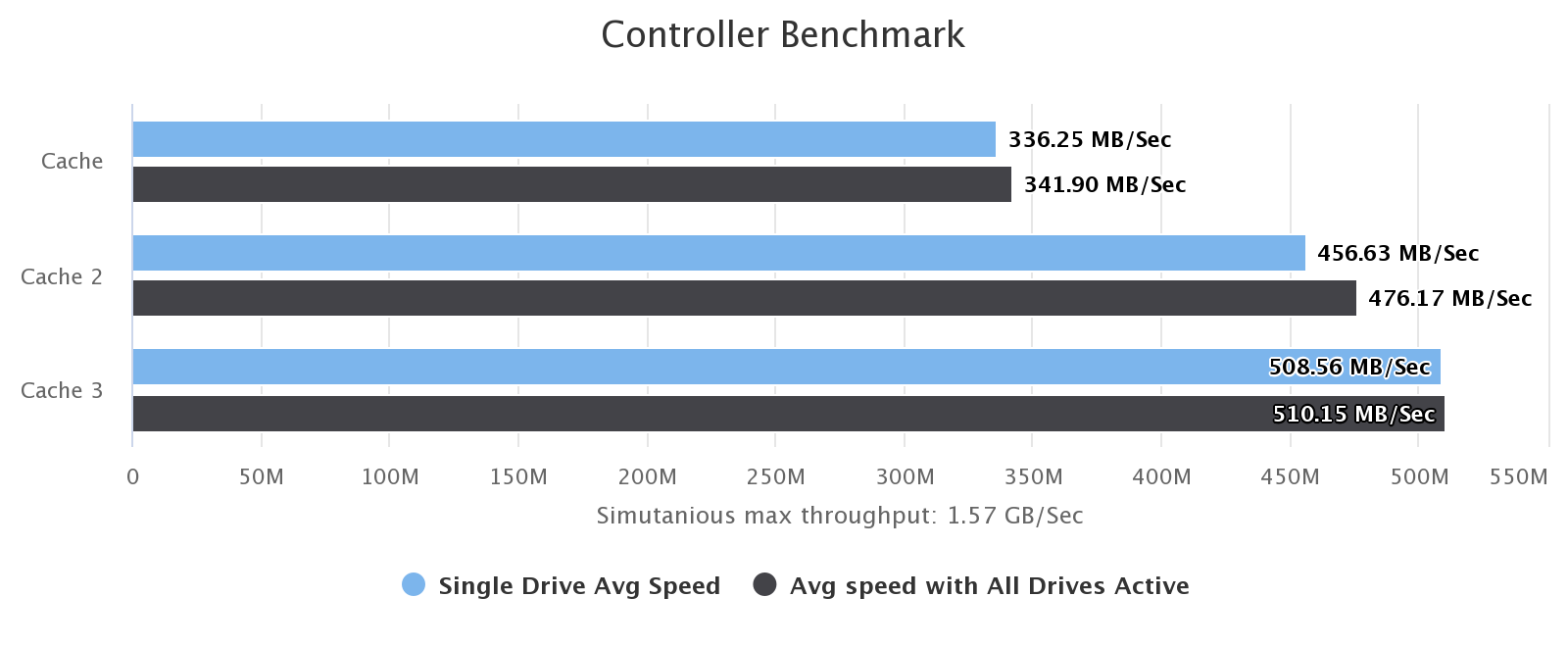

I benchmarked my ssds which are on another controller
Which seems fine, although i plan to replace all of them once I get these other disks straightened out.

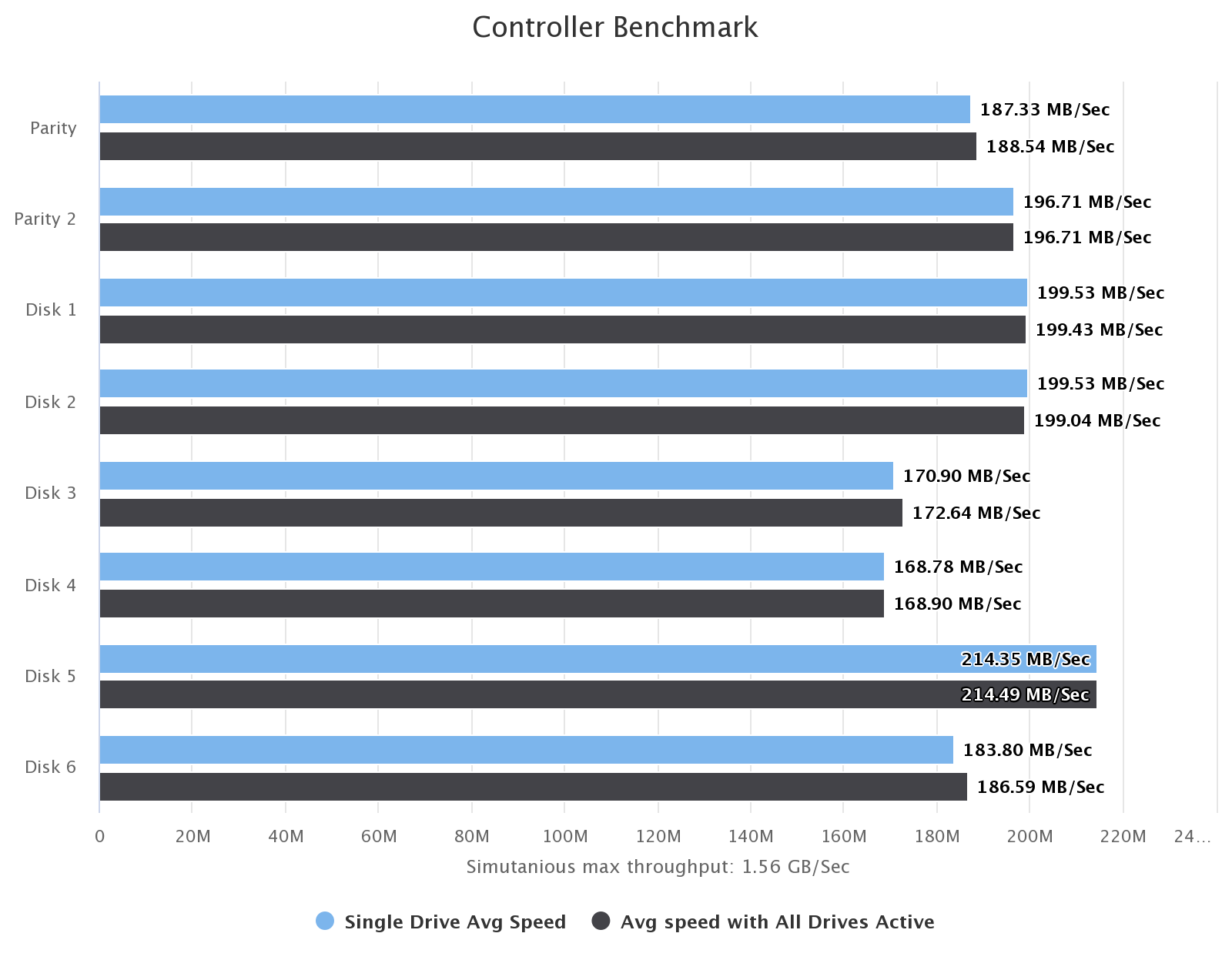

Rebooted server out of safe mode and re-ran controller benchmark
and the cache drives didnt change at all.

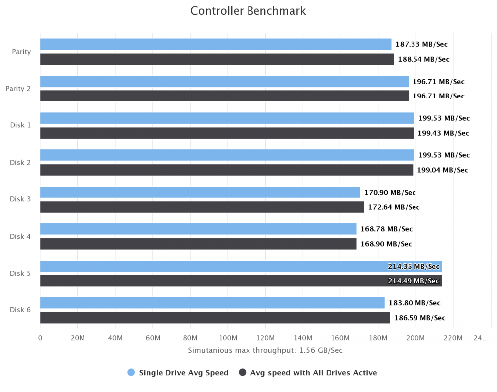

Installed my LSI 9300-8i and it did wonders!
Havent had any issues with the array since installed! TY @JorgeB
