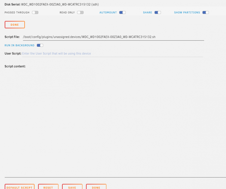

I am trying to figure it out but I am having issues.
I have the hdd mounted in the screenshots but I did also try the same steps while it was unmounted.

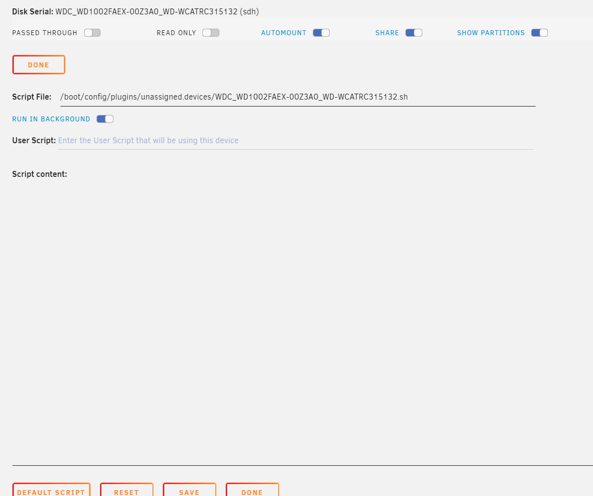

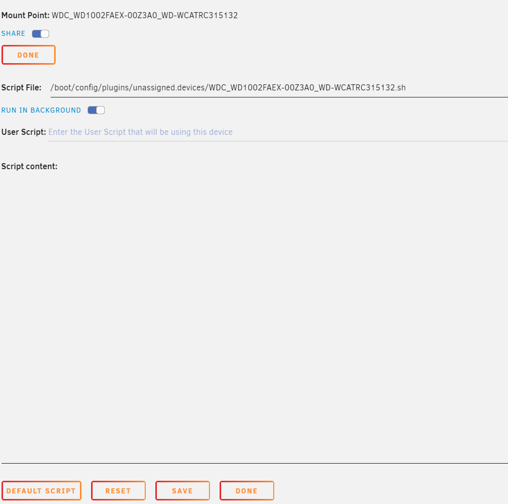

I turned on the share option:

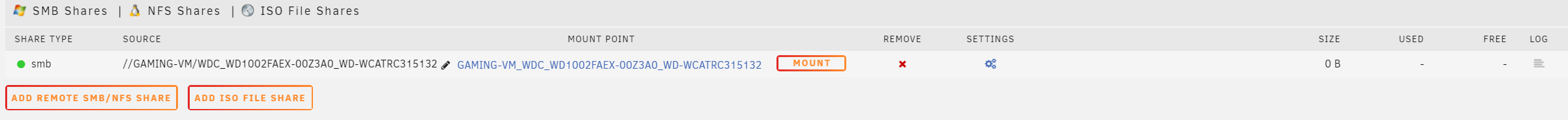

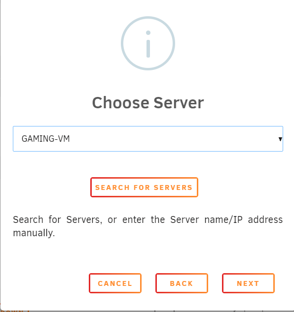

Then I created a smb share:
Gave it no username, password or domain. But did also try with username and password.

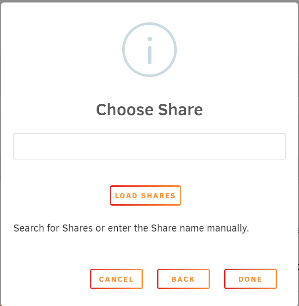

Then it asks me for the share:
The "Load shares" button does not give me a result.
I also do not know the name of the created share. I did put in the hdd name but that only gave me an unmountable share that my Windows vm does not see:
