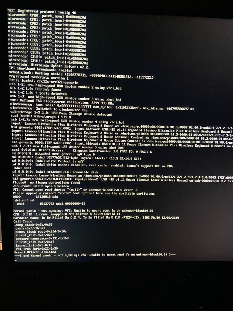

Alright - so I tried upgrading to 6.9, but I get a nice kernel panic . I tried also manually copying the bz* files to the boot pendrive, same issue.
Should I start a new thread about the system not booting or I can continue on this one?
That is usually a flash drive problem, try redoing it, back up current flash, redo using the UBS tool, restore config folder.
I feel so dumb now.
Recreated the drive and copied the config folder - works fine. I will update in a few days if the issue with the disks go away
