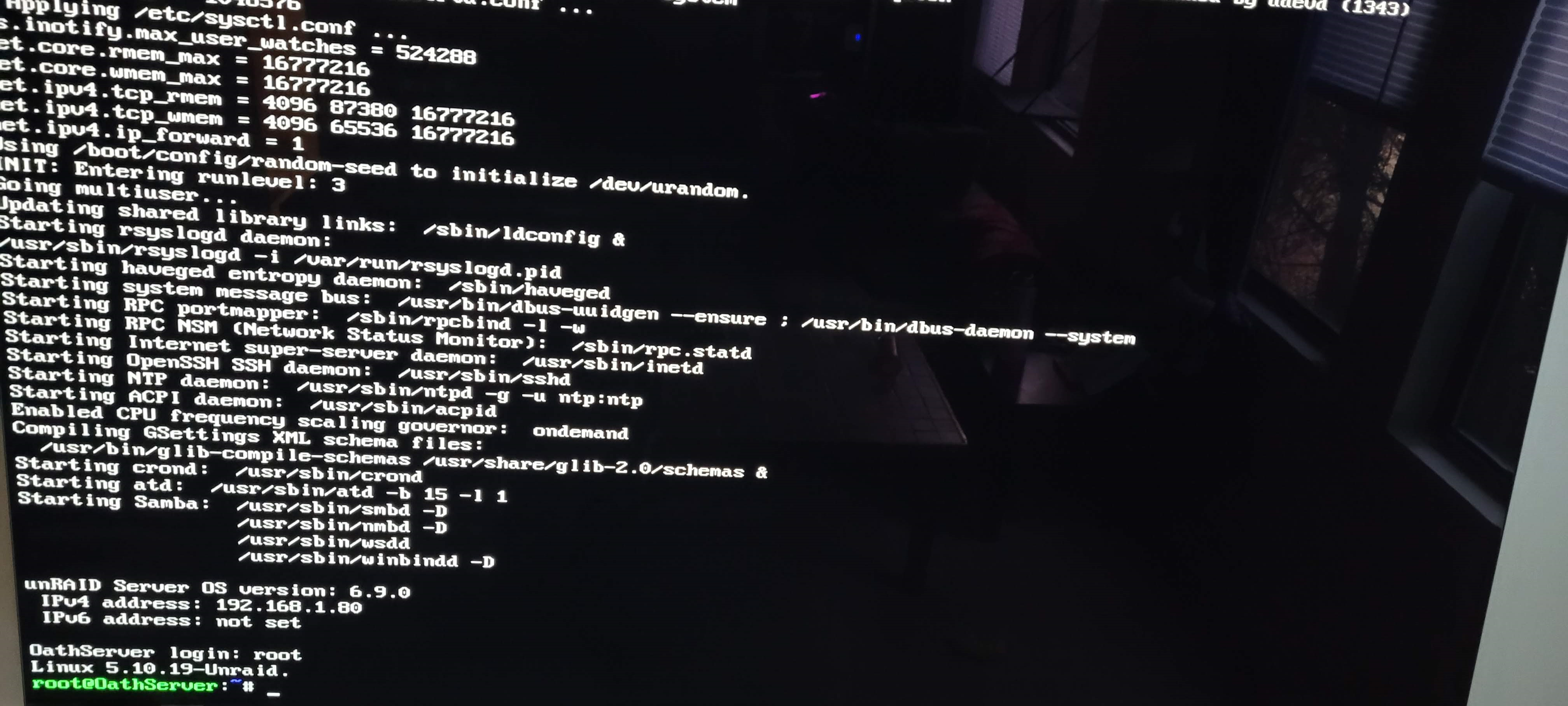

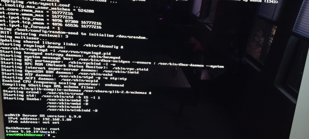

Hi all I'm new to UNRAID and have been having issues with my server since day 1. Since I started using UNRAID Ive been having this weird issue where I suddenly cant connect via HTTPS://ServerName or HTTPS://Ip.Address or by attempting to boot into GUI mode (all I get is a black screen with a cursor in the upper left). I thought it was my router or the network switch I have hooked up but swapping both out didn't help this issue (plus I have many other devices working without issues). Of note is that when I cant access it, it vanishes from my router interface as well. I have tried using both a network add in card and the built in NIC both with the same exact results.
Despite this when I log into the server via cmd it shows that it has a valid static IP Address on my subnet and gateway. However previously deleting the network.cfg file and then rebooting would always bring it back, a pain in the rear but nothing crazy. However I cant get it back today by doing that. I just attempted reinstalling unraid (backing up my config folder) but even that isn't working. I'm still seeing the same behavior.
Ive gone ahead and attached my diga output.
Booting normally:
Booting to GUI:
Any help would be much appreciated as Im missing my plex already!!
oathserver-diagnostics-20210304-1642.zip

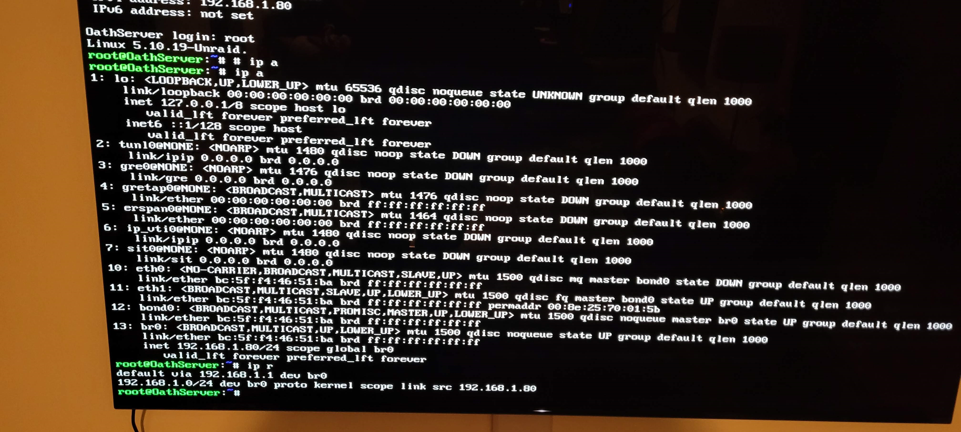

Hi Drackeo,
Something is definitely amiss with your network. If possible, it would be useful to try the following things.
1. from the unraid cli - can you ping the gateway? Hopefully you get something back.
# ping 192.168.1.1
2. Can you send the output of two commands? First shows all the interfaces, and the second will show your routing.
# ip a
# ip r
Post that information and we might be able to figure out what's going on.
Hope this helps,
Del
7 minutes ago, Delarius said:
Hi Drackeo,
# ping 192.168.1.1
# ip a
# ip r
Hope this helps,
Del

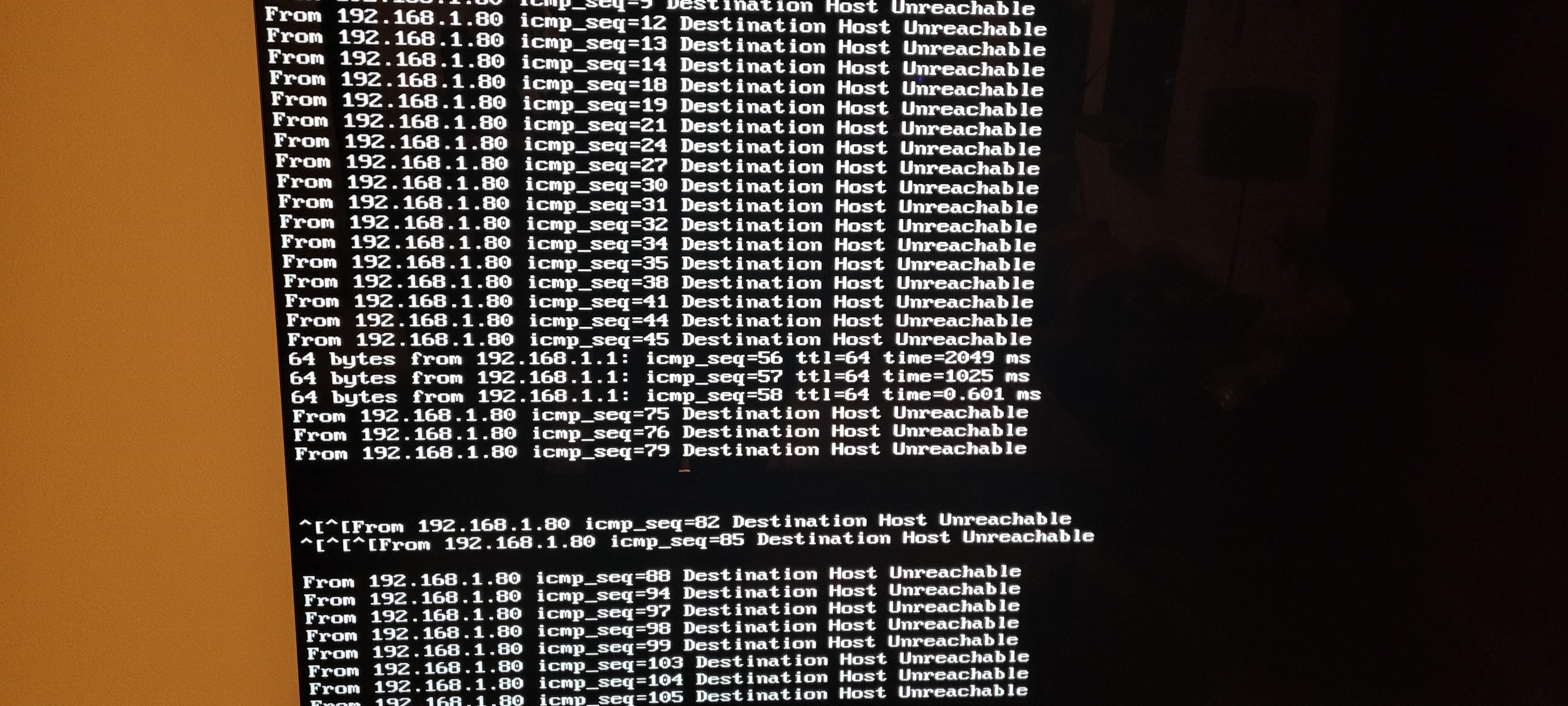

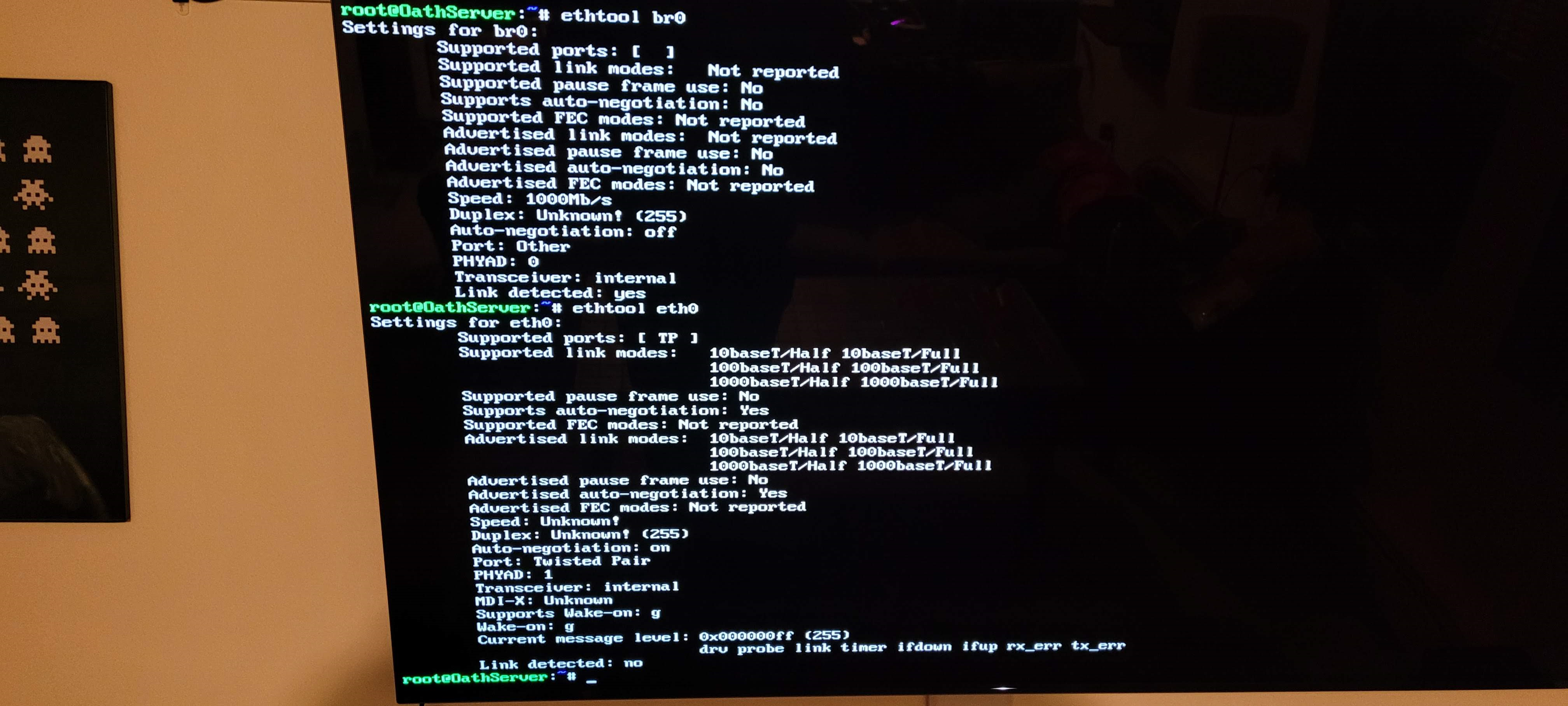

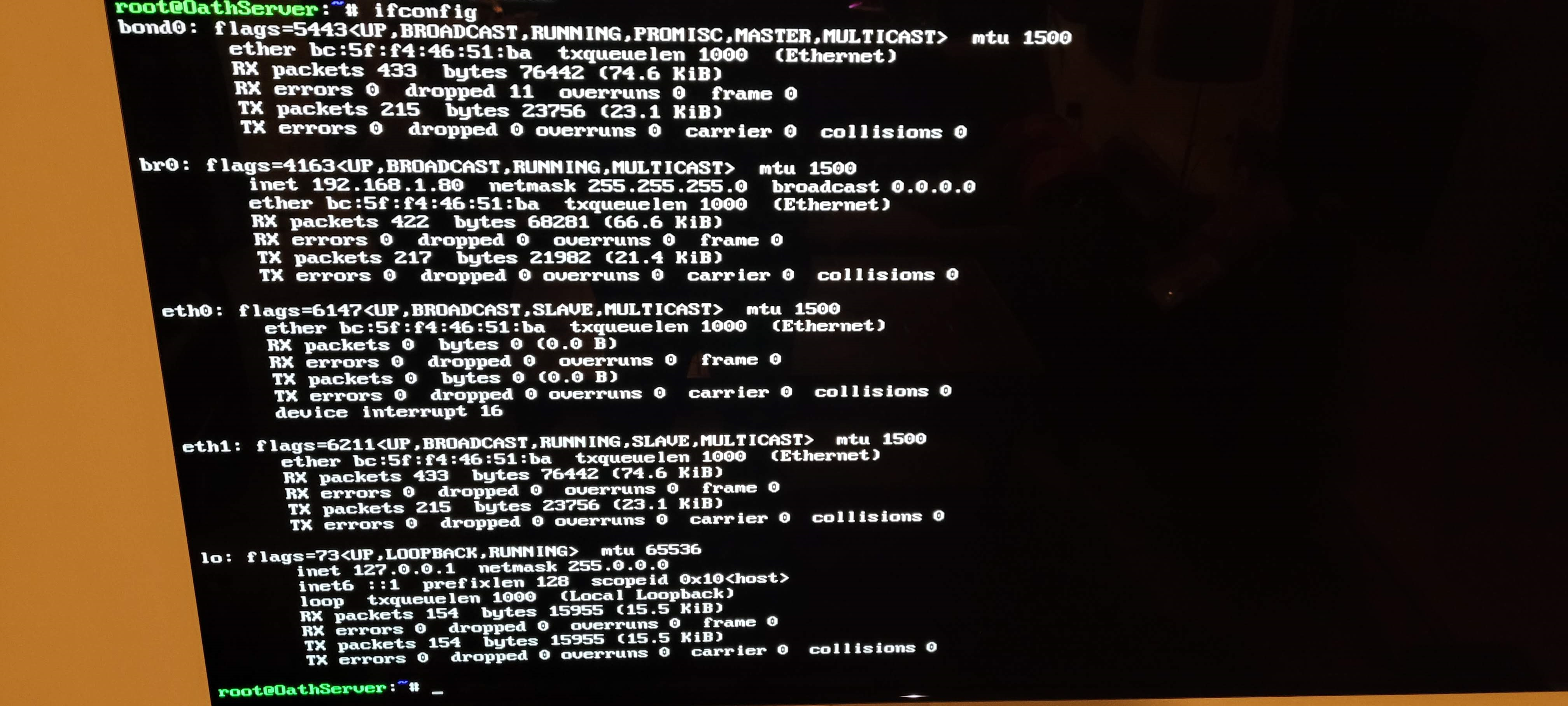

Heres the output of all the commands:
ping 192.168.1.1
ip a / ip r
ifconfig
ethtool br0 / ethtool eth0
18 minutes ago, Vr2Io said:
It still look like it is your network issue, seems some blocking between. You use static IP, as you mention you have many device, pls simple try other IP because same IP could be use by others.
For local GUI blank screen issue, this quite common, you should try enable CSM or CSM+UEFI if you boot in UEFI mode.
So CSM is already enabled on my motherboard so is UEFI support. PC specs here: https://pcpartpicker.com/list/kh4dcT

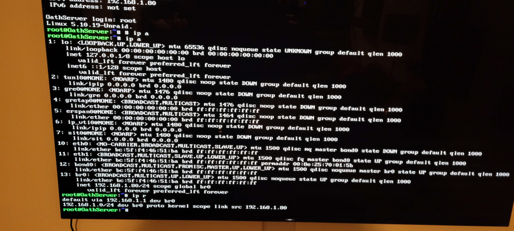

Thanks, that's good information. To me, it looks like the bridging/bonding part isn't quite right, note how a few pings went through, but in ifconfig we see that eth0 appears down?
I suggest, just for troubleshooting, test out a variation on my network.cfg
So, make a backup of network.cfg (we can just move it for now)
# mv /boot/config/network.cfg /boot/config/network.cfg.Mar42021.bak
then
make a new file at /boot/config/network.cfg with your favorite editor (vi, nano, pico, whatever). Might be easiest to shutdown - copy the file using another computer to the usb stick and then try restarting with this config file.
Another thing you might try that is very easy - see what turning off bonding in your config file does? Then see if you get network on either of your network ports by pinging and unplugging the cable.

So I do have a 2.5 gig ethernet card plugged in at the moment. How can I determine if that or the onboad nic is eth0 or eth1?
At the CLI type:  ethtool --identify eth0
That should cause the lights on the eth0 network interface to blink.
Note: you will need to Ctrl-C to halt this.
Edited by Hoopster

So thanks to Hoopster I was able to figure out that eth0 is my nic and eth1 is the pcie card. Ive gone ahead and applied your config as the network.cfg and still no luck :( Im seeing the exact same behavior as before when I re-ran all of the commands.
