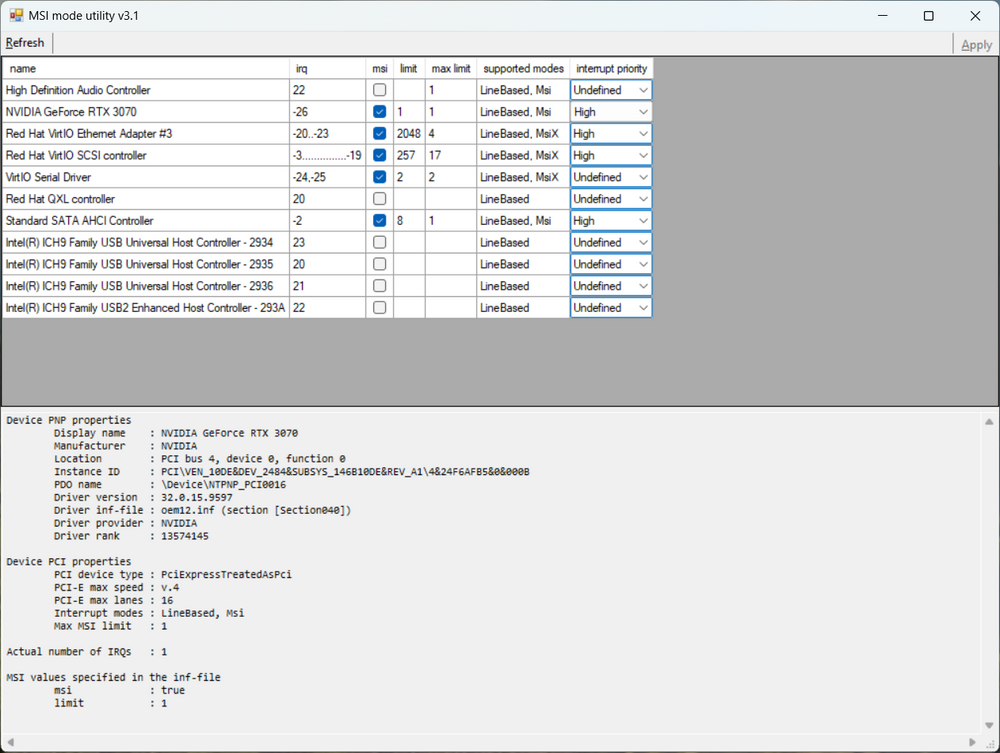

Running MSI Mode Utility and making sure MSI is marked and all values are set to high fixed my sluggish Windows 11 VM Performance in Unraid 7.2.2.
It's so much faster.
Got the idea from here: GPU Passthrough doesnt work after Updating to unRAID 6.9 - Page 2 - VM Engine (KVM) - Unraid
Which has a link to this in the official unraid docs: Windows on a VM | Unraid Docs
The key is making the priority set to HIGH, my graphics card was set to undefined and everything was so slow. Click windows explorer would take like 10 seconds to load.
This completely fixed it.
Been looking for a solution to this for a long time!
One Caveat is I think you have to do this each time (set priority to high) after new nvidia driver installs.
