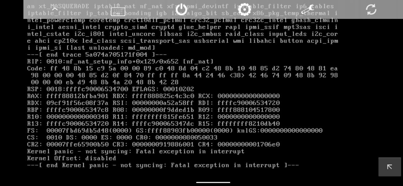

So I was doing the unassign/replace method of fixing the high cache writes in 6.9.0 stable and I had removed the first of two disks, rebalance was fine, then I added it back, and during a rebalance I got a kernel panic.
IPMI shows this.
Anonymized diags attached.
Does anyone know what actually happend here.

Is there any way to glean more info on what caused the kernel panic? And also what the execution error of that container is?
Thanks in advance, much appreciated!
Sorry, no.
