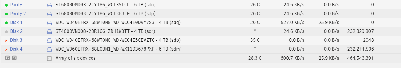

big trouble with my array
hello,
here what i see on my unraid server.
i can connect with ssh. Vm are still working and so are dockers. But i can't access any of the tools or settings.
what should i do now ?
when accessing syslog with terminal i see nothing as it's flooded with read and write errors

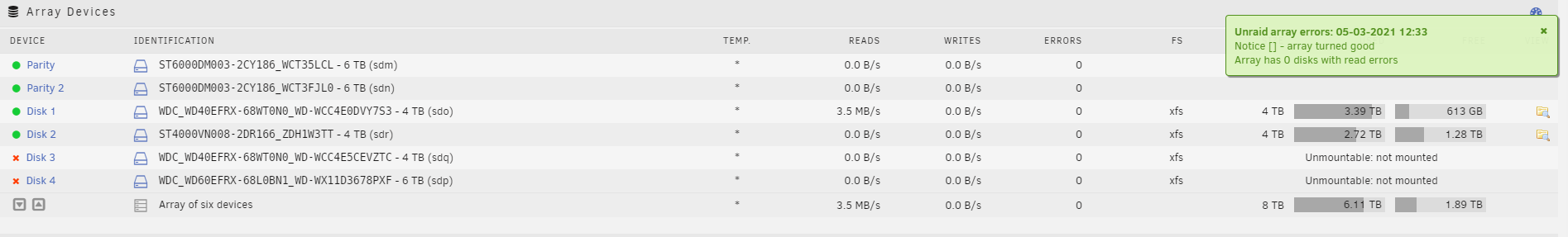

There is no SMART information for disk3 or disk4 in the diagnostics so I suspect that they have dropped offline and a power-cycle may be required to get them back online.   Might be worth waiting to see if @JorgeB has a view as the expert in these matters.
Looks like a problem with the Intel SCU controller, please power/cycle the server and post new diags, after array start.
ok, thank you. Will do that.
Disk3 is showing a pending sector, you should run an extended SMART test, disk4 looks OK.
Also need to run a filesystem check on the emulated disks 3 and 4.

it's file system check on disk 4
how to mount it ?

ran with -L option and another time with -n (result above)
stop array and restart in maintenance mode but still unmoutable.

It seems like i'll loose data on disk 3 and 4.
Disk4 should mount, please post new diags after array start, for disk3 on the other hand you'll likely need to use the old disk, even if it's failing.

As expected disk4 is now mounting, if contents look correct you can rebuild on top of the old disk, also try to run xfs_repair again on disk3.
rebuild is running but it's quite slow (max 90MB/S).

I let rebuild run and now disk 4 is back on line. 😀

  ER -- ST COUNT  LBA_48  LH LM LL DV DC
  40 -- 51 00 00 00 01 63 08 a4 00 40 00  Error: UNC at LBA = 0x16308a400 = 5956477952
  Commands leading to the command that caused the error were:
  CR FEATR COUNT  LBA_48  LH LM LL DV DC  Powered_Up_Time  Command/Feature_Name
  60 04 00 00 10 00 01 63 08 d7 90 40 08 20d+20:37:23.428  READ FPDMA QUEUED
  60 04 00 00 08 00 01 63 08 d3 90 40 08 20d+20:37:23.423  READ FPDMA QUEUED
  60 04 00 00 00 00 01 63 08 cf 90 40 08 20d+20:37:23.417  READ FPDMA QUEUED
  60 01 b8 00 f8 00 01 63 08 cd d8 40 08 20d+20:37:23.412  READ FPDMA QUEUED
  60 02 48 00 f0 00 01 63 08 cb 90 40 08 20d+20:37:23.406  READ FPDMA QUEUED
Error 1 [0] occurred at disk power-on lifetime: 13337 hours (555 days + 17 hours)
  When the command that caused the error occurred, the device was active or idle.
  After command completion occurred, registers were:
  60 04 00 00 88 00 01 63 08 bb 90 40 08 20d+20:36:53.198  READ FPDMA QUEUED
  60 04 00 00 80 00 01 63 08 b7 90 40 08 20d+20:36:53.193  READ FPDMA QUEUED
  60 01 b8 00 78 00 01 63 08 b5 d8 40 08 20d+20:36:53.187  READ FPDMA QUEUED
  60 02 48 00 70 00 01 63 08 b3 90 40 08 20d+20:36:53.182  READ FPDMA QUEUED
  60 04 00 00 68 00 01 63 08 af 90 40 08 20d+20:36:53.180  READ FPDMA QUEUED
SMART Extended Self-test Log Version: 1 (1 sectors)
Num  Test_Description    Status                  Remaining  LifeTime(hours)  LBA_of_first_error
# 1  Extended offline    Completed: read failure       20%     13353         5956477952
# 2  Extended offline    Interrupted (host reset)      90%     13346         -
# 3  Extended offline    Interrupted (host reset)      70%     13346         -
# 4  Short offline       Completed without error       00%     12747         -
SMART Selective self-test log data structure revision number 1
 SPAN  MIN_LBA  MAX_LBA  CURRENT_TEST_STATUS
    1        0        0  Not_testing
    2        0        0  Not_testing
    3        0        0  Not_testing
    4        0        0  Not_testing
    5        0        0  Not_testing
Selective self-test flags (0x0):
  After scanning selected spans, do NOT read-scan remainder of disk.
If Selective self-test is pending on power-up, resume after 0 minute delay.
SCT Status Version:                  3
SCT Version (vendor specific):       258 (0x0102)
Device State:                        Active (0)
Current Temperature:                    32 Celsius
Power Cycle Min/Max Temperature:     14/36 Celsius
Lifetime    Min/Max Temperature:     14/45 Celsius
Under/Over Temperature Limit Count:   0/0
Vendor specific:
01 00 00 00 00 00 00 00 00 00 00 00 00 00 00 00
00 00 00 00 00 00 00 00 00 00 00 00 00 00 00 00
SCT Temperature History Version:     2
Temperature Sampling Period:         1 minute
Temperature Logging Interval:        1 minute
Min/Max recommended Temperature:      0/60 Celsius
Min/Max Temperature Limit:           -41/85 Celsius
Temperature History Size (Index):    478 (305)
Index    Estimated Time   Temperature Celsius
 306    2021-03-06 09:03    31  ************
 ...    ..( 56 skipped).    ..  ************
 363    2021-03-06 10:00    31  ************
 364    2021-03-06 10:01    32  *************
 ...    ..( 97 skipped).    ..  *************
 462    2021-03-06 11:39    32  *************
 463    2021-03-06 11:40    31  ************
 ...    ..(319 skipped).    ..  ************
 305    2021-03-06 17:00    31  ************
SCT Error Recovery Control:
           Read:     70 (7.0 seconds)
          Write:     70 (7.0 seconds)
Device Statistics (GP/SMART Log 0x04) not supported
Pending Defects log (GP Log 0x0c) not supported
SATA Phy Event Counters (GP Log 0x11)
ID      Size     Value  Description
0x0001  2            0  Command failed due to ICRC error
0x0002  2            0  R_ERR response for data FIS
0x0003  2            0  R_ERR response for device-to-host data FIS
0x0004  2            0  R_ERR response for host-to-device data FIS
0x0005  2            0  R_ERR response for non-data FIS
0x0006  2            0  R_ERR response for device-to-host non-data FIS
0x0007  2            0  R_ERR response for host-to-device non-data FIS
0x0008  2            0  Device-to-host non-data FIS retries
0x0009  2          855  Transition from drive PhyRdy to drive PhyNRdy
0x000a  2           19  Device-to-host register FISes sent due to a COMRESET
0x000b  2            0  CRC errors within host-to-device FIS
0x000f  2            0  R_ERR response for host-to-device data FIS, CRC
0x0012  2            0  R_ERR response for host-to-device non-data FIS, CRC
0x8000  4      1925892  Vendor specific
So despite the disk has less than 14OOOhrs it seems it has to be changed.
Now i will bring my array offline to try to repair disk3 filesystem.
