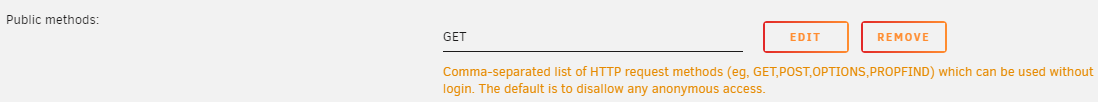

Access files without login
If you like to allow guests (without login) to download files, you can add "GET" as a public method:

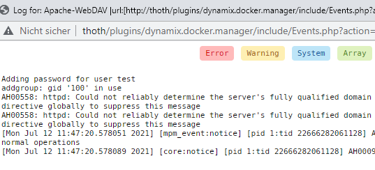

When I try to start the container it immediately stops after creating the username and privkey.pem with this error:
httpd: Syntax error on line 159 of /usr/local/apache2/conf/httpd.conf: Cannot load modules/mod_ssl.so into server: Error relocating /usr/local/apache2/modules/mod_ssl.so: SSL_CTX_set_post_handshake_auth: symbol not found
Enable SSL is set to selfsigned

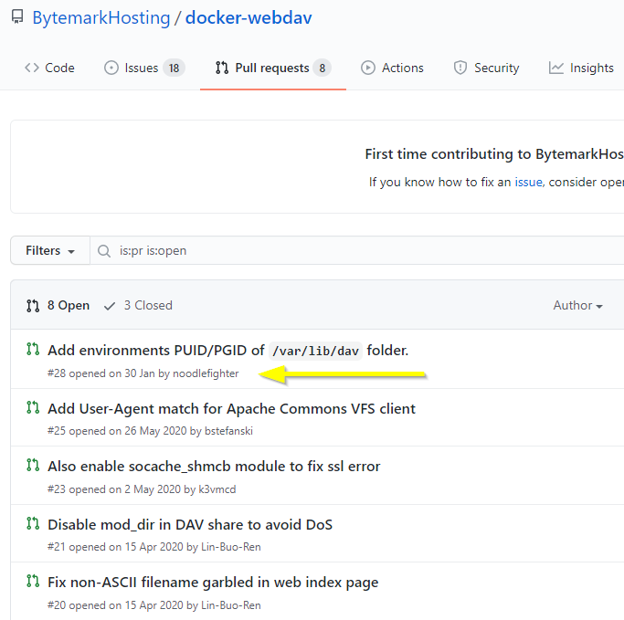

This happens because this container uses different user / group ids for the files than the Unraid defaults. It was a bad decision from me to use this container. The same is valid for @kennymc.c chosen container. I think I will update the template and use this one in the next release:
https://github.com/noodlefighter/docker-webdav
He was the last user who posted an udpate (pull request) for bytemark's container:
https://github.com/BytemarkHosting/docker-webdav/pulls
Ok, I found a docker container which uses noodlefighter's last pull request:
https://hub.docker.com/r/shouya/docker-webdav
I updated the Unraid template accordingly. It should be online in the Unraid Apps in around 2 hours. It should support SSL certificates and set correct UID and GID for uploaded files.

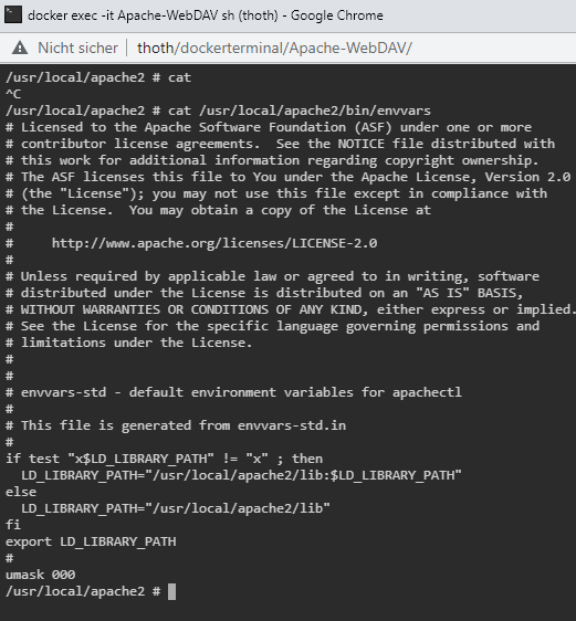

@ich777
I've added a path as follows:
I added "umask 000" to the envvars file. I checked it inside the container and it has the correct content:
But after deleting and re-uploading a file through Filezilla (WebDAV) it still has 644:
And its the only envvars file in this container 🤷‍♂️
The default umask of the terminal is still 0022 as well:
I've tried to set umask through a shell command, but it has no effect:
Test:
It seems only be possible through the docker-entrypoint.sh. Is it possible to change / add something to this file without being the container maintainer?
