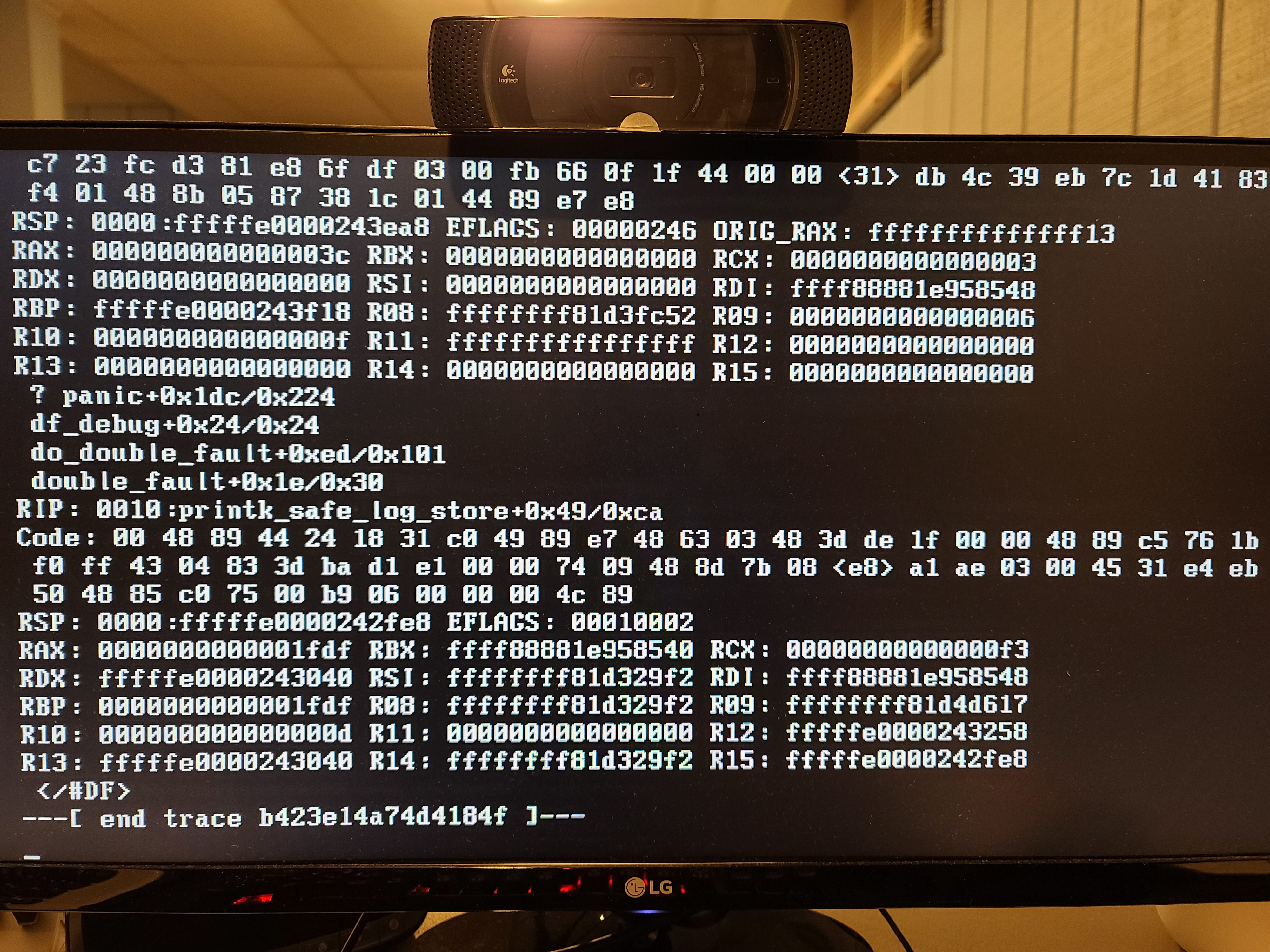

hi There I've an update. Unfortnately the problem is getting worse. The issue now the system is in a costant crash loop. Unraid would start up and in 5-10 minutes the system would crash and restart. I was able to pull down the diagnotics. I've not yet created a new USB flashdrive as I am not able to keep the system long enough to even pull a backup. I do have a older backup 2 weeks back that I will try to restore. However this backup was captured during the initial issue not before this issue first began.
If anyone can help me it would greatly appreciate it.  Any troubleshooting steps would help me out alot. Im little lost now.

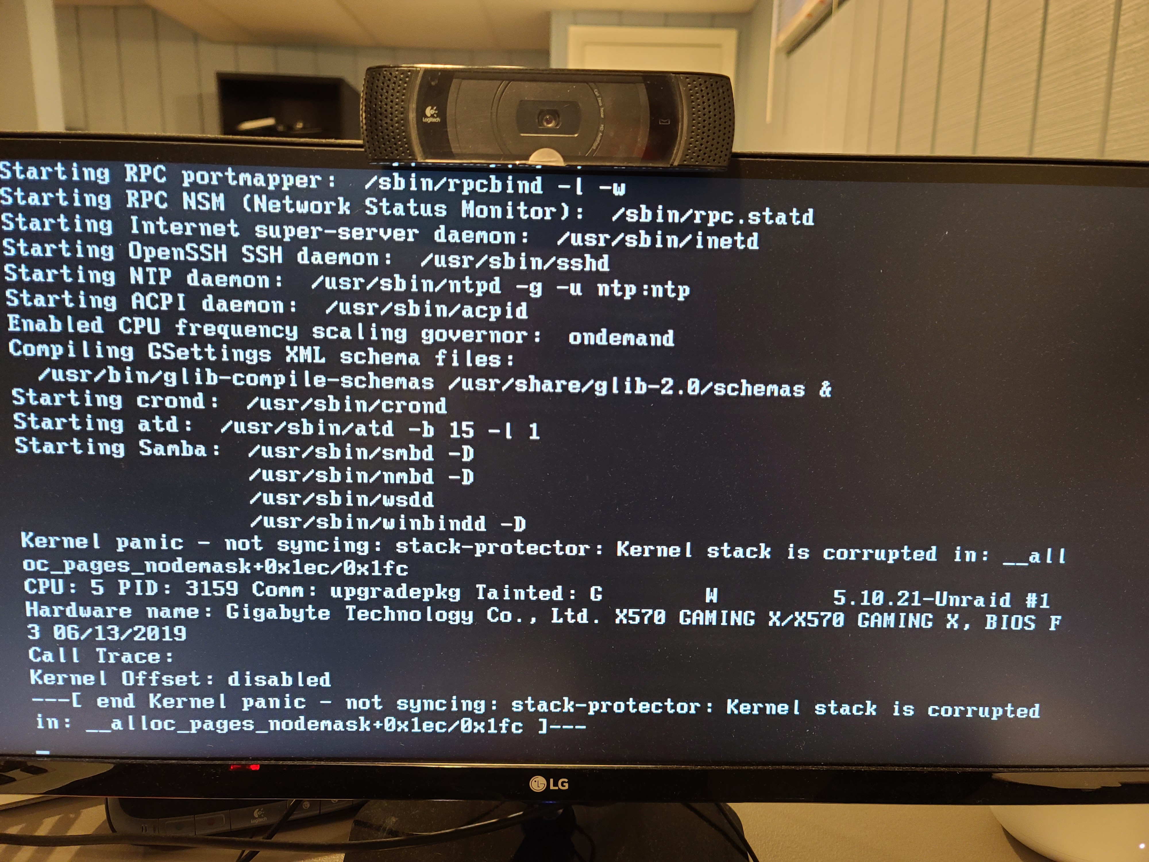

@trurl want to give an update. I've replaced my usb flash drive and rebuilt the flashdrive following instructions. New Install of UNRAID 6.9.1 and copied all content from config folder to new drive. The configuration transferred over however upon starting up array to starting Parity Check the system would crash and reboot again. I was monitoring the syslog however at point of crash there were no error captured.
I've done a couple things afterward hoping to isolate the problem listed them in order and results
  1. rebuilt new flashdrive with previous version 6.8.3 copying over config file
    1. result configuration was recognized. Upon starting up array and starting Parity Check the system would crash and reboot. same symptom
  2. made BIO Configuration change suggested by @John_M Help me identify the setting on my mobo to set Power setting to "Typical Current Idle"
    1. results boot up to UNRAID was same as step 1. This time I did not let array start up just let the system stabilize before enabling more features. about 1-2 hours later the system would crash and reboot again.
  3. upgraded BIOS. The current version running is initial release (F3 of Gigabyte x570 mobo) so I upgraded to next release (F4 of Gigabyte x570 mobo).
    1. results boot up to UNRAID was same as step 1. did not let array start up let system stabilize. again after 1 hour system would crash and reboot again.
Things I've test so far
  1. upgrade UNRAID to 6.9.1
  2. downgrade UNRAID to 6.8.3
  3. Tested Memory (Memtest+83)
  4. re-seeded the Ram also moved Ram to another slot
  5. changed power setting to "Typical Current Idle"
  6. Clear BIOS (physically on mobo with screw driver touching the two points)
  7. upgraded BIOS to next version (following gigabyte procedures)
at this point I am out of configuration options. I can only deduce at this point it is a hardware problem. Im in process to RMA my mobo since ram test seem successful. I dont have another system to transplant my hard drives will have to wait till I get a new mobo.
however if you have any other things to test I am open to it.
