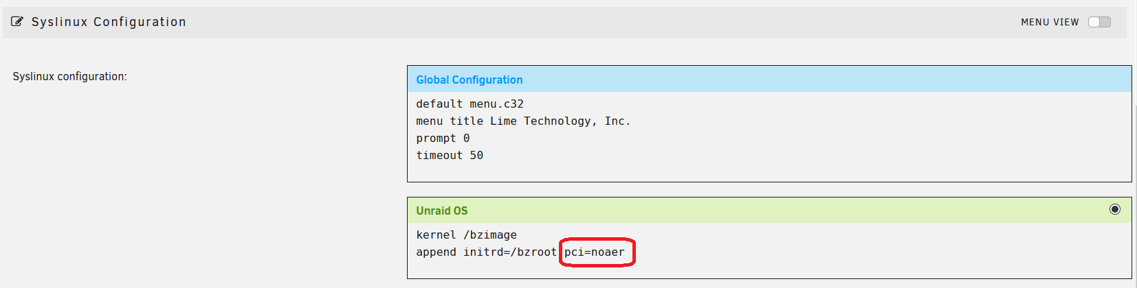

Please check if you have anything appended to your syslinux.cfg ('Main' -> click on the blue text 'Flash'):
like in my case like3 'pci=noaer'.
Remove it if you have appended 'xen-pciback.hide=YOURMETHODE' click on 'Apply' and reboot.
