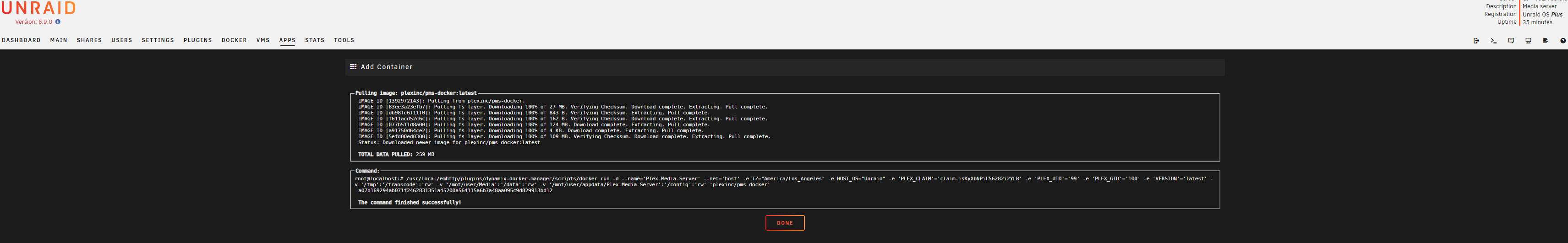

Post your docker run command as explained at the very first link in the Docker FAQ.

1. I am using Plex-Media-Server docker, and plex linuxserver's repository for the HW. But early in the troubleshooting process I changed some settings in both dockers that probably made things worse 😩

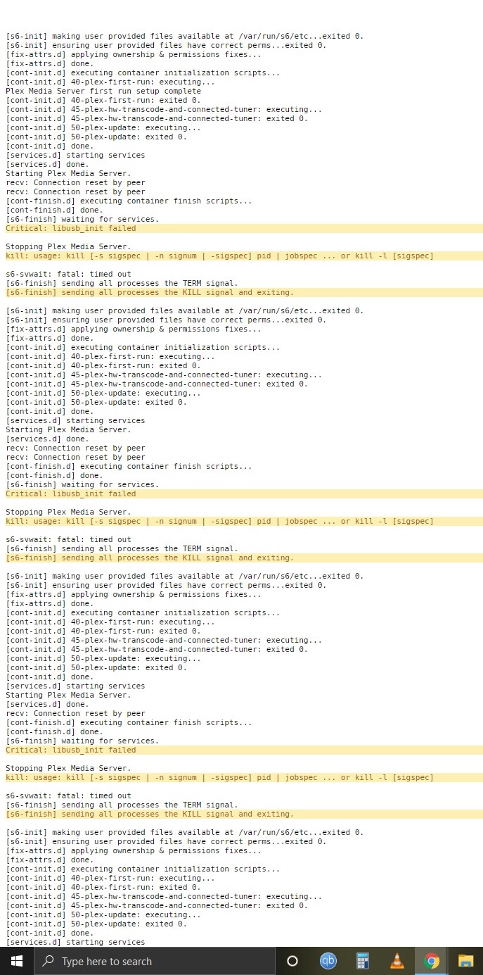

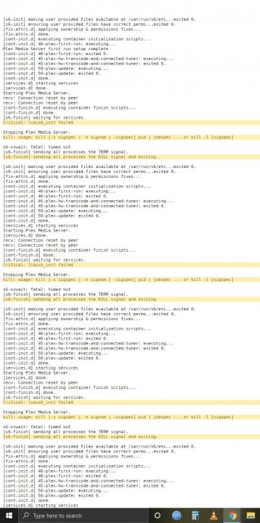

2. When I try to connect to Plex with WebUI plex states plex says "This application is at #### and is not hosted by Plex." Plex gives me the option to sign in, but when I do, plex can't connect to me. I have not changed any ports or anything.

According to your docker run command you are using the "official" plex docker and not linuxserver plex.
That plex docker is supported on the plex forum.
google this:
plex critical libusb_init failed
