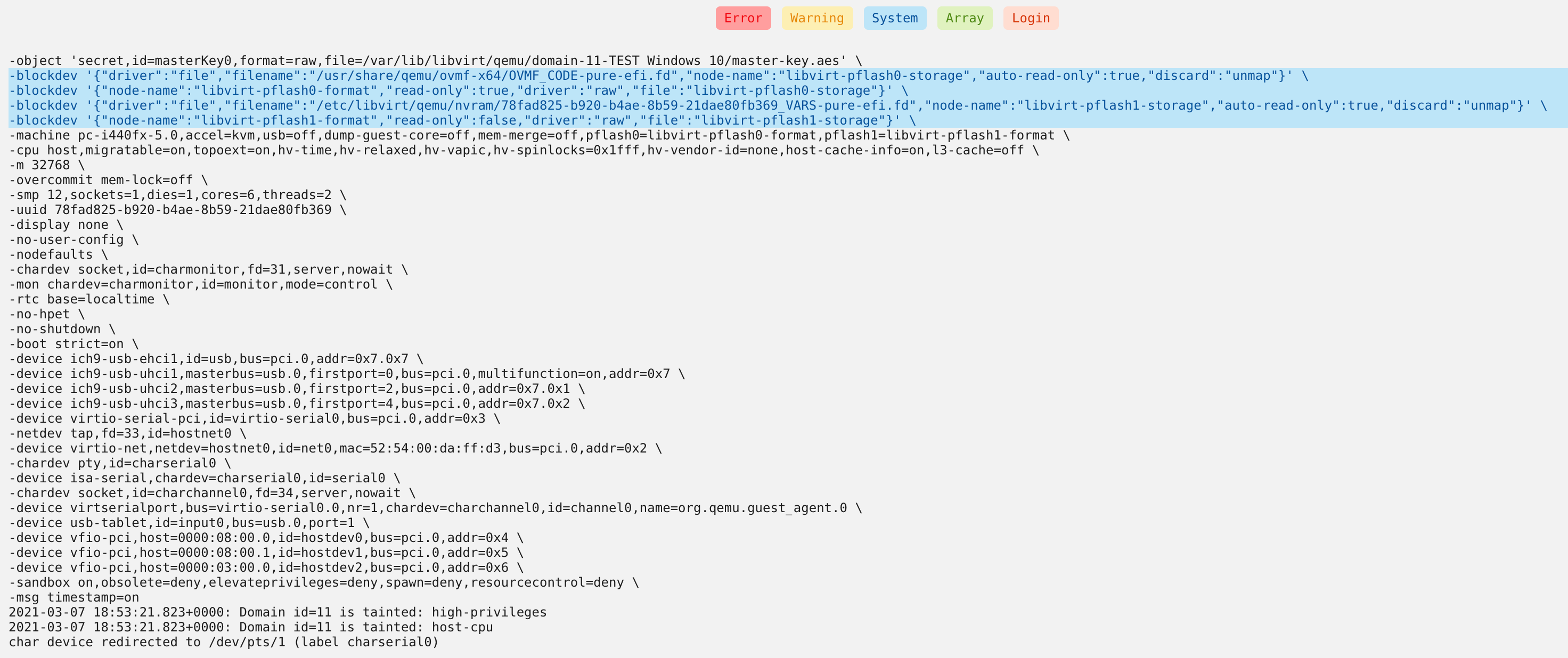

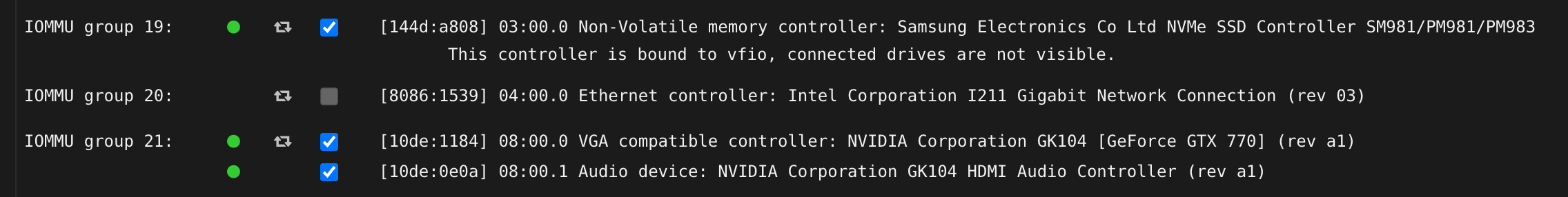

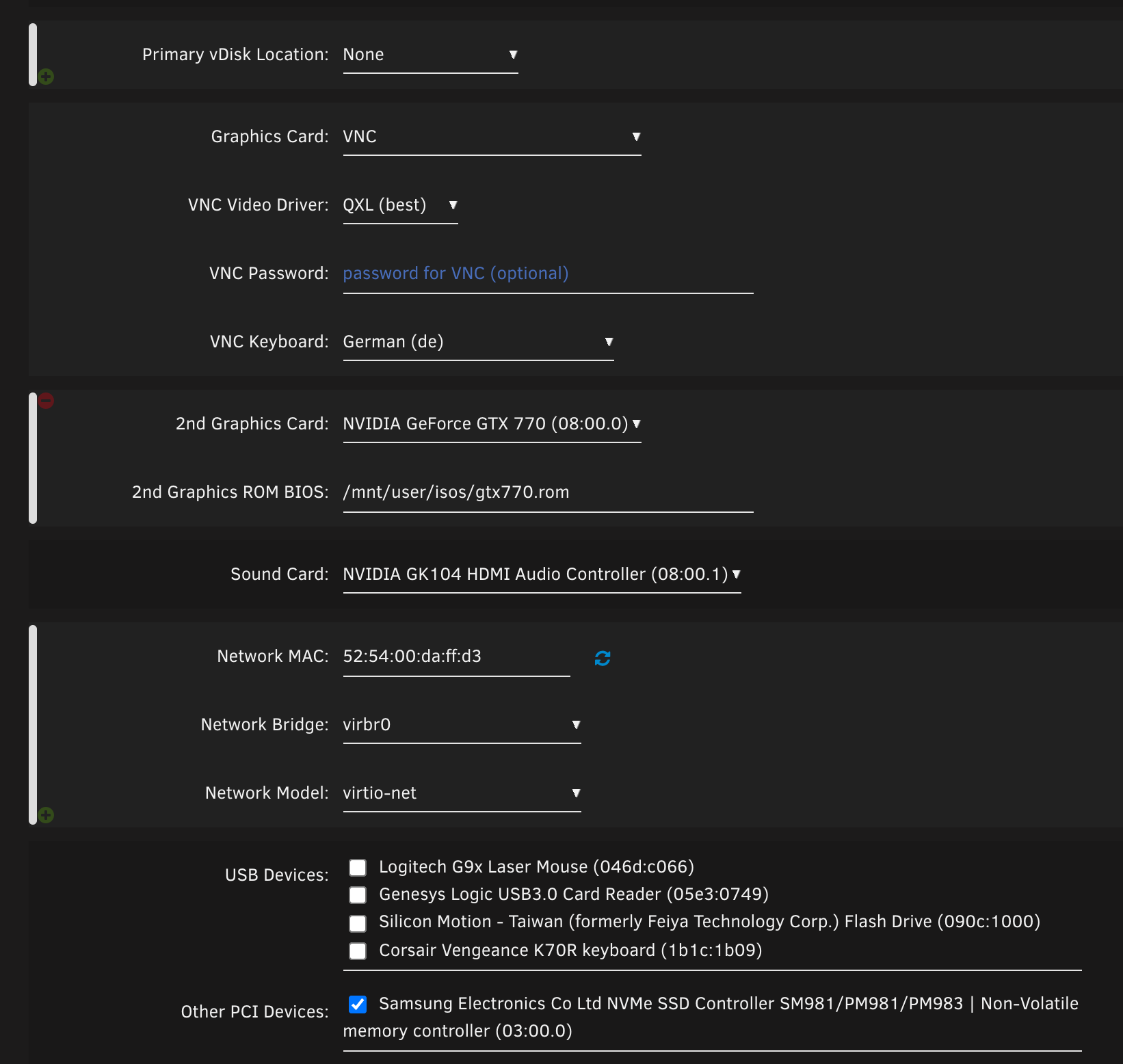

I am currently trying to get GPU passthrough running. I have successfully installed Win10 on a passed through NVME, so passthrough itself works. Now I've tried to switch from VNC to my single GPU (a GTX 770) but I can't get a picture to show up. When booting up with both VNC and the 770 as graphics adapters I can see that the graphics card is beeing detected in the device manager though.
Here is some additional system info:
Not sure what else you need, just give me a hint and I'll try to deliver :D
What I've tried so far:
- made a vbiod dump and added it to the vm: no change
- booted VM with both VNC and GPU and installed Nvidia drivers: no change, even after removing VNC
- changed unraid server boot mode to UEFI, starting the VM crashed my whole server, VMs were then disabled in VM Manager
I already made a dump of my vbios and added that, nothing changed. I also booted up with VNC and GPU and installed the NVidia drivers, no change - but didn't expect that to change something since I can't even see the bootup screen. Pretty sure it's not related to the Win10 install...
