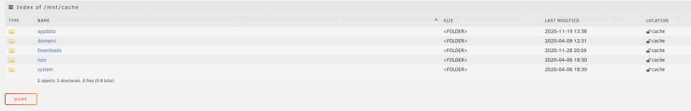

When i look in the cache it still shows folders in there:
