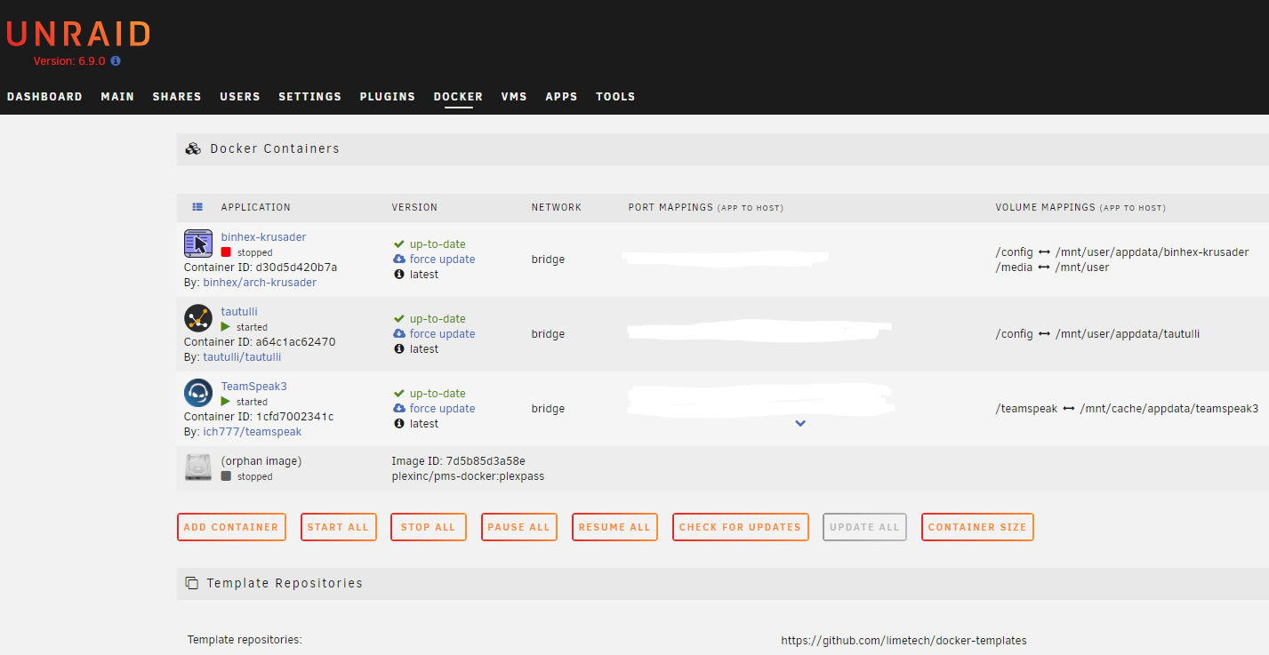

i just updated my Unraid server to Version 6.9.0 2021-02-27 (vs -rc2) and now my Plex docker won't start.
The Plex docker logo is gone and the docker i called "(orphan image)" "Image ID: 7d5b85d3a58e" now.
I am not able to do anything on the docker, no settings are visible.
Under "Settings", and "Docker", i have this:
Docker vDisk location: /mnt/user/system/docker/docker.img
Default appdata storage location: /mnt/user/appdata/
I see this error if i try to re-intall from the old template:
docker: Error response from daemon: Unknown runtime specified nvidia.
My other dockers work just fine.
Please help :(

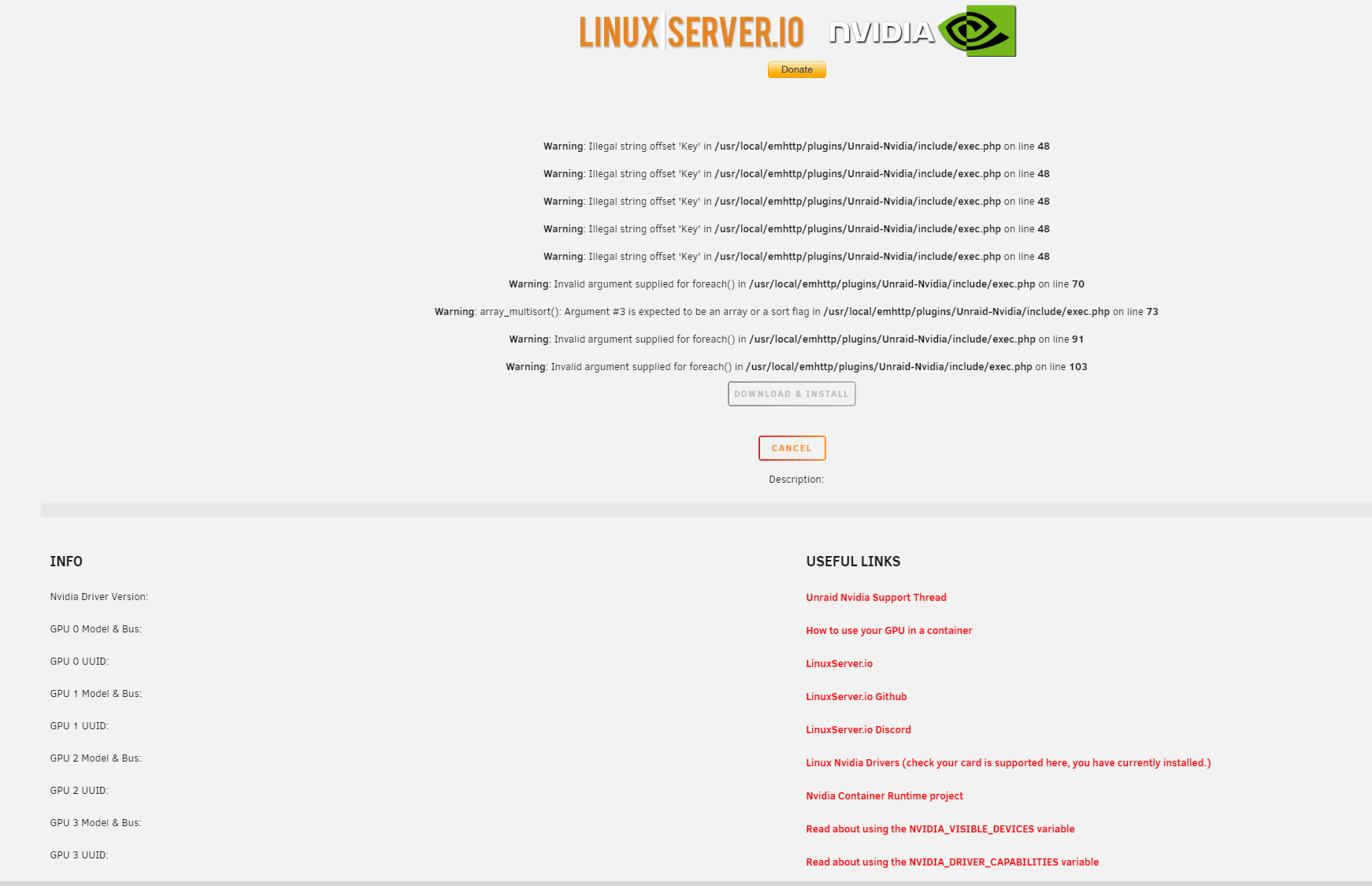

Okay problem solved....
I removed the old "Unraid Nvidia" plugin from "LinuxServer.io" and then i followed this guide
 to install the "Nvidia Driver" plugin from "ich777".
Finally i re-installed my Plex docker from the saved template.
