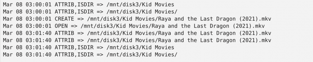

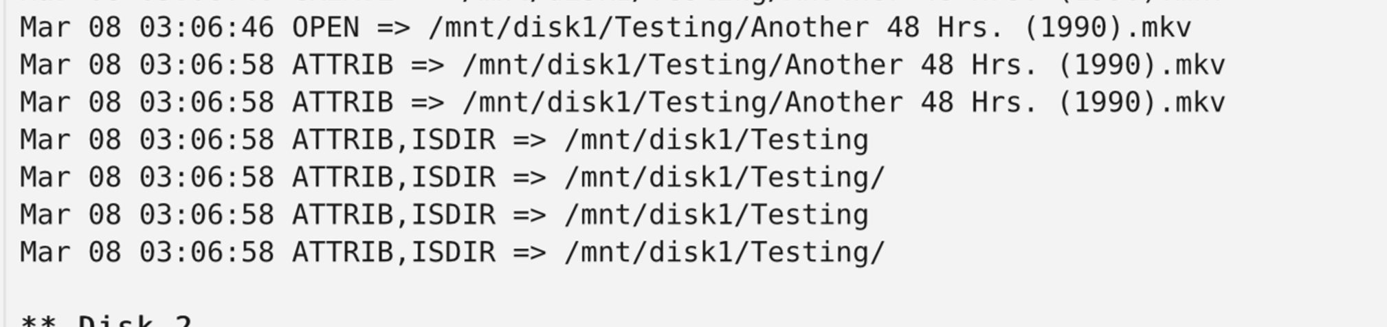

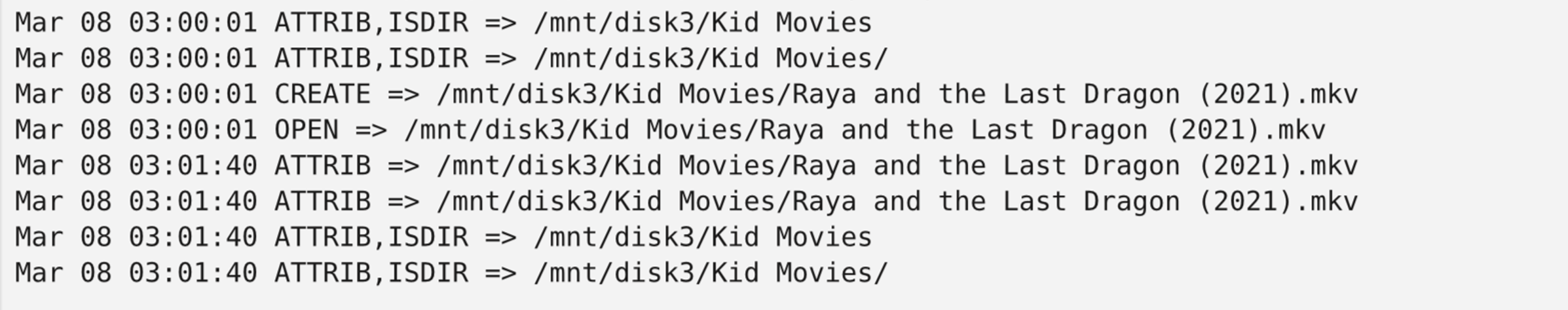

Hello, I'm monitoring Files Activity and I keep seeing OPEN and ATTRIB, ISDIR opening disks.  Could be plex, but 45 minutes after the scan, or whatever these are, the disks are still spun up.
Any help in looking at my diagnostics to tell me what is causing them not to be allowed to spin down?  I have disk settings to spin down in 15 minutes, except for CACHE.  I even set the 15 minutes at a few disk levels specifically to 15 minutes and no change.
[SOLVED] - new update to 6.9.1 fixed this issue.
