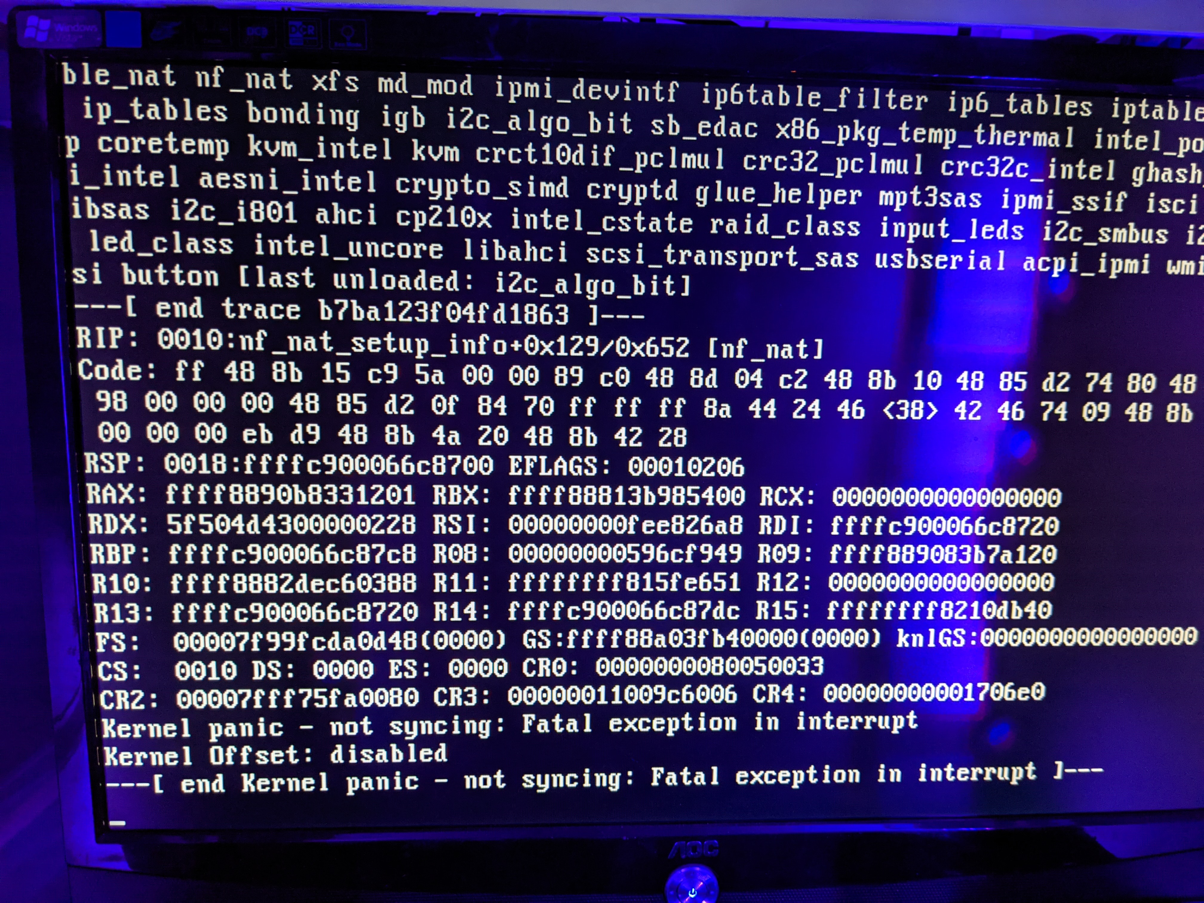

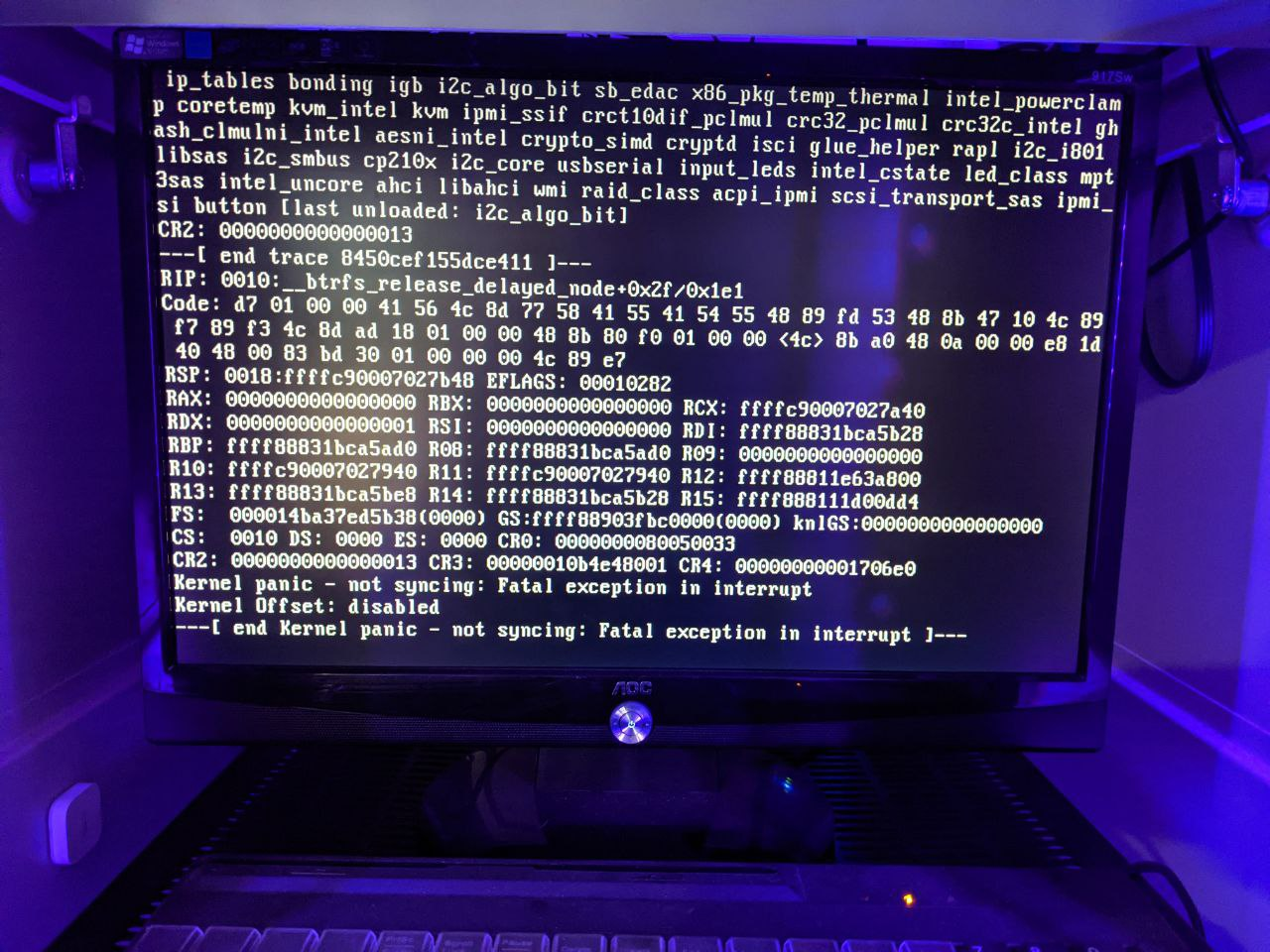

Here's attached diags and an image of what was on the screen.
I do see it says something about "btrfs release delayed node" - Is that related to the panic?

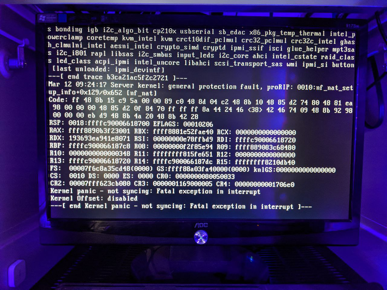

The "rip code" listed here is different than the last screenshot, not sure if that's anything to go off of.
First panic rip code referenced nf_nat, second mentioned btrfs, now we are back to nf_nat again.
Help is greatly appreciated here.

Mar 12 03:57:07 Server kernel: CS:  0010 DS: 0000 ES: 0000 CR0: 0000000080050033
Mar 12 03:57:07 Server kernel: CR2: 000000c000b040b8 CR3: 000000000200c005 CR4: 00000000001706e0
Mar 12 03:57:07 Server kernel: Call Trace:
Mar 12 03:57:07 Server kernel: <IRQ>
Mar 12 03:57:07 Server kernel: ? activate_task+0x9/0x12
Mar 12 03:57:07 Server kernel: ? resched_curr+0x3f/0x4c
Mar 12 03:57:07 Server kernel: ? ipt_do_table+0x49b/0x5c0 [ip_tables]
Mar 12 03:57:07 Server kernel: ? try_to_wake_up+0x1b0/0x1e5
Mar 12 03:57:07 Server kernel: nf_nat_alloc_null_binding+0x71/0x88 [nf_nat]
Mar 12 03:57:07 Server kernel: nf_nat_inet_fn+0x91/0x182 [nf_nat]
Mar 12 03:57:07 Server kernel: nf_hook_slow+0x39/0x8e
Mar 12 03:57:07 Server kernel: nf_hook.constprop.0+0xb1/0xd8
Mar 12 03:57:07 Server kernel: ? ip_protocol_deliver_rcu+0xfe/0xfe
Mar 12 03:57:07 Server kernel: ip_local_deliver+0x49/0x75
Mar 12 03:57:07 Server kernel: ip_sabotage_in+0x43/0x4d
Mar 12 03:57:07 Server kernel: ? l3mdev_l3_rcv.constprop.0+0x50/0x50
Mar 12 03:57:07 Server kernel: ip_rcv+0x41/0x61
Mar 12 03:57:07 Server kernel: __netif_receive_skb_one_core+0x74/0x95
Mar 12 03:57:07 Server kernel: process_backlog+0xa3/0x13b
Mar 12 03:57:07 Server kernel: net_rx_action+0xf4/0x29d
Mar 12 03:57:07 Server kernel: __do_softirq+0xc4/0x1c2
Mar 12 03:57:07 Server kernel: asm_call_irq_on_stack+0x12/0x20
Mar 12 03:57:07 Server kernel: </IRQ>
Mar 12 03:57:07 Server kernel: do_softirq_own_stack+0x2c/0x39
Mar 12 03:57:07 Server kernel: do_softirq+0x3a/0x44
Mar 12 03:57:07 Server kernel: netif_rx_ni+0x1c/0x22
Mar 12 03:57:07 Server kernel: macvlan_broadcast+0x10e/0x13c [macvlan]
Mar 12 03:57:07 Server kernel: macvlan_process_broadcast+0xf8/0x143 [macvlan]
Mar 12 03:57:07 Server kernel: process_one_work+0x13c/0x1d5
Mar 12 03:57:07 Server kernel: worker_thread+0x18b/0x22f
Mar 12 03:57:07 Server kernel: ? process_scheduled_works+0x27/0x27
Mar 12 03:57:07 Server kernel: kthread+0xe5/0xea
Mar 12 03:57:07 Server kernel: ? __kthread_bind_mask+0x57/0x57
Mar 12 03:57:07 Server kernel: ret_from_fork+0x22/0x30
Mar 12 03:57:07 Server kernel: ---[ end trace b3ca21ac5f2c2720 ]---
1 hour ago, JorgeB said:
Macvlan call traces are usually the result of having dockers with a custom IP address, more info below.
https://forums.unraid.net/topic/70529-650-call-traces-when-assigning-ip-address-to-docker-containers/
Thanks, working on setting up VLAN now for the 2 containers on br0.
I also want to note, I tried downgrading to 6.8.3 but the cache pool just showed up as unassigned devices, so I'm back on 6.9.1 now otherwise my cache wasn't working.
That's normal, it's in the release notes, you need to re-assign it.
ah, sorry, I saw they didn't assign and just came back to 6.9.1
I've changed one docker to HOST network mode (Home Assistant Core) instead of its own IP, anda change Pi-Hole docker to be on  VLAN, so now nothing is using br0 as an option anymore, fingers crossed again.
Thanks again for the assistance.
