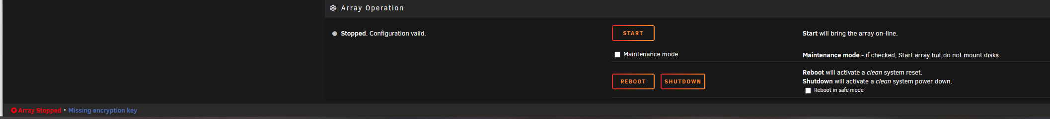

It won't let me start the array because it says the encryption key is missing.  The field that is usually in that spot to enter the encryption key isn't there.  What I captured in the sceenshot are the only options I have.
Updated screen capture to show error message about encryption key missingimage.thumb.png.e4124db819229e7c629a156b0a7f66dc.png

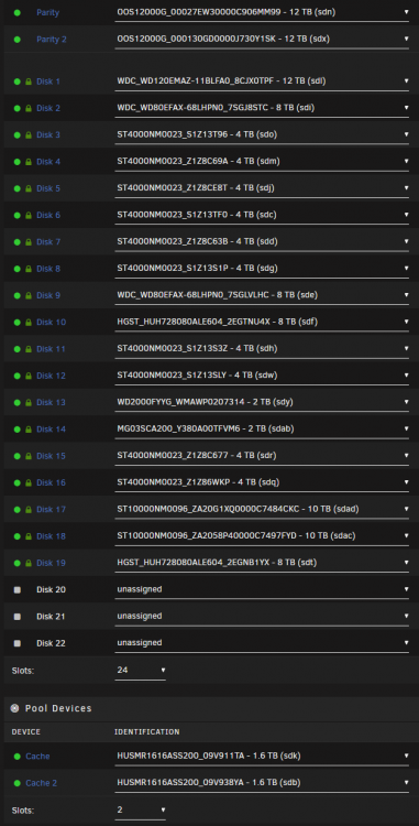

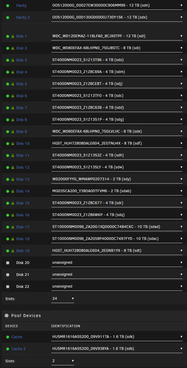

Have you tried clicking on individual disks on the Main tab to see what file system unRaid thinks they are set to?  Maybe it has lost track somehow of the fact that you have encrypted disks?
Yes, the disks all show encrypted.image.png.e972faeca86d834f44eb6e8190fa27e6.pngimage.png.0384dad0c367a2b1effecb05c04488d8.png

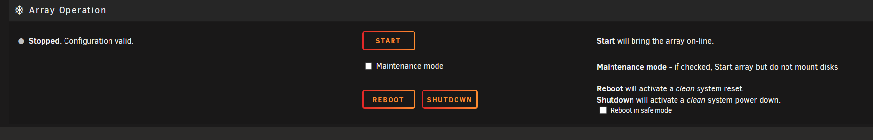

That's the strangest thing.  I disconnected one of the redundant SAS cables from the R720xd to the MD1200 and rebooted the system (I pulled diagnostics first just in case).  When it came back up, the normal menu option to enter the encryption key was present and it let me proceed.  That's super odd that everything was working fine with no issues in 6.8.3 but not in 6.9.0.  I can attach the diagnostics if you feel they would be useful.
