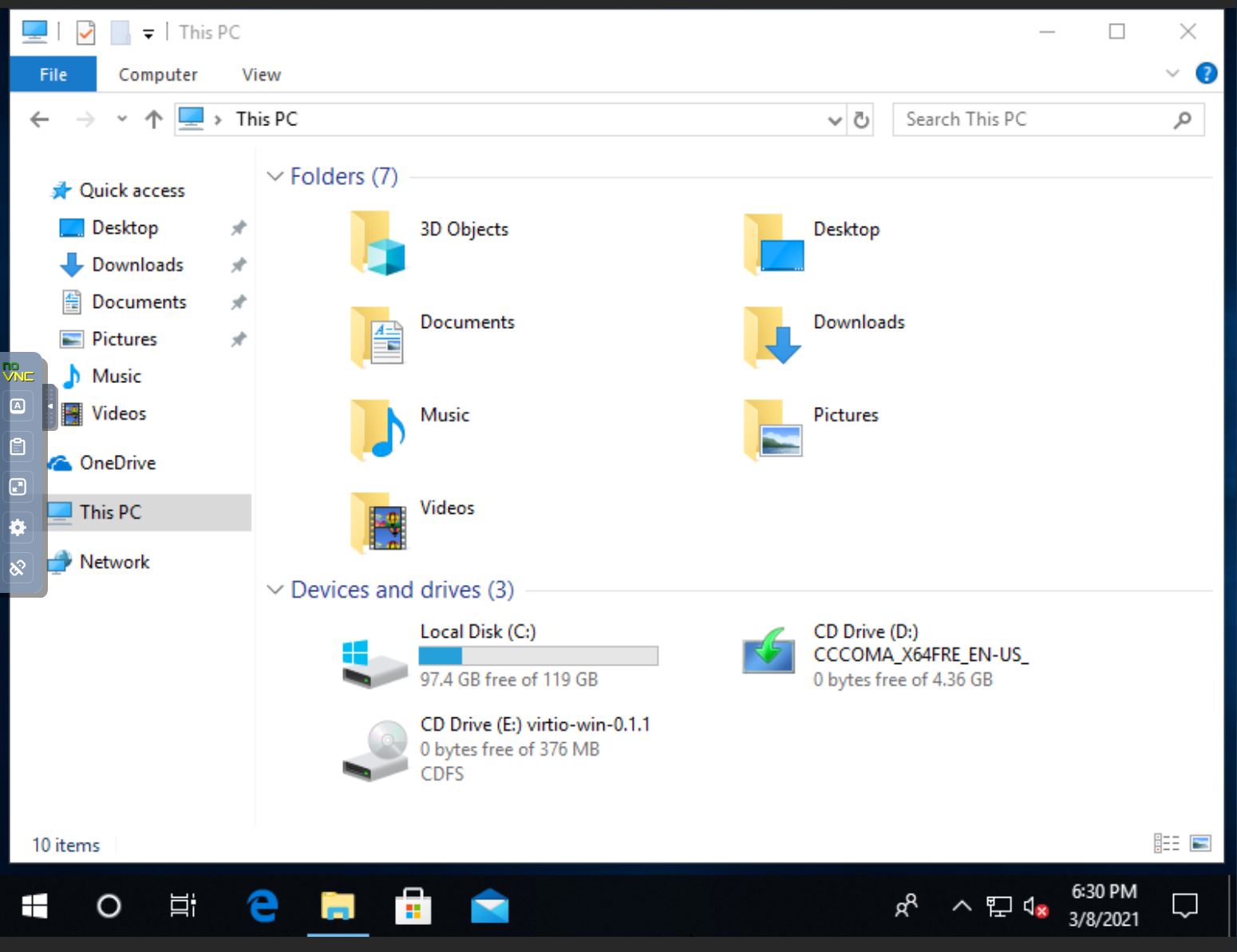

I setup my Win10 VM for the purpose of using 2 internal Optical Drives I have installed in my tower case.  I thought after installing all the missing drivers from the virtio-win-0.1.1 CD drive my 2 internal Optical Drives will appear in my "This PC" window under the "Devices and Drives" section.

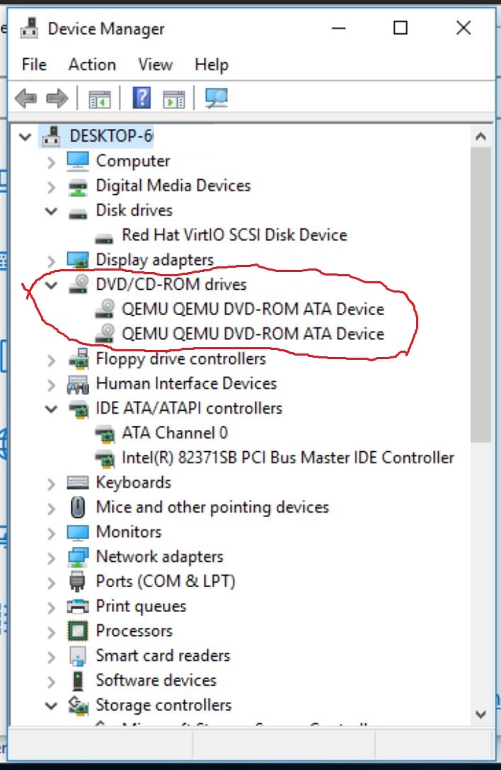

Nevertheless, as the JPG below shows my 2 internal Optical Drives are missing. I have checked the "DVD/CD-ROM drives" node on my Device Manager tree and those drivers shown below circled in RED do not look like they belong to my 2 ASUS BW-16D1HT 16x BLU-RAY Optical Drives.
I will greatly appreciate it if anybody in the community can clarify for me why my 2 optical drives seem to be invisible to my Win10 VM?  Is the correct approach to fix this problem require I import genuine ASUS Optical Drive drivers into my Win10 VM and install them since they seem to be missing from the virtio-win-0.1.1 CD drive?   Any advice will be greatly appreciated.

Those two devices will be the install iso and the virt driver cd you added into the template.
You will need to passthru the device to use in windows but not sure if it is possible.
Rom drives are normally called /dev/sr0 etc you can do if usb attached.
It may be easier to add a cheap 2 port pcie sata controller and pass through the whole controller if the motherboard supports it.
