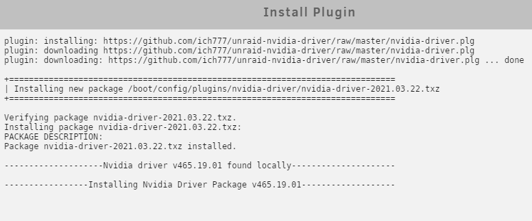

I do seem to be stuck though Ich, as it's been sitting on the below for like 30 mins now?
plugin: installing: https://github.com/ich777/unraid-nvidia-driver/raw/master/nvidia-driver.plg
plugin: downloading https://github.com/ich777/unraid-nvidia-driver/raw/master/nvidia-driver.plg
plugin: downloading: https://github.com/ich777/unraid-nvidia-driver/raw/master/nvidia-driver.plg ... done
plugin: downloading: https://github.com/ich777/unraid-nvidia-driver/raw/master/packages/nvidia-driver-2021.03.09.txz ... done
| Installing new package /boot/config/plugins/nvidia-driver/nvidia-driver-2021.03.09.txz
Verifying package nvidia-driver-2021.03.09.txz.
Installing package nvidia-driver-2021.03.09.txz:
PACKAGE DESCRIPTION:
Package nvidia-driver-2021.03.09.txz installed.
| WARNING - WARNING - WARNING - WARNING - WARNING - WARNING - WARNING - WARNING
| Don't close this window with the red 'X' in the top right corner until the 'DONE' button is displayed!
Please close the window with the red X, see if it installed anything to your server and remove the Plugin if it installed it.
After that reboot the server and try to install the Plugin again.
Are you sure that your Server has exclusive access to the internet and can connect to Github?
So I can't see it on plugins, but it's on the settings page. How would you suggest removing it? (sorry if it's obvious... I haven't tried removing things yet!)
Should do, there's no vpn etc bar one on deluge.
Sent you a PM.
Anyways try to restart the server and see if it actually uninstalls.

Having a similar issue. Every time i try to install the plugin it just sits there and never completes.
Then your connection to Github I think is very slow.
Can you try to download this file and see which download speeds you get: Click
EDIT: Also please post the question in the appropriate support thread:
