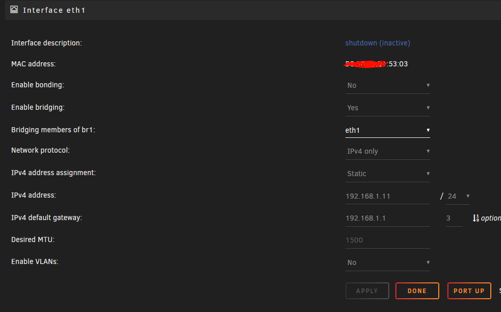

Here is my second NIC (eth1) which I have taken down in unRAID by clicking on the Port Down button.  FYI - if the Port Down button is active, the NIC is actually active and recognized by unRAID.  If the Port Up button is active (as seen below), it means the card has been deactivated and can be brought up again in unRAID by clicking the button.
O right thank you, I was only concerned because it was saying in the status bar that the NIC was not active and plug in a cable even though it was in. I do have the Port Down button so I will assume then it is working
