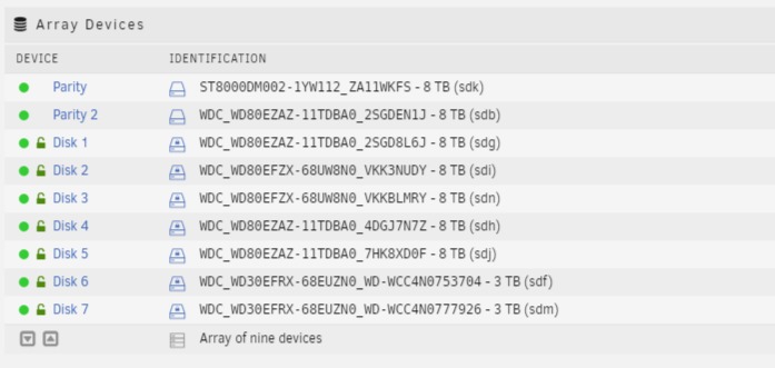

I have a very loud seagate desktop drive in the array. This is so loud that it causes the whole system to vibrate and also makes a humming noise when idle that i can hear in the next room. It is also the parity drive unfortunately.
Anyhoo, I have a drive within the array that I would like to replace it with. It is a WD red and will do the trick.
If you see my configuration, I want to replace Parity Drive with Disk 3. Image attached.
I have seen instructions on how to do this on the wiki here:  https://wiki.unraid.net/Shrink_array
I am going to be using the first method. As I have 2 parity drives, I don't think I want to risk doing method 2.

  • I have used unbalance to move the data to other disks on the array, so that part is done.
  • I have checked the shares settings and ensured that Disk 3 is not being used for anything else
  • Snapshot of array assignments captured and attached.
Now comes the tricky part that is not mentioned in the instructions. Stopping the array and doing a new config.
The instructions dont tell you what to do if I want to change the parity drive itself
It also fails to mention what to do when drive assignments if one of the disks are removed. Shouldn't the new configuration be configured in a way where each disk number changes as one of the drives is being removed? As I am removing Disk 3 from the array and making that into a parity disk:
Disk 4 should become Disk 3
Disk 5 should become Disk 4
Disk 6 should become Disk 5
Disk 7 should become Disk 6
Am I right or have I got this wrong?
Edited by alitech
Changing drive assignments after a New Config is exactly the same process for both data and parity drives.    You can change them to be different drives or leave the entry unassigned.
it is perfectly permissible to have gaps in the data drive assignments so whether you move them up because you prefer it that way or leave a gap is up to you.
the important point is to make sure that any drive assigned to a parity slot does not contain contents you want to keep as when you start the array to build new parity (based on the drive assignments at that point) any data on the parity drives would be lost as it is over-written with parity information.
