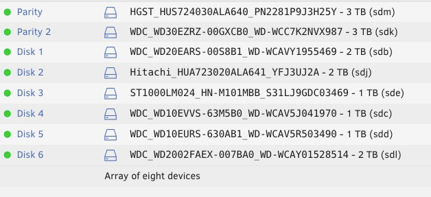

Wildly Varying Parity Check Speed. CPU, disks, controller don't appear to be bottlenecks....flaky disk?
I do one a week, and there's one going on right now due to a hard reset. Knock on wood, zero errors each time. 2 parity disks.
Xeon X3440 with 16GB RAM.
Disks are either on a 3Gbs onboard SATA slot (or Esata but same port) or a 6GBPS backplane with H310 in IT mode.

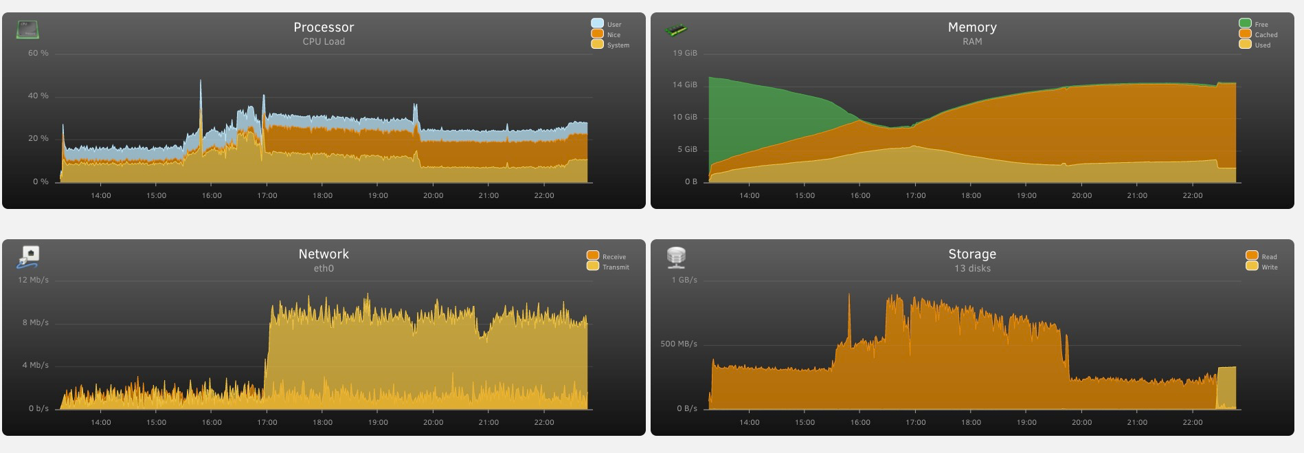

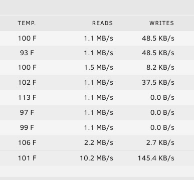

So, the only thing I can figure is one disk is slow, but they never bench this slow. SLOWEST disk I have starts around or above 75Mbps but as you can see, it's super low above.
Ideas?
And I think I've done extended SMART checks on most/all the disks and SMART data isn't indicating much. A CRC error here and there but that's about it.
Some of the read/writes in the graph are a preclear. New-to-me drives that passed extended SMART and now I'm just doing a preclear before I 'bother' since they appear to be used but good shape datacenter drives. (Ebay. Warrantied, and I've got two brands / models for dual parity.)
The preclear is in a DS4246 on it's own controller. T310 Dell and the controller is in IIRC an 8X slot, so I don't think that's it.

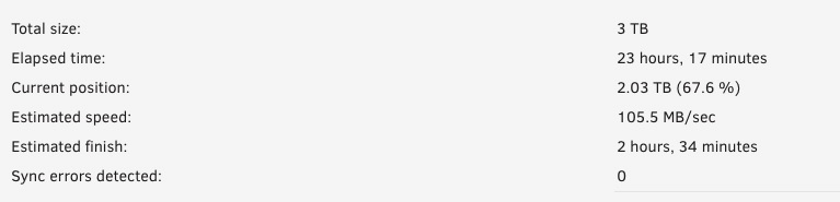

One thing I do see, it's not the 3TB drive I don't think because after 2TB it ramps up a LOT.
But it sucks at many points UP TO 2TB so I can't point the finger definitively at one of the other drives.
So the last 1TB is only going to take 2 hrs. Almost 24hrs to check 2TB is ridiculous.

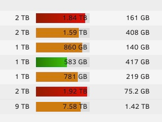

It doesn't seem like full drives would cause that much slowness during a read as nothing is being moved. Yes, I need to work on that with deletions/unBalance.
how full a drive is will have no effect on a parity check as the parity check works at the raw sector level and is unaware of the meaning of the contents of the sectors - just that they have a bit pattern it is going to use/check.
